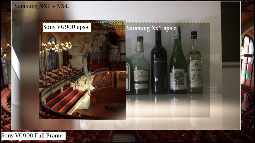

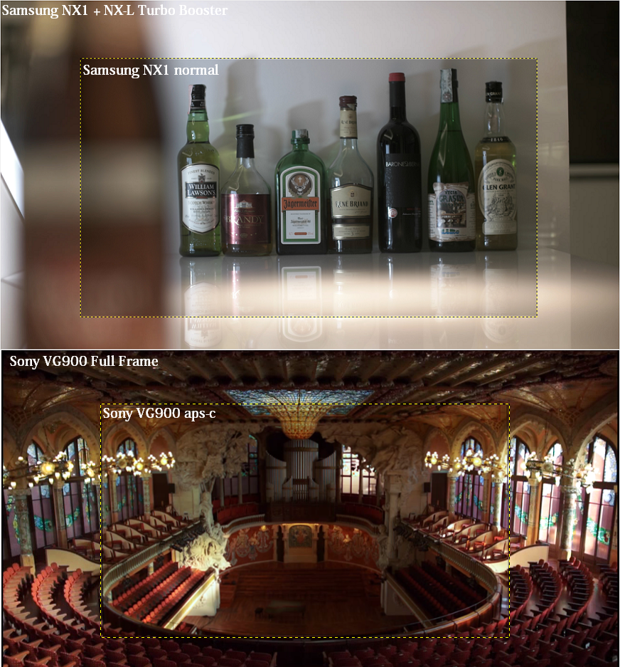

lucabutera Posted August 18, 2016 Author Share Posted August 18, 2016 On 12/8/2016 at 3:48 PM, Pavel Mašek said: Just try to google it http://petapixel.com/2013/01/14/metabones-announces-revolutionary-adaptor-makes-ff-lenses-faster-and-wider/ It is similar to your EF to NX adapter but there is optical element that change crop factor from x1.5 to (I believe) x1.1, and you got more light to sensor and shallower depth of field. There is no electronics to control aperture now. Communication between lens and body is different story/project... I confirm. Crop factor it's x 1.1 tokhee, SMGJohn, Pavel Mašek and 1 other 4 Link to comment Share on other sites More sharing options...

Pavel Mašek Posted August 19, 2016 Share Posted August 19, 2016 I can see (beside higher brightness and lower crop factor) also higher sharpness. Image with SB looks like done with different lens - so good is improvement.Very nice! BTW what lens and aperture have you used? Link to comment Share on other sites More sharing options...
lucabutera Posted August 19, 2016 Author Share Posted August 19, 2016 3 minutes ago, Pavel Mašek said: I can see (beside higher brightness and lower crop factor) also higher sharpness. Image with SB looks like done with different lens - so good is improvement.Very nice! BTW what lens and aperture have you used? Yes, I use: Canon 50mm FD 1.2 L with normal nx/fd adapter and Nikon Nikkor 50mm 1.4 AF with NX-L Turbo Boost adapter. I shot in manual mode, Iris F.2, Speed Shutter 50. Link to comment Share on other sites More sharing options...
Pavel Mašek Posted August 20, 2016 Share Posted August 20, 2016 17 hours ago, lucabutera said: Yes, I use: Canon 50mm FD 1.2 L with normal nx/fd adapter and Nikon Nikkor 50mm 1.4 AF with NX-L Turbo Boost adapter. I shot in manual mode, Iris F.2, Speed Shutter 50. Thank you. It would be nice to test it with same lens ;-) On bottles or even in outside in exterior. Marco Tecno and sandro 2 Link to comment Share on other sites More sharing options...

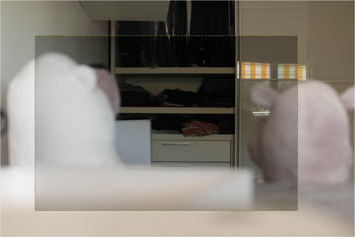

lucabutera Posted August 20, 2016 Author Share Posted August 20, 2016 8 hours ago, Pavel Mašek said: Thank you. It would be nice to test it with same lens ;-) On bottles or even in outside in exterior. Nikon 50mm f1.4, aperture f.2, iso 100, shutter speed 50. Original files. MKSN, Otto K, SMGJohn and 4 others 7 Link to comment Share on other sites More sharing options...
