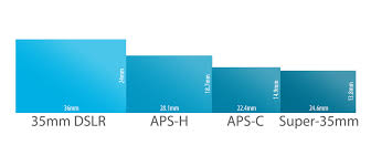

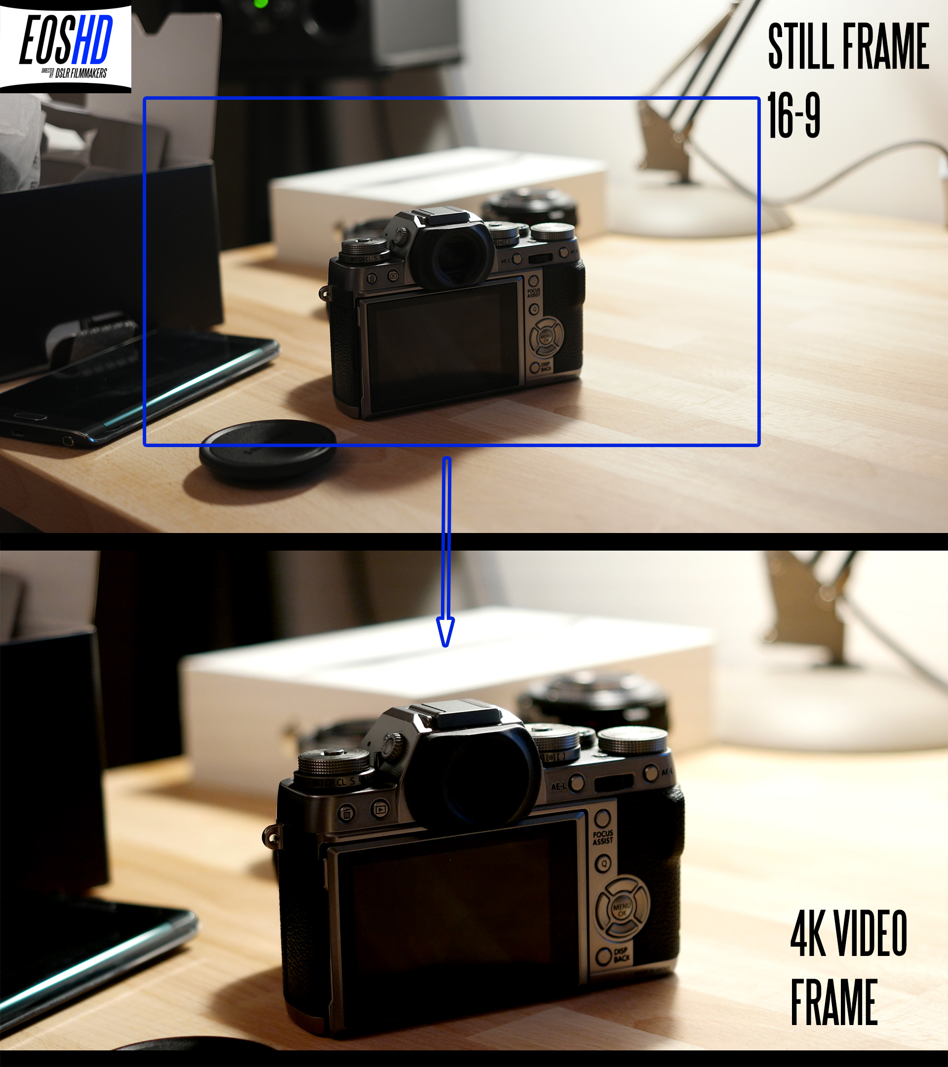

shanebrutal Posted August 4, 2016 Share Posted August 4, 2016 Awesome work Luca! Will it also work on the nx500? Should bring it closer to super 35 crop in 4k mode. vaga 1 Link to comment Share on other sites More sharing options...

lucabutera Posted August 4, 2016 Author Share Posted August 4, 2016 9 hours ago, shanebrutal said: Awesome work Luca! Will it also work on the nx500? Should bring it closer to super 35 crop in 4k mode. Thank's, yes! It will work on all samsung nx cameras, my tested it on nx1 and nx100. The crop is more to s35, it's same full frame 35mm dslr. 2 hours ago, Marco Tecno said: What about konica hexanon? They have some nice lenses, easy to find cheap. Sorry, konica is short mount. it's impossible. Link to comment Share on other sites More sharing options...

shanebrutal Posted August 4, 2016 Share Posted August 4, 2016 3 hours ago, lucabutera said: Thank's, yes! It will work on all samsung nx cameras, my tested it on nx1 and nx100. The crop is more to s35, it's same full frame 35mm dslr. The nx500 4k mode crop is more than the nx1. It's closer to super 16. I believe 2.5x? So it will be interesting to see how it performs with the speedbooster. Link to comment Share on other sites More sharing options...

lucabutera Posted August 4, 2016 Author Share Posted August 4, 2016 1 hour ago, shanebrutal said: The nx500 4k mode crop is more than the nx1. It's closer to super 16. I believe 2.5x? So it will be interesting to see how it performs with the speedbooster. The NX 500, in 4k have a cutout similar to m 4/3, with Speed Booster get a aps-c format. Like NX1! SMGJohn and shanebrutal 2 Link to comment Share on other sites More sharing options...
