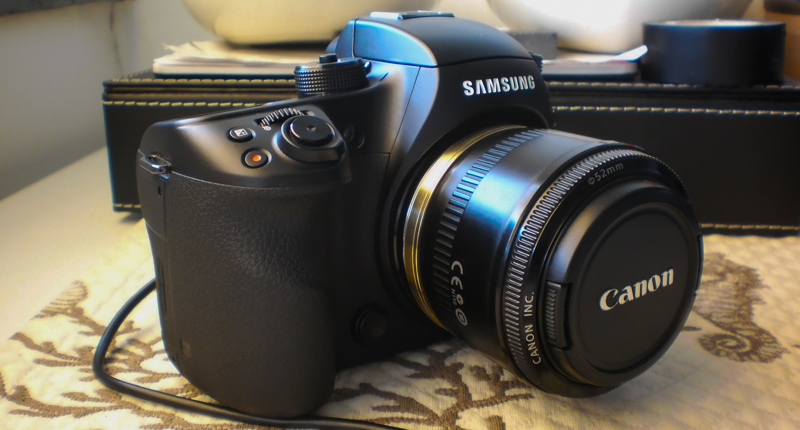

lucabutera Posted August 6, 2016 Author Share Posted August 6, 2016 Updates NXL NX / EF: Hi, I worked on this adapter for a few consecutive days, the biggest difficulty was finding the right point of distance between the lens and sensor. A tenth lower and slamming into the sensor, a tenth farther and slammed into the lens. Find the right setting to infinity focus it seemed impossible, and some moments I was throwing in the towel with canon EF mount to return to Nikon. All this for 0.05 of a millimeter (Canon EF mount is definitely the final flange focal distance limit). Now fortunately, the system works perfectly and soon will publish the first tests with Nx1 camera. See you soon. Pavel Mašek, Kisaha, Liam and 6 others 9 Link to comment Share on other sites More sharing options...

lucabutera Posted August 6, 2016 Author Share Posted August 6, 2016 I love the "Gold Ring" on Samsung NX1... It will be a very long wedding! Otto K, Liam, cisco150 and 6 others 9 Link to comment Share on other sites More sharing options...
