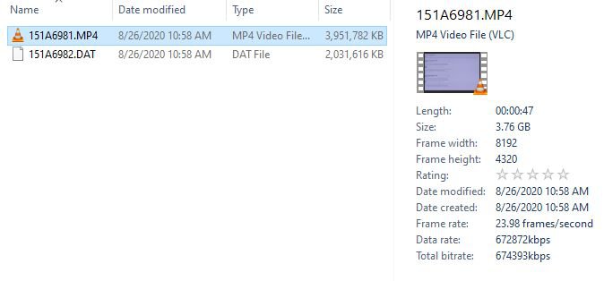

Electroholic Anonymous Posted August 26, 2020 Share Posted August 26, 2020 IT WORKS!!! This is with a Sony UHS-II card, R5 recording 8K 23.98p IPB in roughly 680Mbps. I will try some other modes next, but I trust this will work in any mode available on SD. Pity that RAW does not work with this neatest of tricks. You guys are geniuses! Â andrgl, foliovision, horshack and 1 other 4 Link to comment Share on other sites More sharing options...

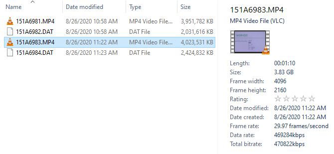

Electroholic Anonymous Posted August 26, 2020 Share Posted August 26, 2020 4K 30p FINE All-I works too: Â I will now try to create a FAT 32 partition on the CFexoress with similar specifications as on the working SD card. Fingers crossed! horshack, Katrikura and foliovision 3 Link to comment Share on other sites More sharing options...

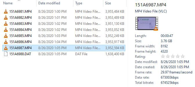

Electroholic Anonymous Posted August 26, 2020 Share Posted August 26, 2020 Still no luck on CFexpress... My 2 years old 256GB Adata UHS-II V90 275MB/s microSD (with adapter to UHS-II SD size, of course) also works brilliantly in 8K IPB 680Mbps! Below a successful attempt to record 6 minutes of 8K30p, that yielded 6 MP4 files of 47 seconds each and a yet unrecoverable DAT file of around 20 seconds. Thanks Jn and Horschack!!! foliovision 1 Link to comment Share on other sites More sharing options...

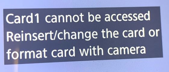

Electroholic Anonymous Posted August 26, 2020 Share Posted August 26, 2020 9 minutes ago, horshack said: Thanks! Did you verify that the thermal timer didn't reset after pulling the battery for this FAT32 case? Interesting how the CFE didn't work. Hoka Key on the dpreview forums wasn't able to get his 320GB CFE card recognized by his R5 either when formatted to FAT32. I wonder if Canon just disabled FAT32 support for CFE. Do you have a smaller CFE card to try by any chance? After a 6 minute run just now, it gives me 15 minutes again. As I am writing this the R5 is recording a 15 minute run. Will report back in 15 minutes 😉 No, I have two 1TB Integral Ultima CFE cards, and one Sandisk 512GB card. The Integrals run colder by the way. None of those 3 gave me an error or other disappointing behaviour, ever, for over a month now with the R5, a month full of abuse and power interruptions, hats off to those cards, the R5, and you and the others coming up with the FAT32 idea. Thanks a lot! horshack, andrgl, Juank and 1 other 4 Link to comment Share on other sites More sharing options...
