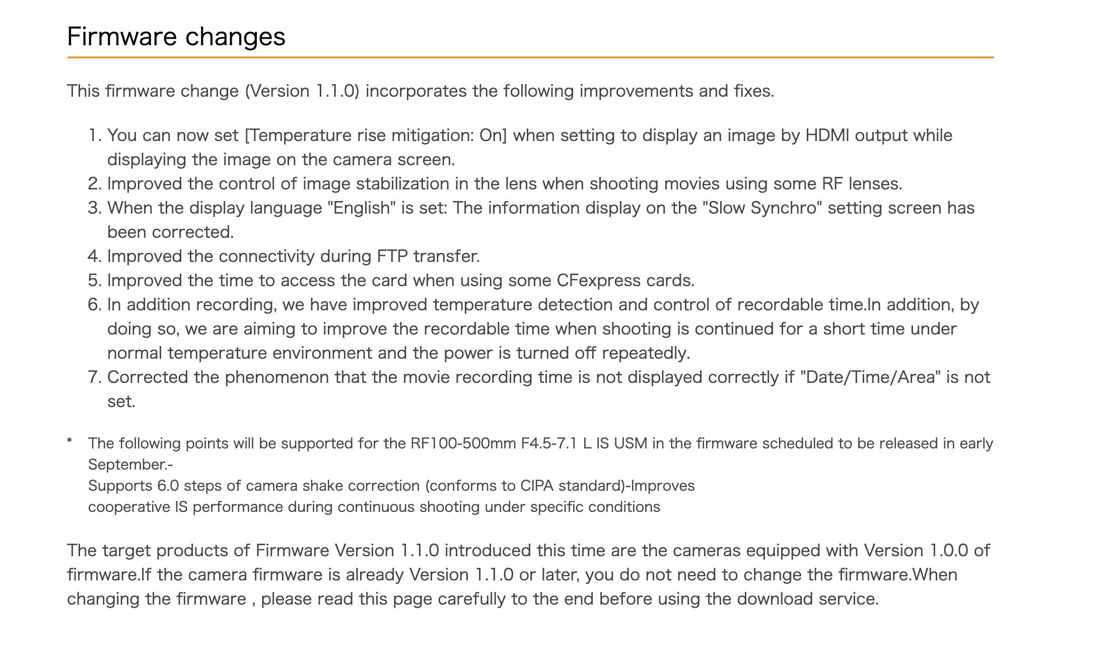

ajay Posted August 27, 2020 Share Posted August 27, 2020 According to TechRadar, the firmware doesn't address the overheating and actually engages it when using an external monitor: "Canon has today released the EOS R5’s first firmware update and it’s available to download from the camera maker’s regional websites around the world. However, if you were expecting the firmware to improve on the current video limitations the R5 suffers from (as previous reports indicated it would), you’re going to be sorely disappointed. The EOS R5 firmware version 1.1.0 only brings a couple of minor upgrades – it improves image stabilization for video recording, while also improving the combined stability of the camera’s in-body image stabilization system when paired with a stabilized lens, specifically the RF 100-500mm f/4.5-7.1 L IS USM telezoom. According to Canon, the update also ensures that the overheat control on the EOS R5 doesn’t get disabled when using an external monitor or recorder. It will also improve the accuracy of the video time display when recording several short clips back to back. None of these are quite what we were expecting but Canon has said there’s more to come." horshack, Emanuel, andrgl and 1 other 2 1 1 Link to comment Share on other sites More sharing options...
Video Hummus Posted August 27, 2020 Share Posted August 27, 2020 3 minutes ago, ajay said: According to TechRadar, the firmware doesn't address the overheating and actually engages it when using an external monitor: "Canon has today released the EOS R5’s first firmware update and it’s available to download from the camera maker’s regional websites around the world. However, if you were expecting the firmware to improve on the current video limitations the R5 suffers from (as previous reports indicated it would), you’re going to be sorely disappointed. The EOS R5 firmware version 1.1.0 only brings a couple of minor upgrades – it improves image stabilization for video recording, while also improving the combined stability of the camera’s in-body image stabilization system when paired with a stabilized lens, specifically the RF 100-500mm f/4.5-7.1 L IS USM telezoom. According to Canon, the update also ensures that the overheat control on the EOS R5 doesn’t get disabled when using an external monitor or recorder. It will also improve the accuracy of the video time display when recording several short clips back to back. None of these are quite what we were expecting but Canon has said there’s more to come." The pants shitting continues. Emanuel 1 Link to comment Share on other sites More sharing options...

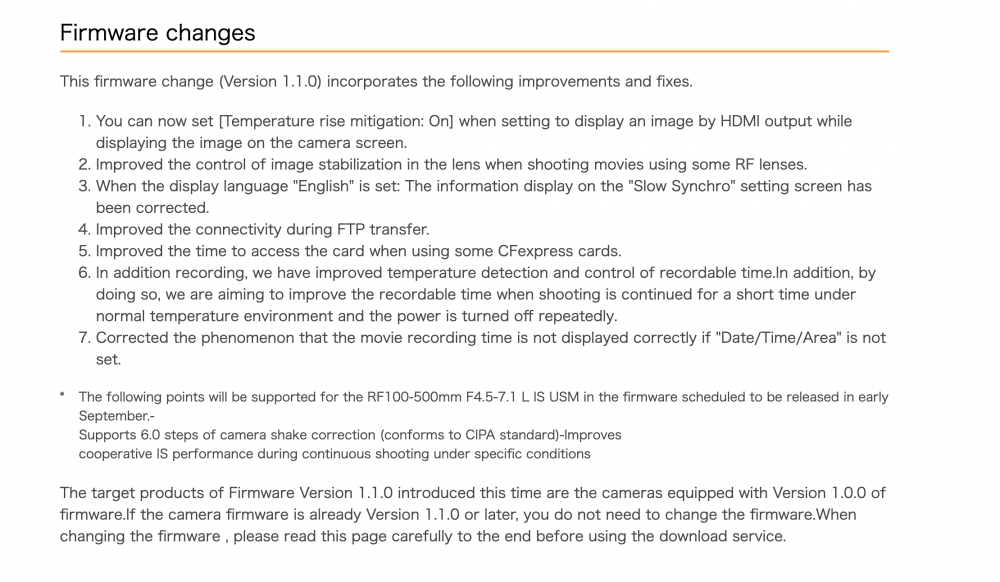

mechanicalEYE Posted August 27, 2020 Share Posted August 27, 2020 https://translate.googleusercontent.com/translate_c?depth=1&pto=aue&rurl=translate.google.com&sl=auto&sp=nmt4&tl=en&u=https://cweb.canon.jp/drv-upd/eosd/eosr5-firm.html&usg=ALkJrhhjgCoNGbTHOjJ5KBPzgPnWPWwAbg Emanuel 1 Link to comment Share on other sites More sharing options...
Emanuel Posted August 27, 2020 Share Posted August 27, 2020 Seems not a single word on topic... or I am lost over here? I am not as smart as @BTM_Pix ; ) so please can anyone explain what does this shit exactly mean? Thank you! I only wanna know if I will buy this thing or not... Firmware fix or mod/hack, anything serves if it fits the bill and does the job just fine, I am not so much picky :- D mechanicalEYE 1 Link to comment Share on other sites More sharing options...
mechanicalEYE Posted August 27, 2020 Share Posted August 27, 2020 Â ntblowz, Emanuel and PaulUsher 3 Link to comment Share on other sites More sharing options...

horshack Posted August 27, 2020 Share Posted August 27, 2020 34 minutes ago, ajay said: According to TechRadar, the firmware doesn't address the overheating and actually engages it when using an external monitor: "Canon has today released the EOS R5’s first firmware update and it’s available to download from the camera maker’s regional websites around the world. However, if you were expecting the firmware to improve on the current video limitations the R5 suffers from (as previous reports indicated it would), you’re going to be sorely disappointed. The EOS R5 firmware version 1.1.0 only brings a couple of minor upgrades – it improves image stabilization for video recording, while also improving the combined stability of the camera’s in-body image stabilization system when paired with a stabilized lens, specifically the RF 100-500mm f/4.5-7.1 L IS USM telezoom. According to Canon, the update also ensures that the overheat control on the EOS R5 doesn’t get disabled when using an external monitor or recorder. It will also improve the accuracy of the video time display when recording several short clips back to back. None of these are quite what we were expecting but Canon has said there’s more to come." Some said the HDMI w/o card long-recording workaround was a bug. I didn't believe it. Looks like they were right. Shaking my head. This also implies the thermal management isn't to protect the cards, otherwise why would they still throttle the camera without cards installed (assuming this update throttles both with and without cards). Emanuel 1 Link to comment Share on other sites More sharing options...
ajay Posted August 27, 2020 Share Posted August 27, 2020 So based on Gordon's tests, the new firmware takes into account external temperatures and recovers quicker when cooling is applied. I guess we're back on for the Tilta Cooling Kit. 😀 The good news is that now the firmware can be downloaded and hopefully Alex and others @ ML can start working on additional firmware to add functions to the crippled R5. Emanuel 1 Link to comment Share on other sites More sharing options...

ntblowz Posted August 27, 2020 Share Posted August 27, 2020 7 minutes ago, horshack said: Some said the HDMI w/o card long-recording workaround was a bug. I didn't believe it. Looks like they were right. Shaking my head. This also implies the thermal management isn't to protect the cards, otherwise why would they still throttle the camera without cards installed (assuming this update throttles both with and without cards). so no more 3-4hr 4KHQ external recording when using new firmware?!  Link to comment Share on other sites More sharing options...
