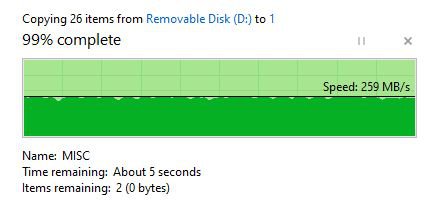

Electroholic Anonymous Posted August 26, 2020 Share Posted August 26, 2020 9 minutes ago, gt3rs said: Coping an almost full 512 Sandisk CFE USB-C reader to internal M2 SSD did go in trothing mode after around 400 GB.... 7 time slower.. was all Canon RAW video files I have not experienced this yet, but the Sandisk runs some 5 to 10 degrees Celsius hotter than my Integral 1TB CFEs. Again, both are fine, and the only throttling I have witnessed was the Sandisk during this infamous 8000+ photos in little less than an hour. It's bad luck for the Sandisk, it's only anecdotal. Integral was a bit of a risk for me, as I have no personal experience with that brand. Still I trust the Sandisk a bit more, that's personal, it's how strongly you prioritize personal experience I guess. Link to comment Share on other sites More sharing options...

gt3rs Posted August 26, 2020 Share Posted August 26, 2020 2 hours ago, Electroholic Anonymous said: I have not experienced this yet, but the Sandisk runs some 5 to 10 degrees Celsius hotter than my Integral 1TB CFEs. Again, both are fine, and the only throttling I have witnessed was the Sandisk during this infamous 8000+ photos in little less than an hour. It's bad luck for the Sandisk, it's only anecdotal. Integral was a bit of a risk for me, as I have no personal experience with that brand. Still I trust the Sandisk a bit more, that's personal, it's how strongly you prioritize personal experience I guess. If I remember correctly was around 700 MB/s and dropped to 120MB/s was in room at 34C.... card was really hot could not hold in hand for long time, but once you stop using it cools very quickly.... Link to comment Share on other sites More sharing options...
