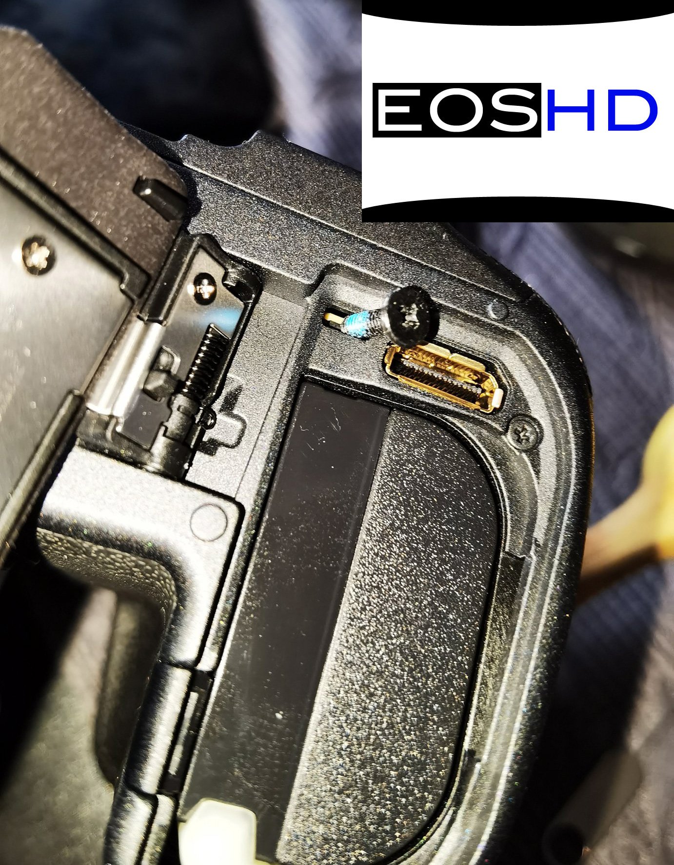

Administrators Andrew - EOSHD Posted August 23, 2020 Administrators Share Posted August 23, 2020 On Friday, I received a message from the lead developer at Magic Lantern. An interesting theory was being put forward by one of their open source contributors, which he believed could defeat the so-called overheat timer on the Canon EOS R5. Initially I was skeptical as to whether it would work! Mainly because the initial real-world tests on my own EOS R5 did not reset the timer. But then, a break-through. Magic Lantern just became Magic Screw! Read the full blog post here: https://www.eoshd.com/news/canon-eos-r5-so-called-overheat-timer-defeated-by-a-single-screw-in-battery-door/ austinchimp, zerocool22, Hanriverprod and 1 other 3 1 Link to comment Share on other sites More sharing options...

Super Members BTM_Pix Posted August 23, 2020 Super Members Share Posted August 23, 2020 2 hours ago, Andrew Reid said: Read the full blog post here: https://www.eoshd.com/news/canon-eos-r5-so-called-overheat-timer-defeated-by-a-single-screw-in-battery-door/ If you have two cards, it might be worth testing recording clips on the first one until you get close to the limit then inserting the second and doing the battery pull while its recording to that one. If it resets the clock if its shut down in a disorderly way while recording as has been observed then you'll only have lost that recording and not your real ones from the first card. Ifit turns out that this sacrficial recording on the second card only needs to be for 30 seconds or whatever then that might be a viable practical workaround. On a £4K camera. Andrew - EOSHD 1 Link to comment Share on other sites More sharing options...
horshack Posted August 23, 2020 Share Posted August 23, 2020 Andrew, the video that won't play-back in the camera after removing the battery (without stopping the recording first) is likely recoverable by reconstructing the missing tail data of the MP4 container. I've never had to do this myself but in checking online there are a few open-source solutions, some of which require a dummy "good file" taken anytime from the same camera that they then craft the tail data onto the truncated file. If that solution works then a shooter using the battery hack could just shoot an extra 10-20 seconds of unneeded outro footage that would be tossed from the battery pull. Link to comment Share on other sites More sharing options...

Administrators Andrew - EOSHD Posted August 23, 2020 Author Administrators Share Posted August 23, 2020 2 hours ago, horshack said: Andrew, the video that won't play-back in the camera after removing the battery (without stopping the recording first) is likely recoverable by reconstructing the missing tail data of the MP4 container. Yes that's true. Lot's to try next. I'll see what state the clip is in and see if I can still transcode it in EditReady. The 8K HEVC is a bitch to edit! So I'll be doing this anyway with 8K material to ProRes. The main goal for me is not so much the workable workaround but rather the truth gets out, and to force Canon's hand in removing any artificial limitations. Your contributions here have become invaluable, so thank you. Quote I've never had to do this myself but in checking online there are a few open-source solutions, some of which require a dummy "good file" taken anytime from the same camera that they then craft the tail data onto the truncated file. If that solution works then a shooter using the battery hack could just shoot an extra 10-20 seconds of unneeded outro footage that would be tossed from the battery pull. Yes this could indeed work but it'll be beyond the patience of most filmmakers I think. I'll try @BTM_Pix's suggestion first and see if there is a simple way to get around it and produce a usable last recording... 3 hours ago, BTM_Pix said: If you have two cards, it might be worth testing recording clips on the first one until you get close to the limit then inserting the second and doing the battery pull while its recording to that one. If it resets the clock if its shut down in a disorderly way while recording as has been observed then you'll only have lost that recording and not your real ones from the first card. Ifit turns out that this sacrficial recording on the second card only needs to be for 30 seconds or whatever then that might be a viable practical workaround. On a £4K camera. Link to comment Share on other sites More sharing options...

ajay Posted August 23, 2020 Share Posted August 23, 2020 Let's say you have 15 min to record. You record for 13 min. Then press record again and pull the battery (battery door sensor disengaged.) The last file is corrupted but that was just a dummy file. After reinserting the battery do you have a fresh 15 min. or does it remember the 13 min recording and you only have 2 min? Link to comment Share on other sites More sharing options...

Administrators Andrew - EOSHD Posted August 23, 2020 Author Administrators Share Posted August 23, 2020 Updated article with more clarifications. It is battery backed RAM not NVRAM EEPROM (that's why the Baidu internal battery pull worked) but the basic workings are the same https://www.eoshd.com/news/canon-eos-r5-so-called-overheat-timer-defeated-by-a-single-screw-in-battery-door/ A lot to get our heads around, so please if you are commenting on this topic, make sure to read the full article first. Link to comment Share on other sites More sharing options...
