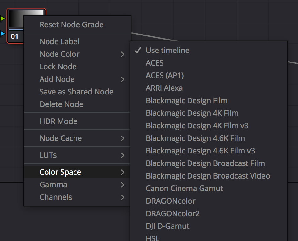

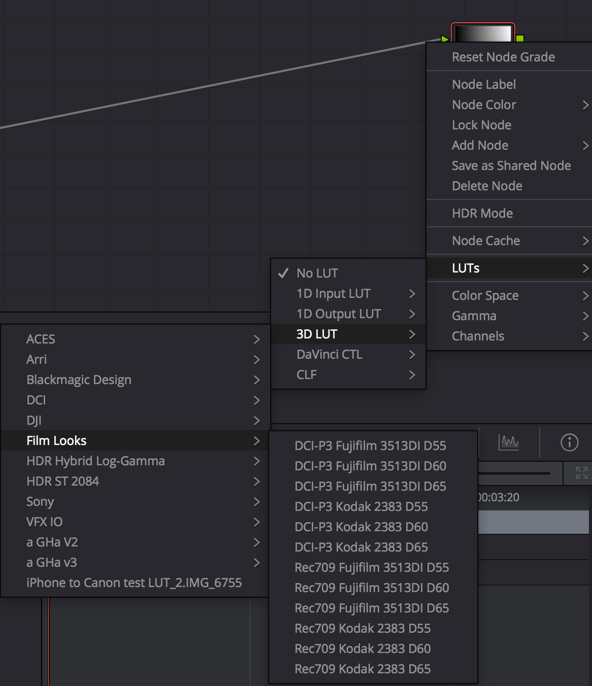

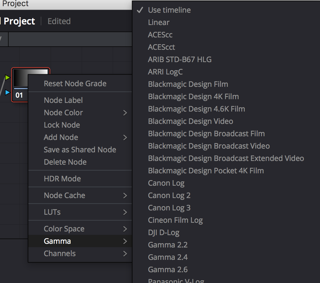

kye Posted February 19, 2019 Author Share Posted February 19, 2019 Why you should use the Colour Space Transform plugin instead of a LUT (even the built-in ones from BM)... mercer 1 Link to comment Share on other sites More sharing options...
mercer Posted February 19, 2019 Share Posted February 19, 2019 Is the Color Space Transform FX a new...ish feature of Resolve? Basically, I use Resolve as an intermediary to get my DNG files to ProRes and then edit and do a final grade in FCPX. Usually, in the Raw Tab I set up my color and gamut for Blackmagic Film and Blackmagic Film Log. I’ll also click the Highlight Box and then correct any WB if needed and add some Midtone Detail. But after using the MLV App, I’ve noticed that 5D3 ML Raw responds well to a LogC workflow, so I am testing the CST FX in one node by setting the input color and gamut to BlackMagic Film and Log and the output to Alexa and LogC and then I exported to ProRes 444. In FCPX, I’ll use Alexa LogC Camera LUT in the inspector and then do a basic curve and saturation tweak. So my question is... am I using the Color Space Transform function correctly? And should I be using any Luminance or Saturation Mapping when I do it? Link to comment Share on other sites More sharing options...
BrunoCH Posted February 19, 2019 Share Posted February 19, 2019 38 minutes ago, mercer said: Is the Color Space Transform FX a new...ish feature of Resolve? Basically, I use Resolve as an intermediary to get my DNG files to ProRes and then edit and do a final grade in FCPX. Usually, in the Raw Tab I set up my color and gamut for Blackmagic Film and Blackmagic Film Log. I’ll also click the Highlight Box and then correct any WB if needed and add some Midtone Detail. But after using the MLV App, I’ve noticed that 5D3 ML Raw responds well to a LogC workflow, so I am testing the CST FX in one node by setting the input color and gamut to BlackMagic Film and Log and the output to Alexa and LogC and then I exported to ProRes 444. In FCPX, I’ll use Alexa LogC Camera LUT in the inspector and then do a basic curve and saturation tweak. So my question is... am I using the Color Space Transform function correctly? And should I be using any Luminance or Saturation Mapping when I do it? The most interesting article I've read about color management in DR: https://www.provideocoalition.com/solutions-to-resolve-5-taming-color-management-part-1/ mercer and kye 2 Link to comment Share on other sites More sharing options...
kye Posted February 20, 2019 Author Share Posted February 20, 2019 7 hours ago, mercer said: Is the Color Space Transform FX a new...ish feature of Resolve? Basically, I use Resolve as an intermediary to get my DNG files to ProRes and then edit and do a final grade in FCPX. Usually, in the Raw Tab I set up my color and gamut for Blackmagic Film and Blackmagic Film Log. I’ll also click the Highlight Box and then correct any WB if needed and add some Midtone Detail. But after using the MLV App, I’ve noticed that 5D3 ML Raw responds well to a LogC workflow, so I am testing the CST FX in one node by setting the input color and gamut to BlackMagic Film and Log and the output to Alexa and LogC and then I exported to ProRes 444. In FCPX, I’ll use Alexa LogC Camera LUT in the inspector and then do a basic curve and saturation tweak. So my question is... am I using the Color Space Transform function correctly? And should I be using any Luminance or Saturation Mapping when I do it? The camera RAW tab is kind of like the CST plugin in a sense, because it forces you to change your RAW clips into some other format that Resolve can work with. The controls are broadly the same too: You could try decoding a clip straight to LogC and not doing the CST plugin and see if that has a different effect. In theory it shouldn't, but the RAW tab doesn't have all the nice Tone Mapping and Gamut Mapping rolloff features, so it might be in your interests to keep your current workflow. 6 hours ago, BrunoCH said: The most interesting article I've read about color management in DR: https://www.provideocoalition.com/solutions-to-resolve-5-taming-color-management-part-1/ Good article. Resolve is so flexible that there are lots of ways to do the same thing. I tell people to use the CST plugin because it's the simplest and because it's the most flexible. If you adjust the colour space in the Media pool then you can't make adjustments before the conversion, and you only get a conversion at the start of the processing and then at the end for viewing or for export. Some people prefer workflows where you can adjust the clip before it gets converted (I do WB and exposure adjustments before the conversion) and sometimes you want to have multiple conversions and do different grading steps in different colour spaces. The Film Look LUTs included in Resolve work with a LogC input, but you probably don't want to grade in LogC, so you convert the clip to rec709, then need to convert it before you use these LUTs: You can also hide the transforms within a node by changing the colour space that a single node operates in: These work by changing the colour space, applying the node adjustments, and then changing the colour space back again. These don't take up extra nodes like the CST plugins do, but I think they can only change from the timeline space and then back to it afterwards, so they're not as flexible as the separate plugin. They can also confuse the hell out of you if you lose track of what colour spaces are being used where as it's not obvious the order of operations. There are kind of two main types of colour work, the people that just want to convert the colour to something usable and move on with their lives, and those who have the time to have complex node trees. You can turn complex node trees into an efficient workflow if you know what you're doing and set everything up with presets etc, so there's no right answer. I think Resolve is showing its age with things like colour management being everywhere, because it probably only used to exist in one place, and then they added it to another to make it more flexible, then another, etc. In some ways Resolve is like the plucky startup who is challenging the big players with new technical offerings, and in other ways they're the technical behemoth that has existed for 15 versions. KnightsFan, mercer and thephoenix 3 Link to comment Share on other sites More sharing options...
mercer Posted February 20, 2019 Share Posted February 20, 2019 @kye thanks for this. I may have to read a primer just to understand all of your references. Lol. The plug-in seems to work well but I will look into the other options. Btw, in the Raw Tab, there are only 3 options for color and gamma unlike the regular CST. Link to comment Share on other sites More sharing options...
kye Posted February 20, 2019 Author Share Posted February 20, 2019 4 hours ago, mercer said: @kye thanks for this. I may have to read a primer just to understand all of your references. Lol. The plug-in seems to work well but I will look into the other options. Btw, in the Raw Tab, there are only 3 options for color and gamma unlike the regular CST. I've just had a look over those settings and I'm a little confused. The manual seems to indicate that the colour space and gamma options in the Camera RAW tab are to specify how the clip was shot, and it specifically says that it supports footage from RED, ARRI, etc but I see no options for them in the ML RAW project I opened. I suspect footage from those cameras will have metadata and Resolve will recognise them and might add more options. [Edit: on, hang on, no, those options are what colour space and gamma to convert the files to. I suspect that Resolve just works out what the RAW format is by looking at the files.] Regardless, that looks like it doesn't have many options at all, so your current workflow seems to be the best strategy. mercer 1 Link to comment Share on other sites More sharing options...
mercer Posted February 20, 2019 Share Posted February 20, 2019 3 hours ago, kye said: I've just had a look over those settings and I'm a little confused. The manual seems to indicate that the colour space and gamma options in the Camera RAW tab are to specify how the clip was shot, and it specifically says that it supports footage from RED, ARRI, etc but I see no options for them in the ML RAW project I opened. I suspect footage from those cameras will have metadata and Resolve will recognise them and might add more options. [Edit: on, hang on, no, those options are what colour space and gamma to convert the files to. I suspect that Resolve just works out what the RAW format is by looking at the files.] Regardless, that looks like it doesn't have many options at all, so your current workflow seems to be the best strategy. Yeah, I’m really just messing around with the footage after I back up my files and Resolve is great for that because I don’t have to save any timeline, so it’s good to test out different workflows. I don’t portend to be a great colorist or editor, so the simplest workflow will be go to for this project. I still have to buy a better monitor so I’m not flying blind over here. Thanks for your help. kye 1 Link to comment Share on other sites More sharing options...
