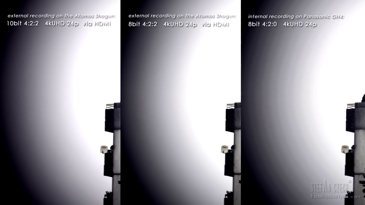

Emanuel Posted February 27, 2018 Share Posted February 27, 2018 1. Bit rate 2. Color sampling x. Bit depth 100 mbps can be short where 400mbps or 200mbps for a non-intra codec AFAIK like that one used on X-H1 can overcome further issues. Here's some informative link: https://fstoppers.com/education/can-you-see-difference-between-10-bit-and-8-bit-images-and-video-footage-166977 And this one endlessly posted over here before: sample extracted from (minute 28:30): https://vimeo.com/114978513 Orangenz 1 Link to comment Share on other sites More sharing options...

HockeyFan12 Posted February 27, 2018 Share Posted February 27, 2018 7 minutes ago, Emanuel said: 1. Bit rate 2. Color sampling x. Bit depth 100 mbps can be short where 400mbps or 200mbps for a non-intra codec AFAIK like that one used on X-H1 can overcome further issues. Here's some informative link: https://fstoppers.com/education/can-you-see-difference-between-10-bit-and-8-bit-images-and-video-footage-166977 And this one endlessly posted over here before: sample extracted from (minute 28:30): https://vimeo.com/114978513 I'm gonna check this link out! Never seen this, but that's exactly what I'd expect the difference to be. Subtle difference when increases bit depth, huge difference when increasing bit rate. Deadcode 1 Link to comment Share on other sites More sharing options...
Emanuel Posted February 27, 2018 Share Posted February 27, 2018 19 minutes ago, HockeyFan12 said: I'm gonna check this link out! Never seen this. Well, it is always my usual post on topic in these last two years and a half at least... We need to actually demystify that thing : ) If any 1 million -- in this case, 16 million colors is enough, why to spend 4x the same amount strictly necessary to handle the same as due? Link to comment Share on other sites More sharing options...
HockeyFan12 Posted February 27, 2018 Share Posted February 27, 2018 1 hour ago, Emanuel said: Well, it is always my usual post on topic in these last two years and a half at least... We need to actually demystify that thing : ) If any 1 million -- in this case, 16 million colors is enough, why to spend 4x the same amount strictly necessary to handle the same as due? Different people see the world differently. The clip you posted shows 8 bit and 10 bit gradients looking nearly identical to me, but for others perhaps the slight difference is very pronounced, based on how important 8 bit vs 10 bit is to some. For high end HDR (15+ stops) the color gamut and dynamic range are MUCH wider and there I truly do believe 10 bit color makes a significant difference with tonality. But for me it doesn't matter at all with the cameras I use. And I think everyone has to try out this out for themselves! Link to comment Share on other sites More sharing options...
Emanuel Posted February 27, 2018 Share Posted February 27, 2018 25 minutes ago, HockeyFan12 said: Different people see the world differently. The clip you posted shows 8 bit and 10 bit gradients looking nearly identical to me, but for others perhaps the slight difference is very pronounced, based on how important 8 bit vs 10 bit is to some. For high end HDR (15+ stops) the color gamut and dynamic range are MUCH wider and there I truly do believe 10 bit color makes a significant difference with tonality. But for me it doesn't matter at all with the cameras I use. And I think everyone has to try out this out for themselves! Agreed. Different needs apply. In any case, a matter of bit rate more than color sampling as 2nd line of factor to weigh heavily than the usual bit depth yadda yadda yadda... my fair guess. Practice variably redefines theory and people tend to neglect it :-) Link to comment Share on other sites More sharing options...
mkabi Posted February 27, 2018 Share Posted February 27, 2018 1 hour ago, Emanuel said: And this one endlessly posted over here before: If we go by this picture.... then some parts of House of Cards (first season, on Netflix) was probably filmed and/or delivered 8bit 4:2:0. From what I know, I saw banding in the low light (lamp) scenes, even in the first 2 episodes and those 2 episodes were directed by David Fincher (who is a RED guy) and by the looks of it - it may have been shot on a RED cam. http://www.red.com/shot-on-red/television - go into search and start typing "house of cards" Link to comment Share on other sites More sharing options...
Emanuel Posted February 27, 2018 Share Posted February 27, 2018 29 minutes ago, mkabi said: If we go by this picture.... then some parts of House of Cards (first season, on Netflix) was probably filmed and/or delivered 8bit 4:2:0. From what I know, I saw banding in the low light (lamp) scenes, even in the first 2 episodes and those 2 episodes were directed by David Fincher (who is a RED guy) and by the looks of it - it may have been shot on a RED cam. http://www.red.com/shot-on-red/television The streaming can be 8-bit 4:2:0 because people have no need of more. Take a look here: https://www.rtings.com/tv/learn/chroma-subsampling Delivered or even produced for Netflix, no way, no less than 10-bit 4.2:2 But the issues you mention are coming from low bit rate and compression quite likely. Link to comment Share on other sites More sharing options...
Damphousse Posted February 27, 2018 Share Posted February 27, 2018 8 minutes ago, mkabi said: If we go by this picture.... then some parts of House of Cards (first season, on Netflix) was probably filmed and/or delivered 8bit 4:2:0. From what I know, I saw banding in the low light (lamp) scenes, even in the first 2 episodes and those 2 episodes were directed by David Fincher (who is a RED guy) and by the looks of it - it may have been shot on a RED cam. http://www.red.com/shot-on-red/television - go into search and start typing "house of cards" Those are two very different things. Other than over the air broadcast television which the government has mandated to be of a certain quality everything else is subject to heavy compression. Maybe at some point in the future they will come up with better compression algorithms but until then just about anything you see on TV other than over the air broadcast is going to have an unacceptable amount of compression artifacts... and broadcast ain't perfect either. It's just most of the time it is the best of the worst. It is what it is, but there is simply no way you can work backwards from a lossy compressed final output and start commenting on the rest of the pipeline all the way back to the camera and the DP's brain. I see banding all the time on Netflix. That is one of the reasons I find 4k and HDR so baffling. Can we get at least broadcast quality 1080i first?! Link to comment Share on other sites More sharing options...
HockeyFan12 Posted February 27, 2018 Share Posted February 27, 2018 41 minutes ago, mkabi said: If we go by this picture.... then some parts of House of Cards (first season, on Netflix) was probably filmed and/or delivered 8bit 4:2:0. From what I know, I saw banding in the low light (lamp) scenes, even in the first 2 episodes and those 2 episodes were directed by David Fincher (who is a RED guy) and by the looks of it - it may have been shot on a RED cam. http://www.red.com/shot-on-red/television - go into search and start typing "house of cards" Did you work on the online or are you referring to the show as viewable on Netflix? Of course the Netflix version has tons of banding. Fincher aims for a very clean image and then it’s massively compressed for Netflix. And generally web content is not compressed with the same care that's taken with Blu Rays, that are processed in high end proprietary Linux machines using special software that can be used to mitigate banding. (Which, yes, is an issue with Blu Rays. I'm not saying bit depth is totally irrelevant, particularly in shadows and highlights.) If you were working on the online, however, that's a very interesting point. Denoising can help with compression efficiency, but a cleaner image at 8 bit from a high quality codec can exhibit more banding than a noisier image at the same bitrate of the same codec, and by far. I believe the Prometheus Blu Ray, for instance, had added grain. House of Cards was shot in the HDR (dual exposures, then merged) on Reds, I believe. Not sure it was all HDR. So it was something like 28 bit raw in effect. Link to comment Share on other sites More sharing options...
