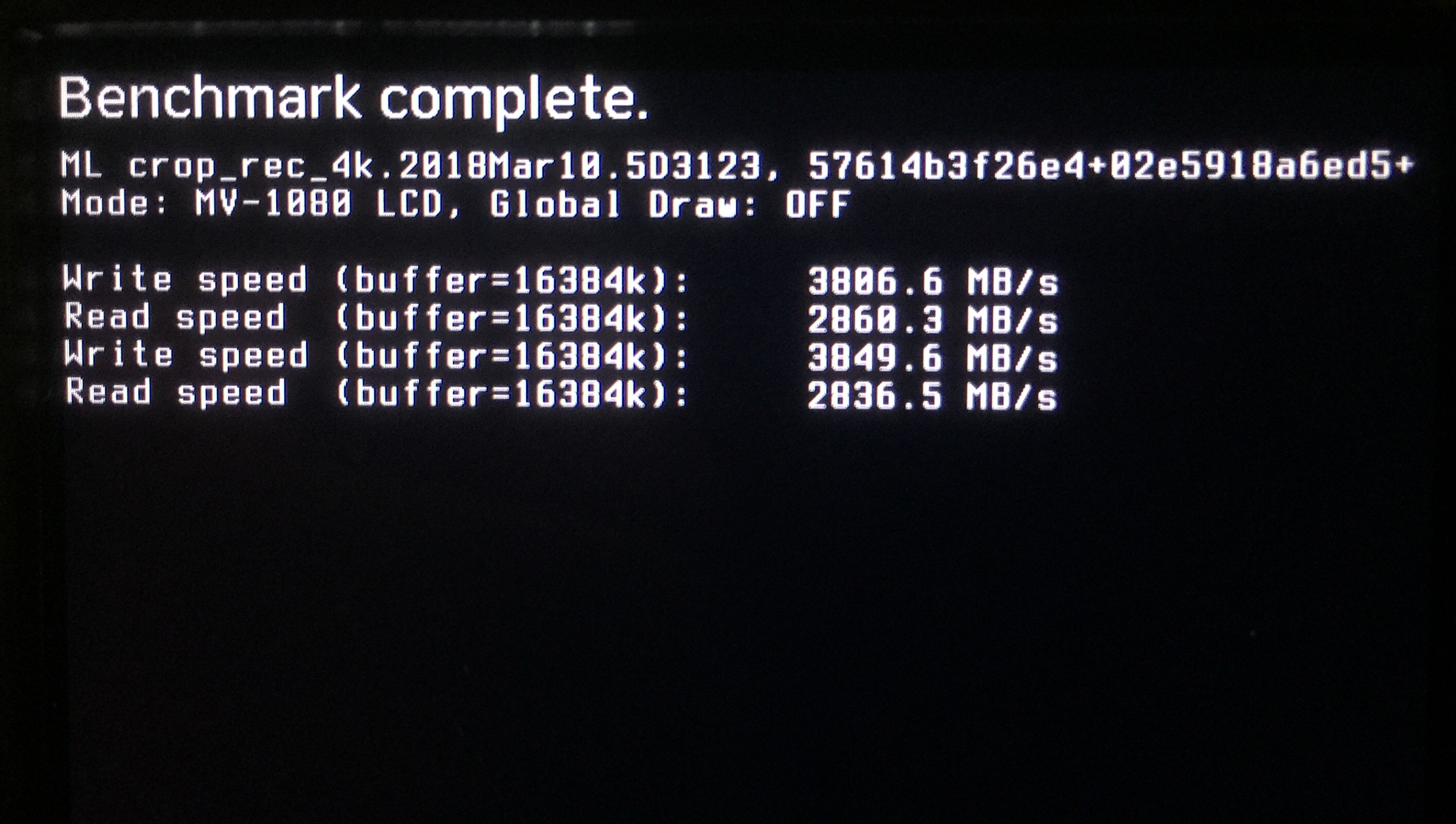

Deadcode Posted April 3, 2018 Share Posted April 3, 2018 Storm is coming... SD Card writing speed hack If you are familiar with the ML possibilities, you already know the best RAW capable cameras are those with CF card. The CF Card interface is capable of 70MB/s writing speed with 5D2, 75MB/s with 7D, and 95MB/s with 5D3. 6D / 700D which has SD interface is only capable of 40MB/s, limited by the camera and not the SD card. Now the ML team are pumping up the SD card interface writing speed. It seems like the 40MB/s can be raised up to 70MB/s or even further. That means the 700D will be able to record in 2520x1072 continuously I hope they can make it stable mercer, Stathman, KnightsFan and 4 others 7 Link to comment Share on other sites More sharing options...
kye Posted April 4, 2018 Share Posted April 4, 2018 5 hours ago, Deadcode said: Storm is coming... SD Card writing speed hack If you are familiar with the ML possibilities, you already know the best RAW capable cameras are those with CF card. The CF Card interface is capable of 70MB/s writing speed with 5D2, 75MB/s with 7D, and 95MB/s with 5D3. 6D / 700D which has SD interface is only capable of 40MB/s, limited by the camera and not the SD card. Now the ML team are pumping up the SD card interface writing speed. It seems like the 40MB/s can be raised up to 70MB/s or even further. That means the 700D will be able to record in 2520x1072 continuously I hope they can make it stable Holy wow.. that is excellent news! I bought my 700D for stills and to replace my Panasonic GF3 as a travel camera more years ago than I can remember... I think I read something about RAW compression (which I interpreted as lossless compression) which was also being worked on? Link to comment Share on other sites More sharing options...
Hans Punk Posted April 6, 2018 Share Posted April 6, 2018 Stathman 1 Link to comment Share on other sites More sharing options...
Stathman Posted April 6, 2018 Share Posted April 6, 2018 You forgot something... "Foolishly I should have quit earlier to recover the logs from the SD card, but alas that Sandisk appears to be toast, hence the lack of precise data - just my anecdotal report." "Do not try on expensive cards until we figure out what happened!" Hans Punk 1 Link to comment Share on other sites More sharing options...
Hans Punk Posted April 6, 2018 Share Posted April 6, 2018 24 minutes ago, Stathman said: You forgot something... "Foolishly I should have quit earlier to recover the logs from the SD card, but alas that Sandisk appears to be toast, hence the lack of precise data - just my anecdotal report." "Do not try on expensive cards until we figure out what happened!" LOL Link to comment Share on other sites More sharing options...
squig Posted April 7, 2018 Share Posted April 7, 2018 3 hours ago, Hans Punk said: Congrats, you made a cyberpunk earring. Now if you'll excuse me, I've gotta go sacrifice my first born to the film gods for sparing my 128Gb extreme pro. Link to comment Share on other sites More sharing options...
kye Posted April 7, 2018 Share Posted April 7, 2018 This card-reader hack is at the bleeding edge of the bleeding edge. When something hasn't been included in the experimental build yet..... Still, lots of people getting >40MB/s readings sure is promising. When it's stable I'll be using it for (1728 / 16:9 / 10bit / 48MB/s) and (1792 / 16:9 / 10bit / 51.6MB/s)... but I'd be interested to see if they manage to figure out modes above 1728 without a sensor crop. Link to comment Share on other sites More sharing options...
