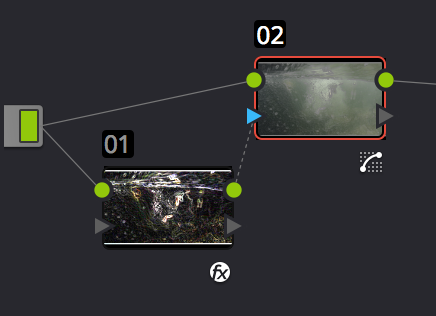

kye Posted May 15, 2018 Share Posted May 15, 2018 2 hours ago, kye said: @mercer I'm probably stating the obvious but Resolve seems to have pretty good NR, which if you put it in a separate node and use masks then you can get it pretty specific. On the video I shot on the GoPro in the club (with tonnes of ISO noise) I tried to run a NR node with a mask eliminating the edges (as NR is basically blur) but I couldn't find a way to generate an edge mask. The Sharpen Edges OFX plugin detects them, but the mask channel out doesn't seem to work for some reason. I haven't looked into this fully but it would be a great way to do heavier NR without blurring the main edges of objects. Ok, figured it out. Here's how to key out the edges and apply any Resolve adjustments to just the non-edges. This will allow NR without blurring edges (or any other adjustments you want to make). In the Colour panel create two nodes Add the EdgeDetect OFX plugin to one of them to make it the "key" node (Node 1 below) Connect the video signal like this: Make the adjustments you want to in Node 2 (eg, chroma NR) Adjust the settings in Node 1 to refine the mask that gets applied in Node 2 (I recommend adjusting Brightness to maximum to get a strong mask) The above setup excludes edges from being processed in the node, but it seems like you can also exclude other areas as well by adjusting the masks in Node 2 like qualifiers or power windows too, so you could (for instance) use the above to de-noise non-edge shadow areas by having the Qualifier in Node 2 exclude brighter areas of the frame. Enjoy! I wish I had worked this out before so I could do heavy NR processing without heavily blurring the video!! dxotic, capitanazo, mercer and 1 other 4 Link to comment Share on other sites More sharing options...
