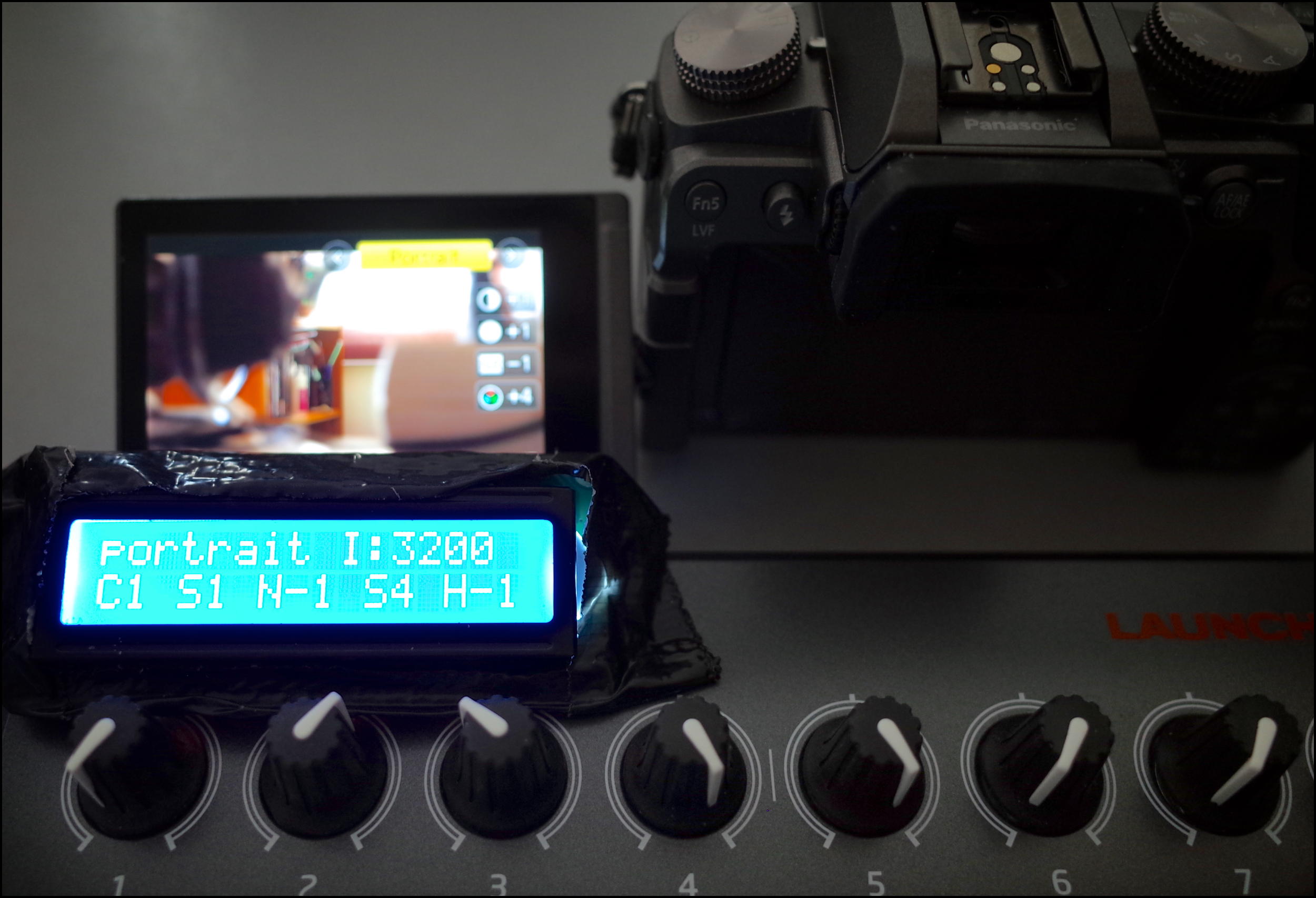

Super Members BTM_Pix Posted June 16, 2017 Super Members Share Posted June 16, 2017 Anyone guess what might be going on here then? Orangenz, Chris Oh, Andrew Reid and 4 others 7 Link to comment Share on other sites More sharing options...

Grimor Posted June 16, 2017 Share Posted June 16, 2017 Knobs!!!! robbino 1 Link to comment Share on other sites More sharing options...
robbino Posted June 16, 2017 Share Posted June 16, 2017 Novation midi controller to alter settings Link to comment Share on other sites More sharing options...
Super Members BTM_Pix Posted June 16, 2017 Author Super Members Share Posted June 16, 2017 2 hours ago, Grimor said: Knobs!!!! Yes 21 minutes ago, robbino said: Novation midi controller to alter settings And yes again. Its for live interactive control of the profile, sharpness, noise reduction, saturation, hue and ISO to create new custom profiles. Amazingly enough, it actually work as well! Even more surprising is that it allows this while you are recording. Grimor, jonpais, Chris Oh and 1 other 4 Link to comment Share on other sites More sharing options...
jonpais Posted June 17, 2017 Share Posted June 17, 2017 3 hours ago, BTM_Pix said: Yes And yes again. Its for live interactive control of the profile, sharpness, noise reduction, saturation, hue and ISO to create new custom profiles. Amazingly enough, it actually work as well! Even more surprising is that it allows this while you are recording. So you can change several parameters simultaneously and view the results live... In camera, you'd have to stop recording, dive into the menu, and you are only able to change one at a time. Could it also adjust curves? Link to comment Share on other sites More sharing options...
buggz Posted June 17, 2017 Share Posted June 17, 2017 This way cool! BTM_Pix 1 Link to comment Share on other sites More sharing options...
Super Members BTM_Pix Posted June 17, 2017 Author Super Members Share Posted June 17, 2017 6 hours ago, jonpais said: So you can change several parameters simultaneously and view the results live... In camera, you'd have to stop recording, dive into the menu, and you are only able to change one at a time. Could it also adjust curves? Yes, all simultaneously. I'll sort a video of it in operation later on. Curves are still under development.... jonpais 1 Link to comment Share on other sites More sharing options...
robbino Posted June 17, 2017 Share Posted June 17, 2017 Do you mind me asking what you using to interface the controller to the camera BTM_Pix? I have a midi controller which I was going to get rid off, but this looks like fun. Link to comment Share on other sites More sharing options...

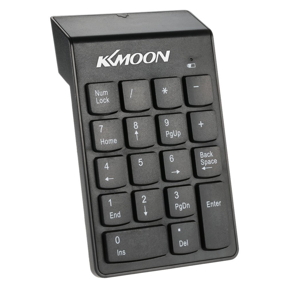

Super Members BTM_Pix Posted June 17, 2017 Author Super Members Share Posted June 17, 2017 7 minutes ago, robbino said: Do you mind me asking what you using to interface the controller to the camera BTM_Pix? I have a midi controller which I was going to get rid off, but this looks like fun. I'm currently running everything on a Pi so thats what runs my software that actually communicates by wifi to the camera. By doing it this way I'm then able to utilise different off the shelf hardware to be the user interface. In this instance the midi controller is plugged into the USB port of the Pi and I then catch and scale its messages as the input to my software. It also means I can use different hardware for different purposes, so the gamepad controller for camera control etc.and then map different ones quickly to use those instead. Such as the really neat bluetooth controller that I'll show you next week that will probably become the definitive one for camera control. But also means that if someone wanted a different way of controlling it - such as this bluetooth keypad for example - where they can put functions on different keys because they preferred it to using a gamepad then its easy to incorporate. Samin 1 Link to comment Share on other sites More sharing options...
robbino Posted June 17, 2017 Share Posted June 17, 2017 17 minutes ago, BTM_Pix said: I'm currently running everything on a Pi so thats what runs my software that actually communicates by wifi to the camera. By doing it this way I'm then able to utilise different off the shelf hardware to be the user interface. In this instance the midi controller is plugged into the USB port of the Pi and I then catch and scale its messages as the input to my software. Thanks for your reply. I also have a Pi so looking forward to when you give the information on this, great work BTM_Pix 1 Link to comment Share on other sites More sharing options...
Super Members BTM_Pix Posted June 17, 2017 Author Super Members Share Posted June 17, 2017 A quick video demo of the new prodder in action. All controls are real time with feedback of the parameters on the LCD screen. The video shows a recording of the G7 being controlled (and of it being controlled as the changes are live when its recording) but will obviously work with the other Lumix cameras. Parameters controlled are : Profile type (Standard, cinelike D etc) Contrast Noise Reduction Sharpness Saturation Hue and ISO so you can see any effect changes that may or may not occur with your current settings at different ISOs Now there may be no bugs in the software but there certainly was in the video. A real life bug crawling across the Colour Checker! robbino, Orangenz and Samin 3 Link to comment Share on other sites More sharing options...
Super Members BTM_Pix Posted June 17, 2017 Author Super Members Share Posted June 17, 2017 And just to stress that the purpose of this particular prodder is to help develop colour profiles rather than being an end thing in itself, in case you thought I was advocating twiddling around like Kraftwerk while you're recording video. Though having said that, I think that there is a place for a similar type of control surface (one with faders as well as pots and a few switches) to operate the cameras in terms of the rest of its functionality like shutter, iris and focus. In that way, the colour profile function could just be switched into a second layer and be permanently available. Should also mention that you will be able to save a lot more than the one custom profile that Panasonic offers you with this system so once you have all of these parameters as you like them then you can save the whole snapshot for instant recall via buttons on the controller. If this gets any traction you'll also be able to easily share them with each other too to load on to your own cameras. Chris Oh, samuel.cabral, robbino and 1 other 4 Link to comment Share on other sites More sharing options...
