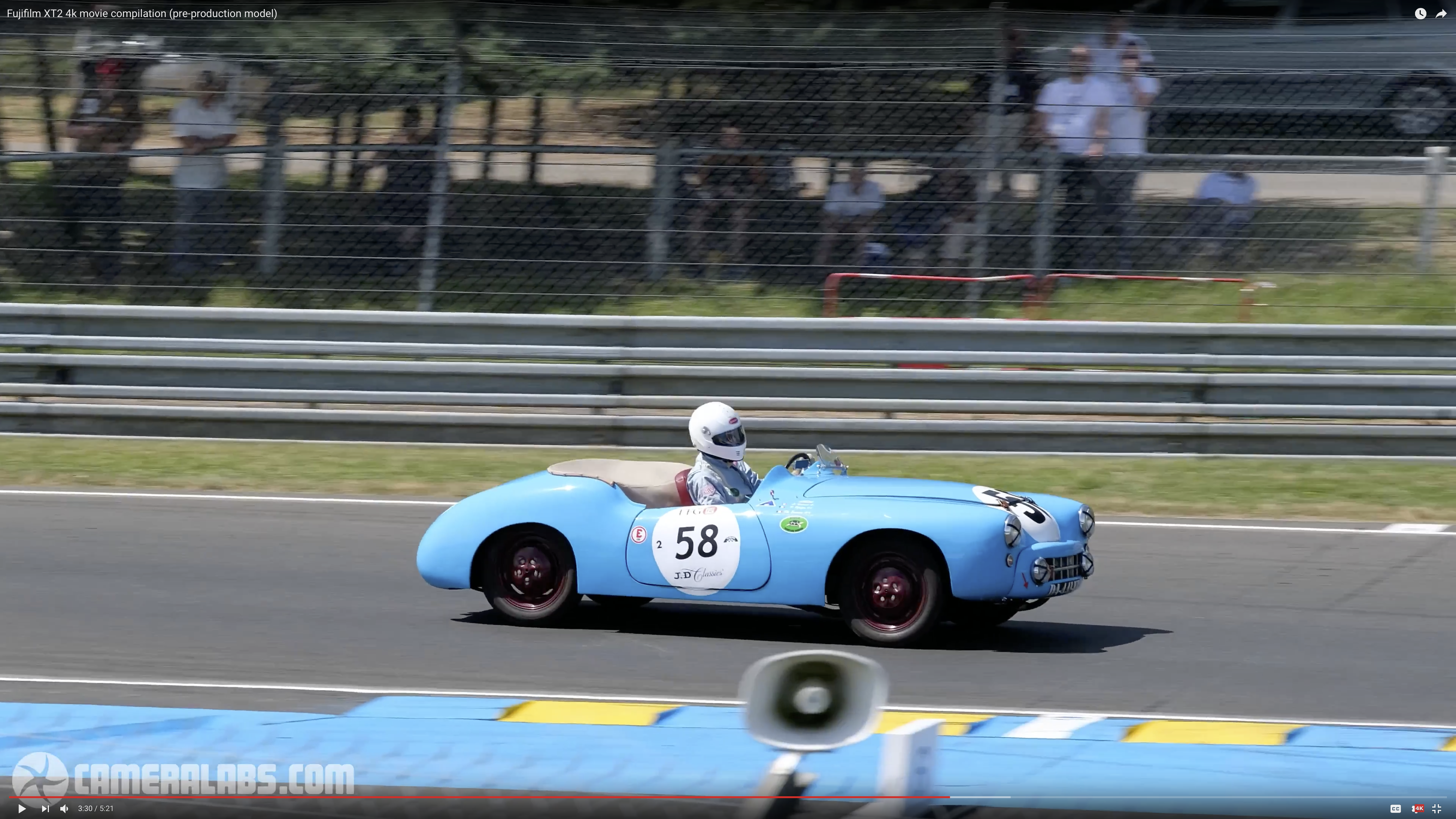

The Chris Posted July 14, 2016 Share Posted July 14, 2016 12 hours ago, kidzrevil said: @The Chris image looks beautiful even at 1080 ! Is it just me or does the motion cadence look terrible It looks like he didn't have a ND filter and bumped up the SS to compensate for bright conditions, but I've never been overly critical of motion. Others may have more insight. 5 hours ago, Digitgio said: Yes I know, is more than tricky,but I recorded either in 4K and 1080p and after played the clips and put it on still in the middle of a fast pan and the vertical line on 4K was unfortunately diagonal... So seems no news on rolling, but I think for the price it will be a good camera... I've asked a few of the early testers to do a formal RS test and they've all had the same reply - they're waiting for a final video firmware update before posting more comprehensive video tests as Fuji is still tweaking things. RS doesn't look a6300 bad panning at the long end of the 50-140 with a teleconverter in the screen cap below, but more formal tests are definitely needed. With the grip boosting processor power, it'll be interesting to see if its performance is better than the a6300. kidzrevil 1 Link to comment Share on other sites More sharing options...

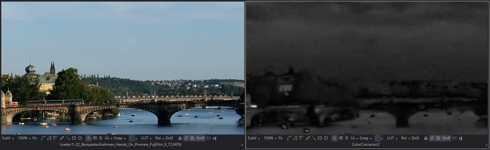

no_connection Posted July 14, 2016 Share Posted July 14, 2016 It seems that they are making an effort to keep artifacts and banding in check. Here is a saturation map of XT2 compared to a clip buy fuzzynormal from the original files thread of the GX85. I could not fine the same amount of contrast/punch tho, so comparison is a little stretched. To make a saturation map you shift hue by 180*(0.5 in fusion) with the color corrector node, then combine with difference node to the original. You then desaturate the result to grayscale. I gained it by 2 here to make it more visible. The XT2 clip appears to be dithered and a bit smoother compared to the GX85 which is showing a bit more blocks. It is not without blocks as something have to go when compressing. But how these artifacts behave and how much effort goes in to handle them determines how much the file can be pushed around before it breaks up. This is also why flat profiles are not always a good thing. btw saturation map works great as a mask for things. frontfocus, John_Harrison and zetty 3 Link to comment Share on other sites More sharing options...

MattH Posted July 14, 2016 Share Posted July 14, 2016 For anyone who is interested in rolling shutter performance I have done multiple measurements on the panning shots in Gordon Laing’s video and determined that the rolling shutter skew is about 65% which means a readout speed of around 27ms. Of course its not an exact science because there is no vertical object that goes from the top of the screen to the bottom and there could be acceleration or deceleration from one frame to the next, but all of the results were coming up around this area. I’m sure Samuel H will eventually come out with an ‘official’ figure after doing the exact same thing and proclaiming a number that is for all intents and purposes the same. So people are free to wait for that, but for anyone who wants to cut to the chase: 25 to 30 ms is your ballpark figure. Link to comment Share on other sites More sharing options...
