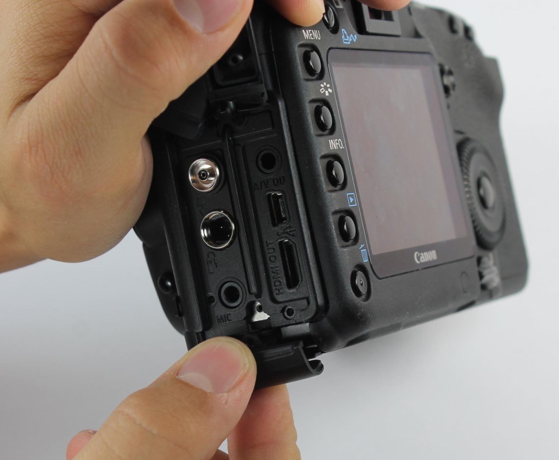

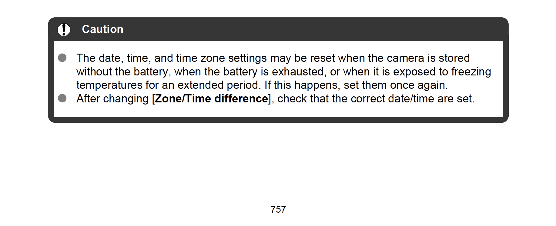

HansD Posted August 12, 2020 Share Posted August 12, 2020 5 hours ago, visionrouge said: You may want to check, but there is a button cell to keep the camera time https://www.ifixit.com/Guide/Canon+EOS+5D+Mark+II+Clock+Battery+Replacement/31531 Look more for something like this to reset time. If this reset the recovery time or recording time, it's the 100% proof that there is no valid temperature reading, but time based only This is for 5D, but I guess 5R have something similar The EOS R5 manual indicates that there is no separate battery for date and time storage. Probably just flash memory. visionrouge 1 Link to comment Share on other sites More sharing options...
visionrouge Posted August 12, 2020 Share Posted August 12, 2020 19 minutes ago, HansD said: The EOS R5 manual indicates that there is no separate battery for date and time storage. Probably just flash memory. Ok, so only way is to open the camera and unplug the board with the power storage. Another way would maybe to do a "firmware update when the new firmware will be present, right after overheating. Testing would be to turn on the camera until it reach the fake overheating logo. remove the battery Unplug the board with the power (I can see a red/black cable on the bottom left) Wait 10 second, Plug it back and see if overheating is still present. This is only to prove that these warning are fake. I guess there are some overheating sensor in case. But on the test done here, it's the "timer" overheat that kick-in first. This is so wrong. Link to comment Share on other sites More sharing options...

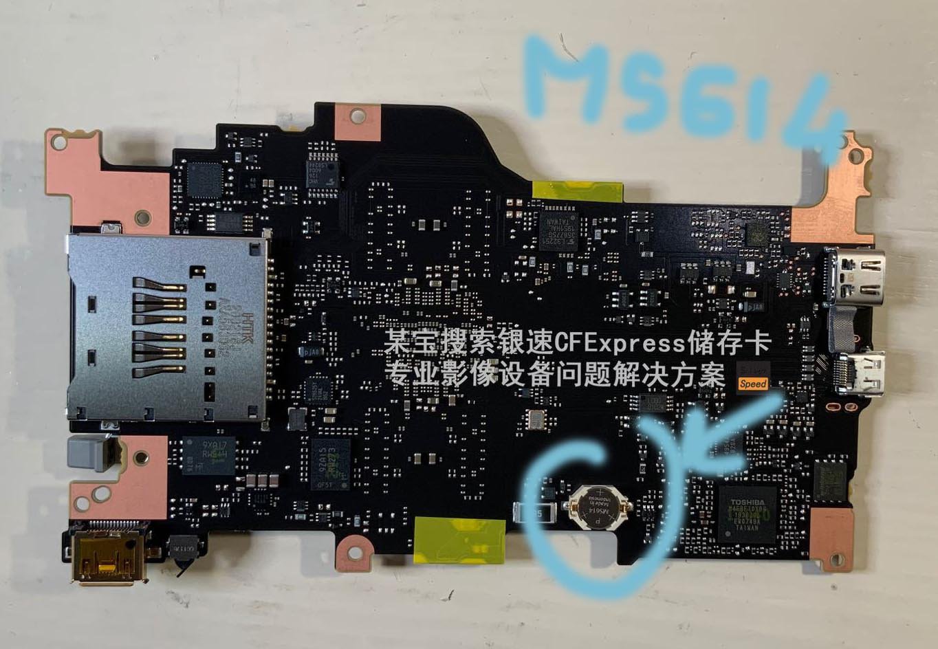

visionrouge Posted August 12, 2020 Share Posted August 12, 2020 1 hour ago, Andrew Reid said: How about we turn the camera on, do nothing with it, leave it in the menus. Put it in the freezer. After 1 hour, see if the timer has ticked down to 0 mins of 8K. Who wants to see an OVERHEATED! SHUTTING DOWN! screen with frost on it? Here is your battery, btw. MS614, coin cell 3V. Bring the camera on overheat without taking picture, so it's not too hot. Open the camera, remove this coin for 10 second, put it back and see if the recovering time real or not... Link to comment Share on other sites More sharing options...
zerocool22 Posted August 12, 2020 Share Posted August 12, 2020 4 hours ago, visionrouge said: Here is your battery, btw. MS614, coin cell 3V. Bring the camera on overheat without taking picture, so it's not too hot. Open the camera, remove this coin for 10 second, put it back and see if the recovering time real or not... What about removing the battery out completely? visionrouge 1 Link to comment Share on other sites More sharing options...

visionrouge Posted August 13, 2020 Share Posted August 13, 2020 8 hours ago, zerocool22 said: What about removing the battery out completely? If so, you will have to put the new time/date and all parameters each time you change battery on regular use. My idea was just a test to do in order to prove what it seems to appear; the overheating warning is always override with a timer. Removing the coin cell is the best way to do so, I'm agree, (but not very convenient for a everyday use.) Link to comment Share on other sites More sharing options...

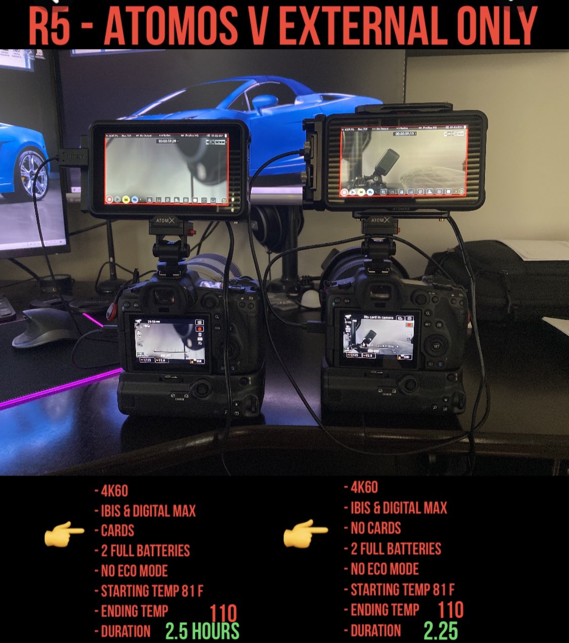

mechanicalEYE Posted August 13, 2020 Share Posted August 13, 2020 12 minutes ago, visionrouge said: If so, you will have to put the new time/date and all parameters each time you change battery on regular use. My idea was just a test to do in order to prove what it seems to appear; the overheating warning is always override with a timer. Removing the coin cell is the best way to do so, I'm agree, (but not very convenient for a everyday use.) I'm not the guy to take on opening up a camera but today I'm outside in 102 degrees recording 4K HQ externally for 45 minutes straight with no overheat warning. ( Camera screen off ) and the camera was very HOT to the touch, much hotter than I've experienced at any point during my test and I have shot in 97 degrees where the camera shut down at 42 minutes. Only difference was that the screen was on before, and here it was off. The camera felt much hotter today though. It was hot enough that I was concerned. I was pretty shocked that it didn't overheat, and even more shocked it didn't show the warning. I brought the camera indoors while it was still recording, grabbed my CFexpress card and inserted while camera was still recording. When you open the card door, the camera temporarily shuts down. When I closed the door the camera went right back to recording through the Ninja V. I shut the Ninja V down, and my 4K HQ time allowance was 20 minutes. I shut the camera down again, and back on it, it still read 20 minutes. About 5 minutes later the camera was showing 25 minutes, this is while the camera still felt very warm to the touch. ntblowz 1 Link to comment Share on other sites More sharing options...
independent Posted August 13, 2020 Share Posted August 13, 2020 Just got my hands on a R5, tested w/ Ninja V. No cards, LCD display was off, I had mine closed to the body - recorded continuously at 4KHQ w/ autofocus (rf 50 1.2) and IS on. Recorded continuously until 1.5 hours - when the battery (regular LP-E6) died. No overheating temp indicator, but the body was HOT. Hotter than any body I've felt, and I've felt a lot of bodies. P2020 1 Link to comment Share on other sites More sharing options...
independent Posted August 13, 2020 Share Posted August 13, 2020 So maybe the HDMI out is somehow bypassing the artificial limits, or maybe it's bypassing the temp controls and damaging the camera. I don't know. Regardless, and more importantly, the 8K Raw is the best I've ever seen. Point blank. Detail and color are next level - I think it's finally approaching what the eyes can resolve. Immersive, transparent, 3D, microcontrast, etc. 8K raw footage is truly a compilation of high res stills at 24 FPS. Can pull stills and send them to editorial—game changing in the way RED advertised w/ EPIC. But RED didn't have autofocus - this does. Every. Frame. Sharp. I was impressed by the BMPCC6K - the increase in resolution made a huge difference from 4k, and this R5 8K RAW is just as big of a jump. It's kind of staggering. You don't know what you've been missing unless you actually scrub through this footage, which you can in Resolve (good luck w/ the h265). Bottom line, the 4kHQ 24 seems viable w/ the Ninja (unless it destroys the camera). But who cares, you can get high quality 4K anywhere. More importantly 8K Raw is 100% the bees knees. That's the only news I care about from this point forward. Andrew, make it happen. P2020 1 Link to comment Share on other sites More sharing options...
Video Hummus Posted August 13, 2020 Share Posted August 13, 2020 24 minutes ago, mechanicalEYE said: I'm not the guy to take on opening up a camera but today I'm outside in 102 degrees recording 4K HQ externally for 45 minutes straight with no overheat warning. ( Camera screen off ) and the camera was very HOT to the touch, much hotter than I've experienced at any point during my test and I have shot in 97 degrees where the camera shut down at 42 minutes. Only difference was that the screen was on before, and here it was off. The camera felt much hotter today though. It was hot enough that I was concerned. I was pretty shocked that it didn't overheat, and even more shocked it didn't show the warning. I brought the camera indoors while it was still recording, grabbed my CFexpress card and inserted while camera was still recording. When you open the card door, the camera temporarily shuts down. When I closed the door the camera went right back to recording through the Ninja V. I shut the Ninja V down, and my 4K HQ time allowance was 20 minutes. I shut the camera down again, and back on it, it still read 20 minutes. About 5 minutes later the camera was showing 25 minutes, this is while the camera still felt very warm to the touch. Yet it takes 1 hours of sitting with sensor exposed and battery out and card slot open to get 5 more minutes. Some serious bugs there. Link to comment Share on other sites More sharing options...
mechanicalEYE Posted August 13, 2020 Share Posted August 13, 2020 9 minutes ago, Video Hummus said: Yet it takes 1 hours of sitting with sensor exposed and battery out and card slot open to get 5 more minutes. Some serious bugs there. I'm not sure what Canon has going on here but its strange behavior! The way I see it there is no way this camera should have been providing cold times as hot as it was at the point where the Card was installed. No Joke. It was HOT HOT! Sat for a total of 12 minutes and was at the 25 minutes for HQ. I have never let it sit with sensor exposed or card slot open. This is the same camera that shut down at 42 minutes in 97 degrees... with no card in body and would only allow 5 minutes of HQ recording once I put card in before. It shut down at 42 minutes indoors as well. Andrews idea cleared that process in someway... he'll have to chime in but it worked. In my eyes this is all software. The camera was HOT and it went from 20 to 25 minutes within like 3 minutes. Totally different camera today. somethings up with installing card while HDMI is plugged in or something. What are your thoughts Andrew? Link to comment Share on other sites More sharing options...
