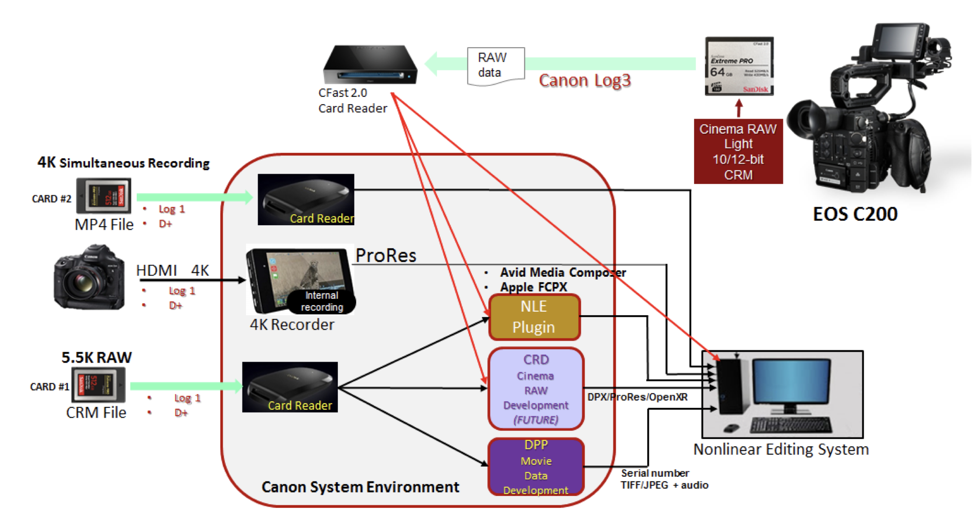

Michael Steiner Posted January 7, 2020 Share Posted January 7, 2020 1 hour ago, gt3rs said: But on the withe paper that I posted above they have a table with the max recording time per format that does not make sense if is 30min limit. True... I guess we'll find out soon enough. And now that I have scanned through the whitepaper I see there's no C-Log2 and C-Log3 on the 1dx3. It seems those are supported only in Cinema RAW light... Quote Link to comment Share on other sites More sharing options...
gt3rs Posted January 7, 2020 Share Posted January 7, 2020 2 minutes ago, Michi said: True... I guess we'll find out soon enough. And now that I have scanned through the whitepaper I see there's no C-Log2 and C-Log3 on the 1dx3. It seems those are supported only in Cinema RAW light... It seems that CLog in 1Dx III is similar to CLog3 on the C200 as this picture seems to imply that the 1Dx III is the B cam in this scenario.... Quote Link to comment Share on other sites More sharing options...
