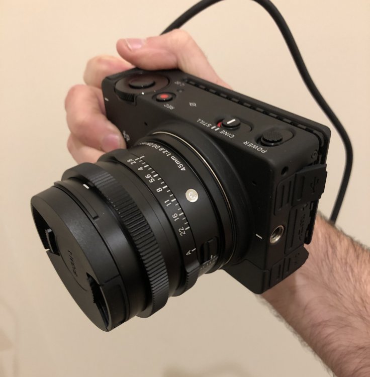

Brian Williams Posted October 31, 2019 Share Posted October 31, 2019 Is it me or is the camera system a little wonky? Like I would assume settings wouldn’t carry over from Stills to Cine, or vice versus, but if you set AF to manual In CINE mode, then switch over to stills, I’m still MF. Same for ISO, program mode. I’d hope these things would’ve stay specific to either mode, to make it easier to switch back and forth. Link to comment Share on other sites More sharing options...
