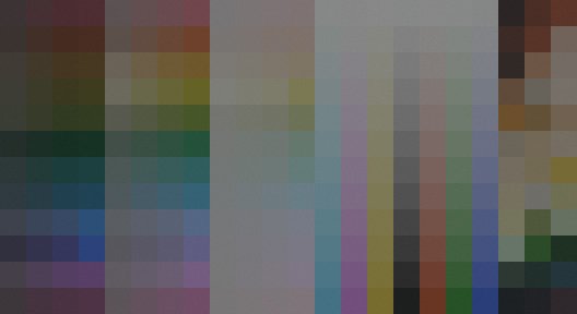

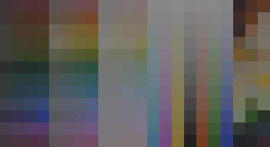

hyalinejim Posted June 10, 2022 Share Posted June 10, 2022 This is the colour difference between GH5 VLog and GH6 VLog: GH5 GH6 In general most of the colour palette is warmer and skintones, as everyone already knows, are no longer to magenta. Blues are also more accurate, being slightly darker and more purple than they are on the GH5. Greens are more yellow. PannySVHS, sanveer, webrunner5 and 1 other 2 2 Link to comment Share on other sites More sharing options...

kye Posted June 10, 2022 Author Share Posted June 10, 2022 2 hours ago, hyalinejim said: This is the colour difference between GH5 VLog and GH6 VLog: GH5 GH6 In general most of the colour palette is warmer and skintones, as everyone already knows, are no longer to magenta. Blues are also more accurate, being slightly darker and more purple than they are on the GH5. Greens are more yellow. Isn't the Vlog on the GH5 V-LogL or some other non-proper form of V-Log? I was never really that straight on that profile. I do remember people were saying the GH6 had proper V-Log so it was compatible with the LUTs from the proper Panasonic Cinema Cameras? Link to comment Share on other sites More sharing options...

hyalinejim Posted June 10, 2022 Share Posted June 10, 2022 14 minutes ago, kye said: I would have thought that pushing the same button multiple times was easier than having to use multiple controls Well, the Q button is by your thumb. Then you just need the shutter wheel, which is easy to find, followed by the shutter button. So it's all quite intuitive and relies on muscle memory. 12 minutes ago, kye said: Isn't the Vlog on the GH5 V-LogL VLog-L maxes out at 80IRE. Full VLog goes further. In that regard, GH6 without DR boost is the same as VLog-L. Once you turn DR boost on you get a bit more info in the highlights above 80 IRE. The perceived incompatibility of GH5 VLog-L with the Varicam luts has more to do with the colour, I think. The GH5 V-gamut colour is a bit off, most noticeably in skintones. The GH6 is supposed to be closer to the other cameras (S series, EVA1 and presumably Varicam) in that regard. I would say that when applying the Varicam luts, the GH6 colours look all right. kye 1 Link to comment Share on other sites More sharing options...
