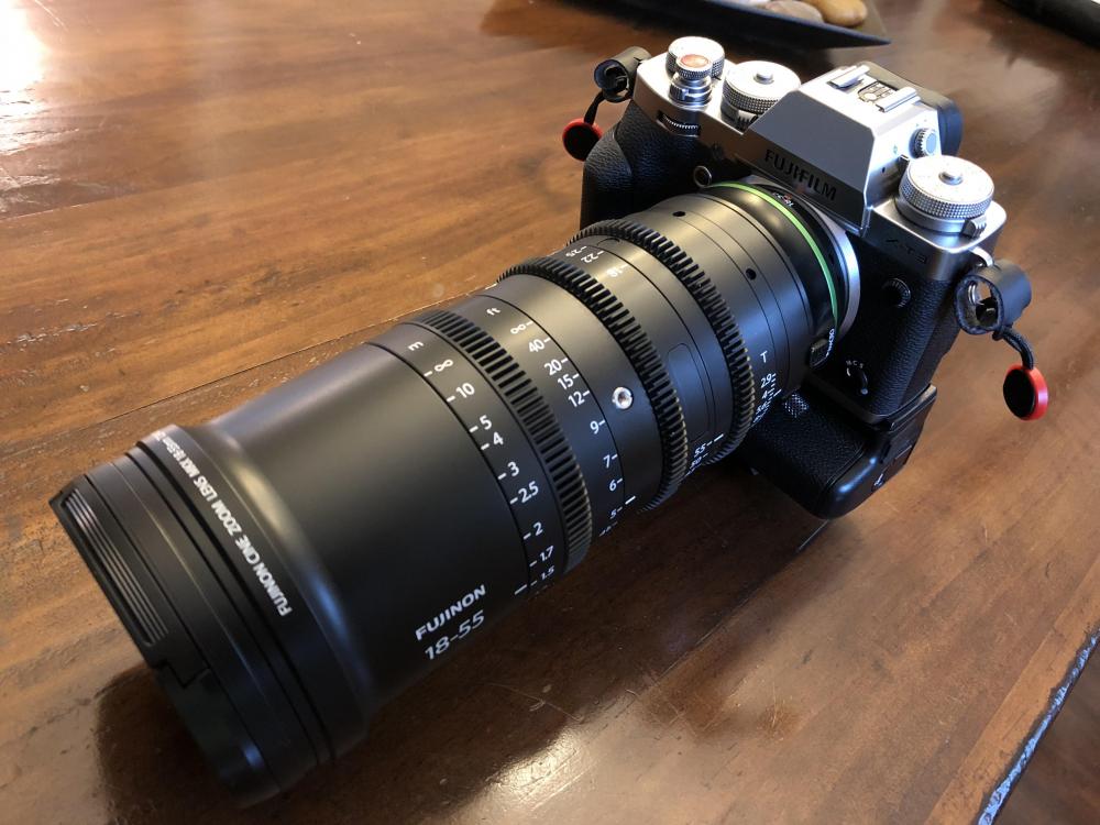

DBounce Posted October 19, 2018 Share Posted October 19, 2018 Hope to make some time to play with this bad boy we just added to the collection. Also picked a second body and another Ninja V. I think these cams play nice as B-cams to the C200. Moreso than the 1DXMK2... if that makes sense. Jimmy, Vintage Jimothy, AlexTrinder96 and 1 other 4 Link to comment Share on other sites More sharing options...

DBounce Posted October 19, 2018 Share Posted October 19, 2018 10 minutes ago, Jimmy said: Agghhhh... salivating! From a quick play... salivating makes total sense. This lens is ever bit as good as you have heard. Important note for anyone thinking of picking one up. Remember that the focal range is as marked... no need to multiply by 1.5. So 18-55mm is really 18-55mm. Link to comment Share on other sites More sharing options...
androidlad Posted October 19, 2018 Share Posted October 19, 2018 1 minute ago, DBounce said: From a quick play... salivating makes total sense. This lens is ever bit as good as you have heard. Important note for anyone thinking of picking one up. Remember that the focal range is as marked... no need to multiply by 1.5. So 18-55mm is really 18-55mm. What do you mean no need to multiply by 1.5? I thought all lenses are marked by 35mm focal length. So 18-55 would have FF equivalent FOV of 28-85? Link to comment Share on other sites More sharing options...
Attila Bakos Posted October 19, 2018 Share Posted October 19, 2018 9 minutes ago, androidlad said: What do you mean no need to multiply by 1.5? I thought all lenses are marked by 35mm focal length. So 18-55 would have FF equivalent FOV of 28-85? True. Check here: http://www.fujifilm.com/news/n180215_02.html In the 35mm format equivalent, MKX18-55mm covers a focal distance from 27mm to 84mm and MKX50-135mm covers a focal distance from 76mm to 206mm. Link to comment Share on other sites More sharing options...

DBounce Posted October 19, 2018 Share Posted October 19, 2018 12 minutes ago, Attila Bakos said: True. Check here: http://www.fujifilm.com/news/n180215_02.html In the 35mm format equivalent, MKX18-55mm covers a focal distance from 27mm to 84mm and MKX50-135mm covers a focal distance from 76mm to 206mm. I mean compared to cinema lenses. They generally don’t bother with 35mm equivalents. Link to comment Share on other sites More sharing options...
androidlad Posted October 19, 2018 Share Posted October 19, 2018 5 minutes ago, DBounce said: I mean compared to cinema lenses. They generally don’t bother with 35mm equivalents. Really? I thought all lenses, including medium format and 65MM/IMAX lenses are marked with 35mm focal length? Link to comment Share on other sites More sharing options...
TheRenaissanceMan Posted October 19, 2018 Share Posted October 19, 2018 Y'all are needlessly confusing yourselves. These lenses are listed in their actual focal lengths. These numbers are a property of the optical system, independent of whatever camera they're being used on. The field of view these lenses give IS affected by the sensor size of the camera they're mounted to, but that does not change the focal length of the lens--only the effective field of view. Also, no one in the cinema world "translates" their focal lengths to full frame. 18-55 is 18-55. Link to comment Share on other sites More sharing options...
