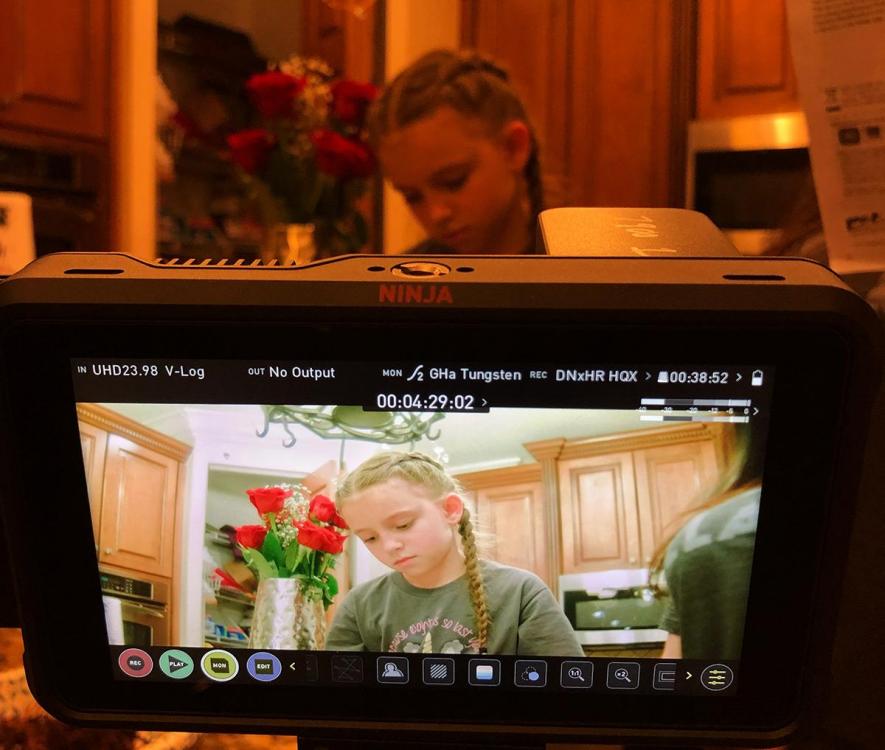

katlis Posted October 14, 2018 Share Posted October 14, 2018 On 10/12/2018 at 12:06 PM, Sage said: Yes, if its VLog in DNX (hides the unique flagging of VLog L for correct levels) it would need the ProRes PRE. Mezzanine formats (ProRes/DNX) are best avoided at the moment in Premiere, as PPro distorts the color space (ProRes confirmed). Glad I read this page today, didn't know about the ProRes PRE with DNX, thanks for the heads up. I just did a 4K 10bit 60p test in DNxHR HQX (with my new Ninja V)! Definitely getting different results between software. Premiere has more of a green cast. You can get closer to Resolve's output in Premiere by simply decreasing the temp by 1.0 and increasing the tint by 1.0, in this test anyway. Still not the same, but hard to see with the eye after tweaking. Side note, loving the little Ninja V. Using the full 3D LUT for monitoring is awesome! Link to comment Share on other sites More sharing options...

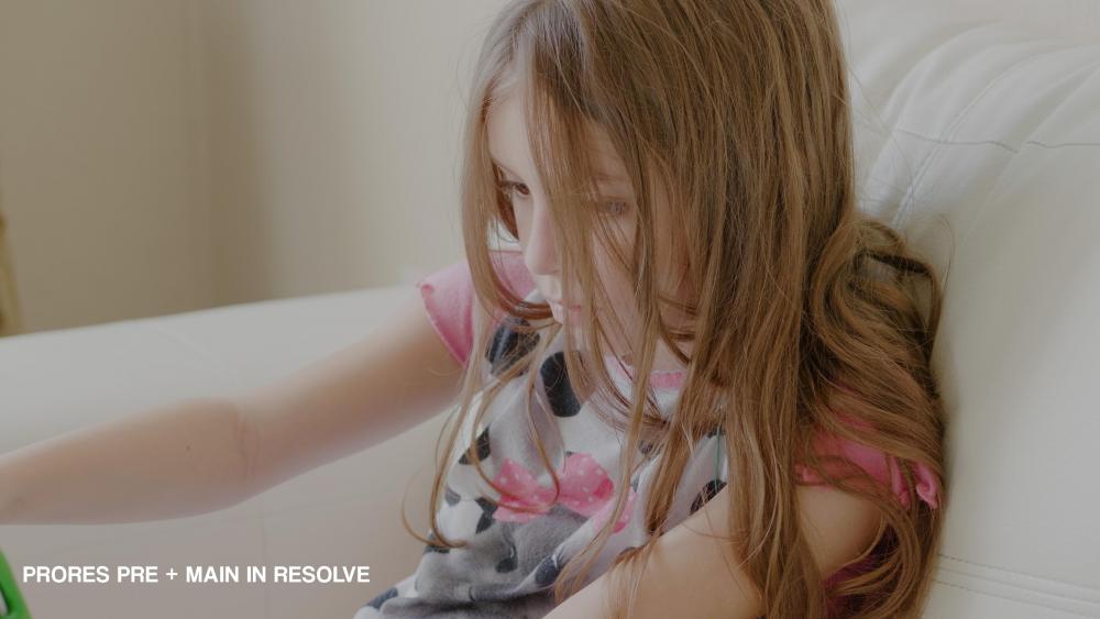

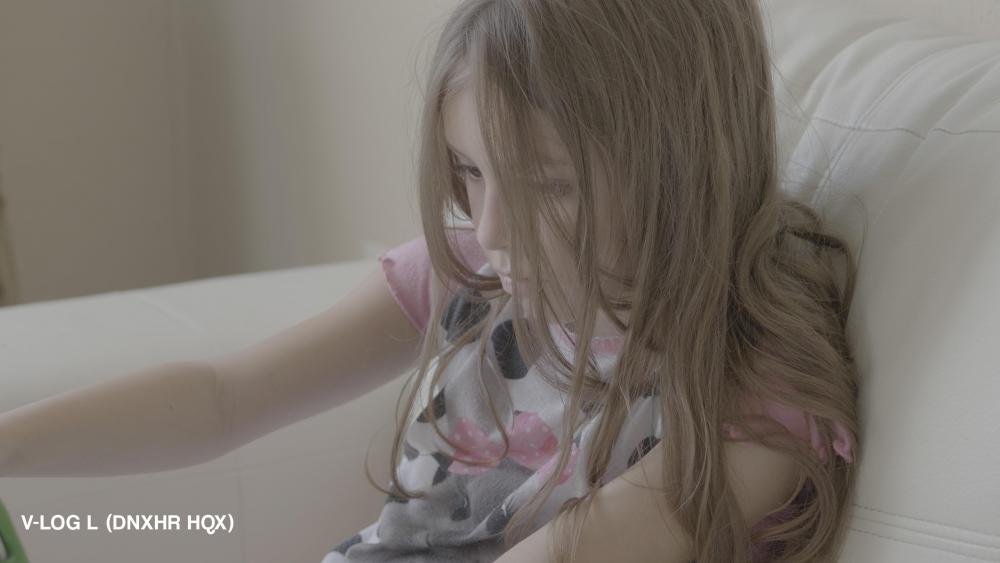

Sage Posted October 15, 2018 Author Share Posted October 15, 2018 1 hour ago, mirekti said: Oh, I might have missed the point here. Does this mean PRE is only to be used with Premiere and in Resolve it is not needed no matter the codec used? No PRE is needed for raw VLog in Resolve A PRE is needed in Resolve for: HLG, Cine-D, and VLog wrapped in ProRes/DNX (or for wrapped VLog, 'data levels' can be set to Full/Data for the clip) mirekti 1 Link to comment Share on other sites More sharing options...
