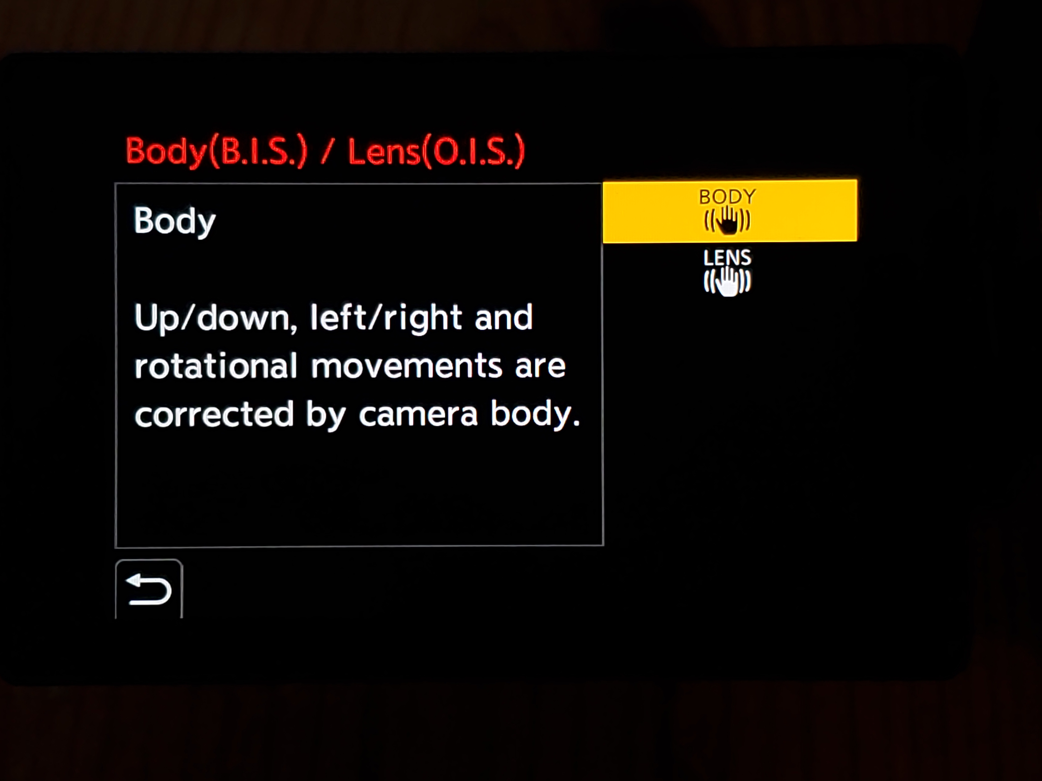

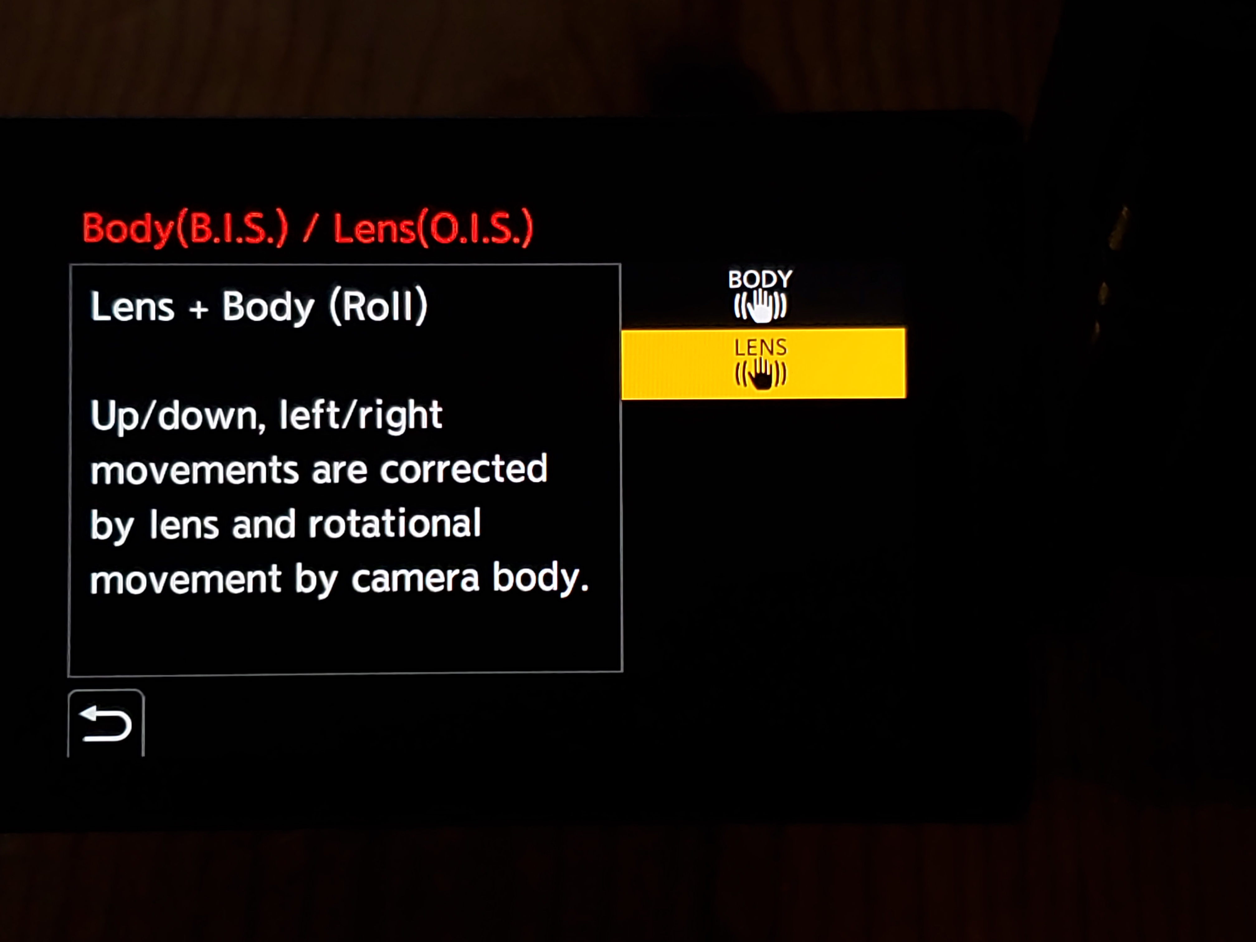

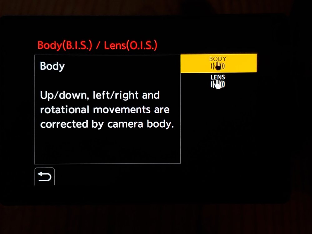

hyalinejim Posted January 25 Share Posted January 25 12 hours ago, independent said: Would be interested in how the image stabilization is on non native lenses, i.e., EF lenses with and without optical stab. I just had a quick look at this and it seems that when using EF lenses with the MC21 you need to turn on the IS switch on the lens in order for IBIS to work. This was a bit strange to me as I'm used to a Metabones Speedbooster where the lens IS switch has to be turned off for IBIS to work. If it's not an IS lens then you don't worry about the switch, lol, because there isn't one. Then there are two options. One is body only and this is the best: The other is a weird mixture of body and lens: This second option is jerky with EF lenses on an MC21 and is in no way comparable to body only. So I don't think there is a way to have both full IBIS in all directions plus whatever the lens can do. But, I think I remember seeing some YT reviews with Panasonic lenses where the reviewer just stuck with body only. So I would say that body only is also good enough for EF lenses. independent and Thpriest 1 1 Quote Link to comment Share on other sites More sharing options...
