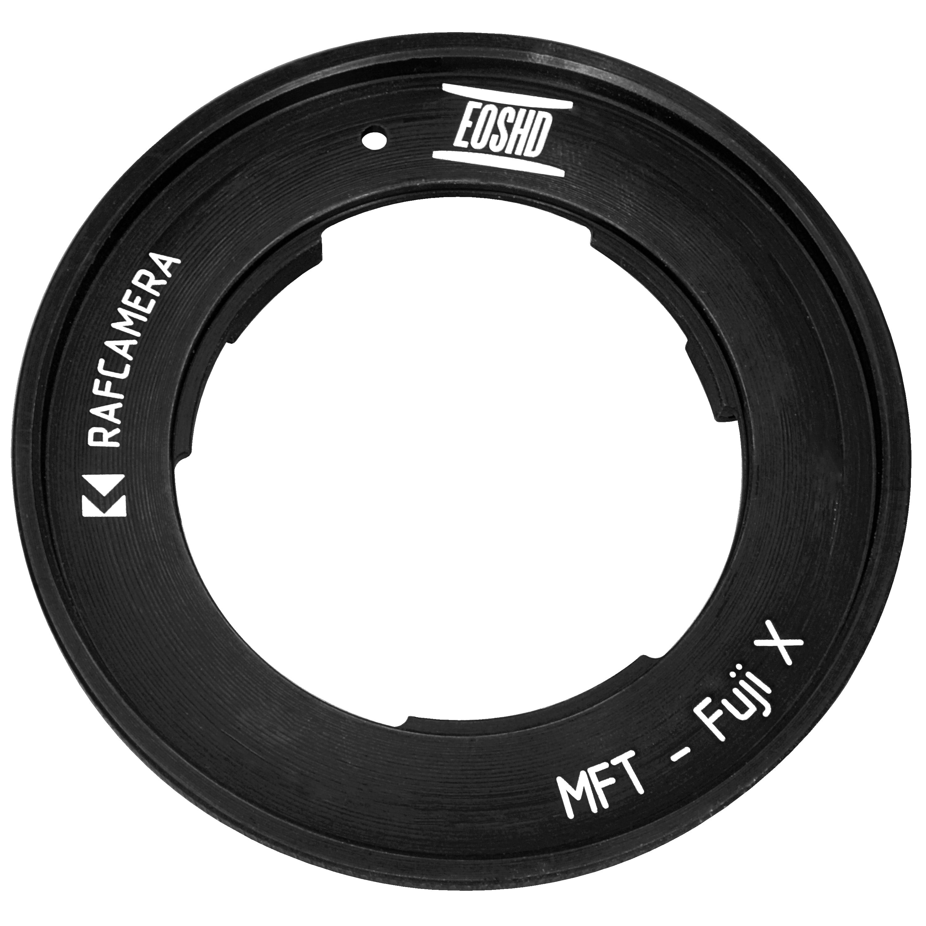

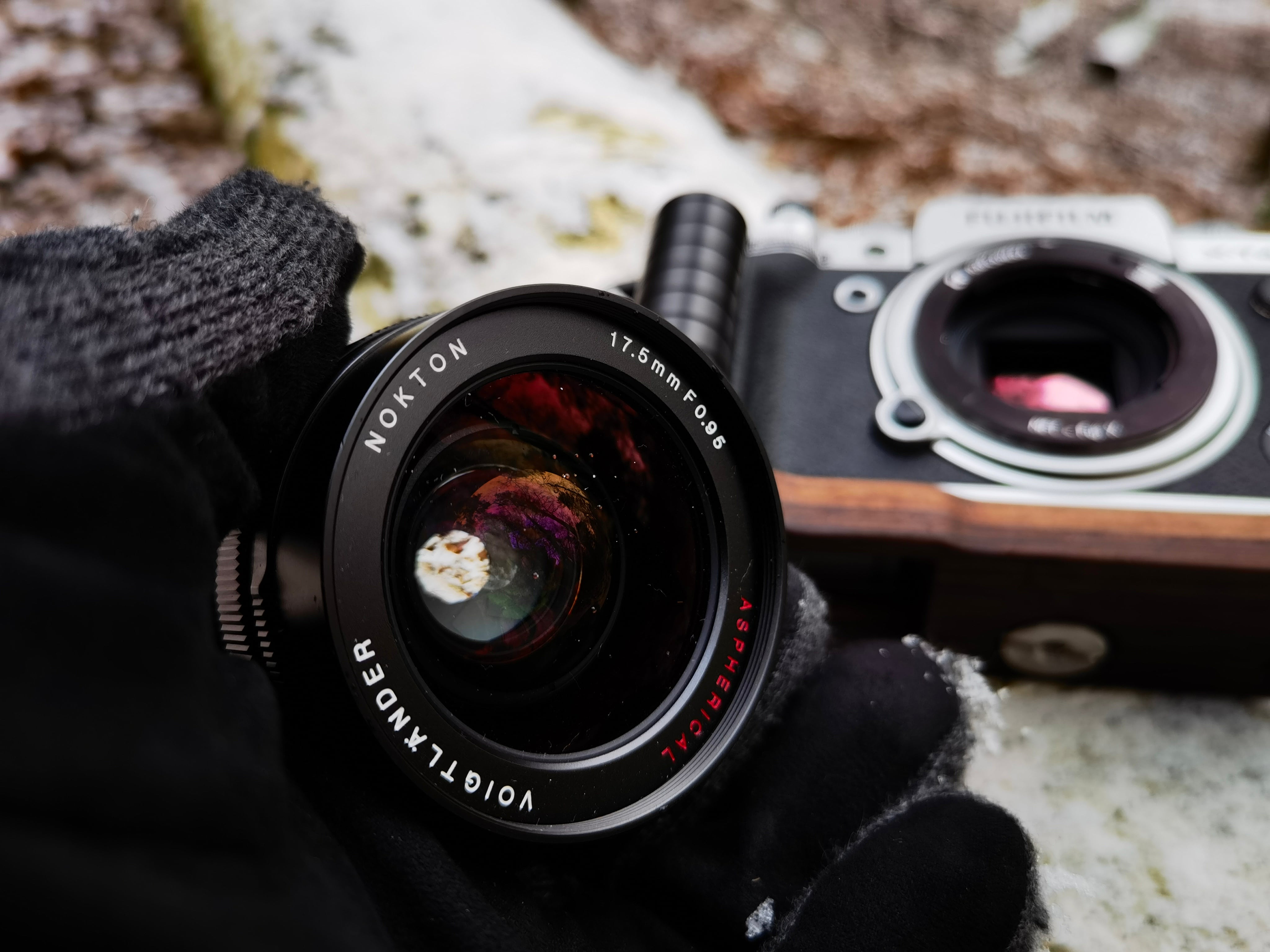

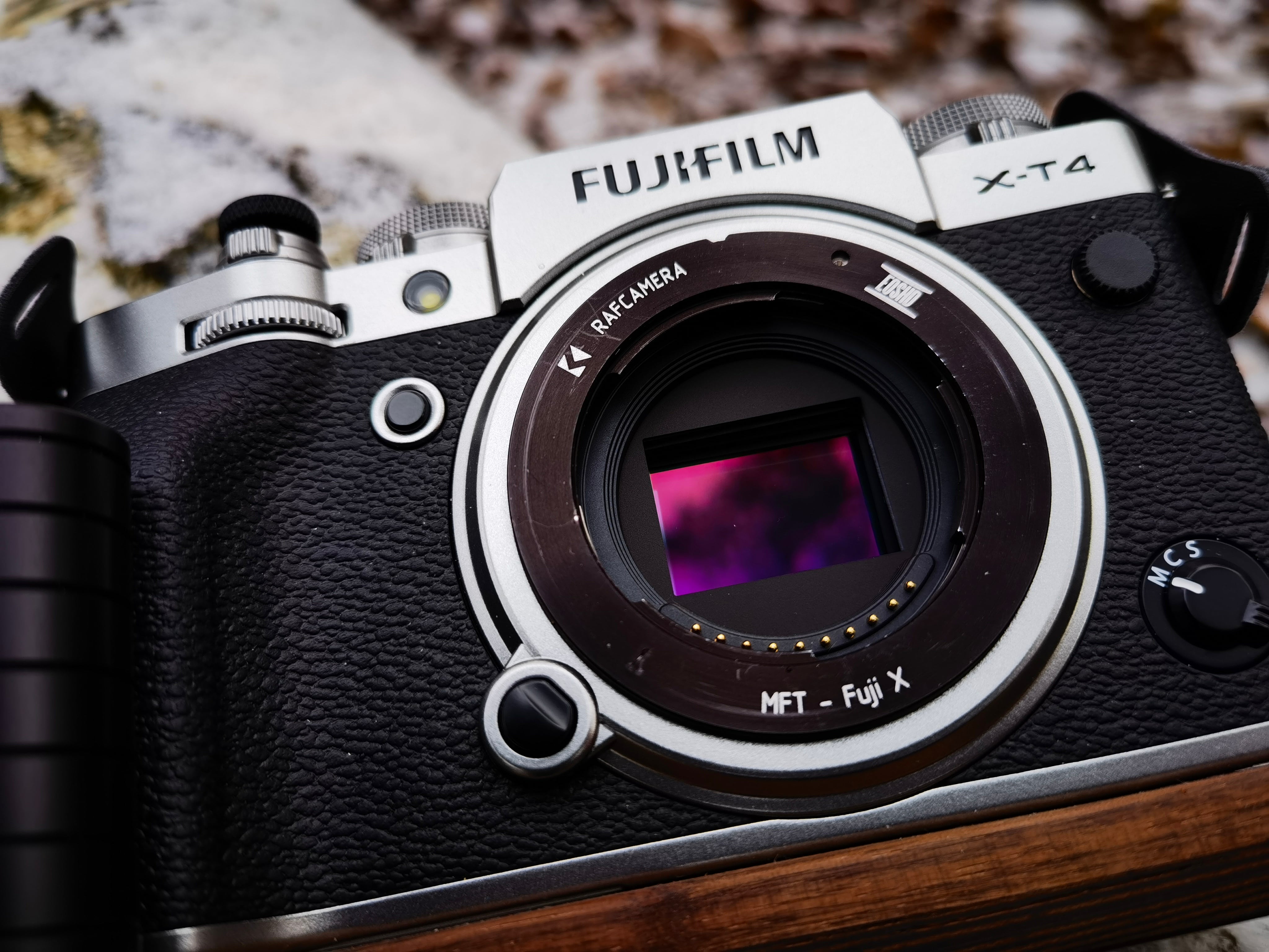

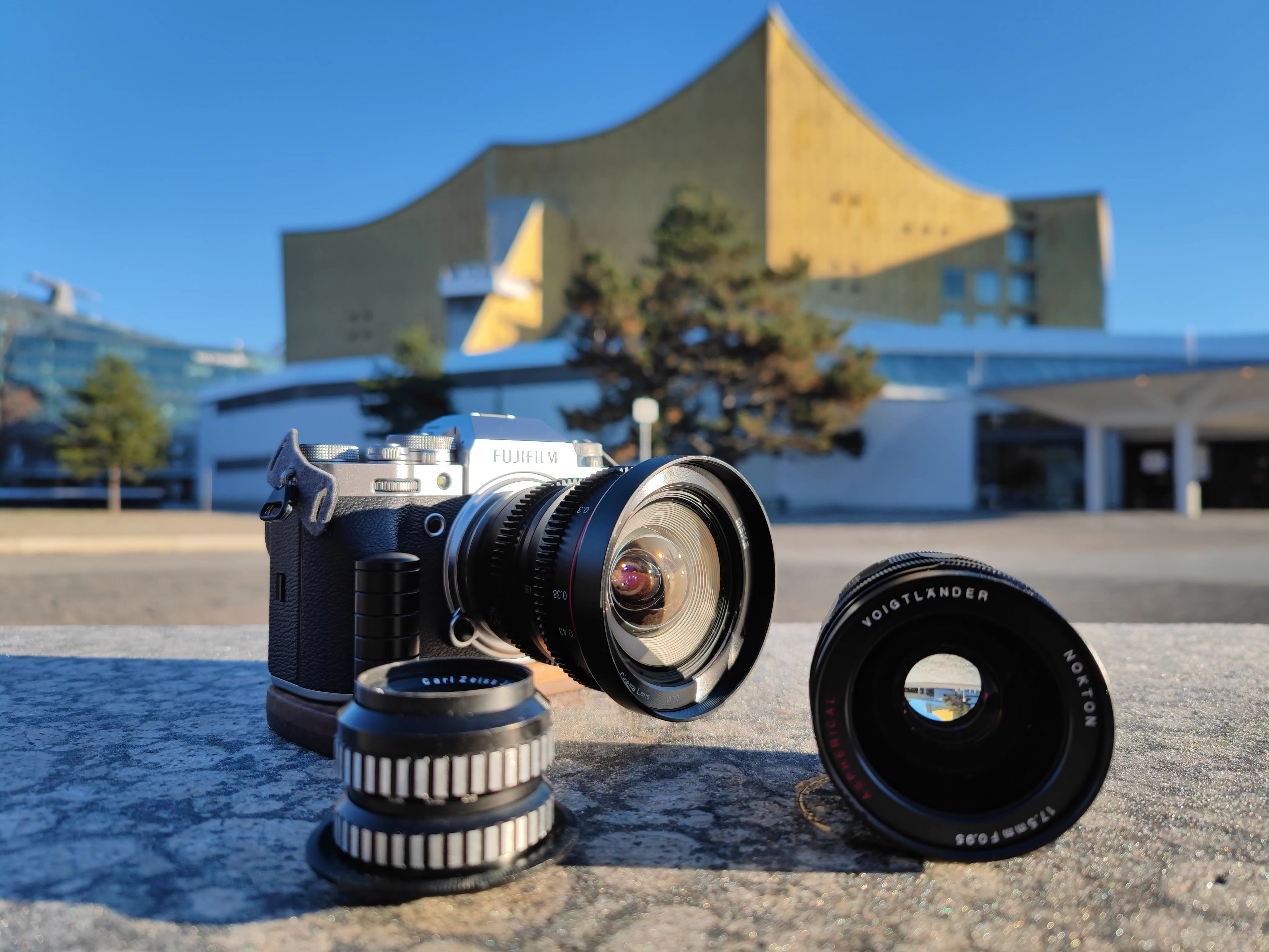

Administrators Popular Post Andrew - EOSHD Posted August 19, 2022 Administrators Popular Post Share Posted August 19, 2022 I remember @Emanuel raising the possibility of using Micro Four Thirds glass on Fuji cameras. Well I asked RAF Camera to make a prototype for EOSHD and here it is. So in past year I have been experimenting with a lot of M43 glass on the Super 35mm sensor of the Fuji X series cameras. We see beyond the usual 2x crop image circle! Here's what I found: - X-T4 has a Micro Four Thirds 2x crop mode in the menus. So you can use anything on that, basically. - The adapter doesn't have any electronics capabilities (maybe later?) so I have only been trying manual focus lenses - Voigtlander super fast F0.95 primes look lovely on a Fuji! - Some M43 lenses even cover the entire Super 35mm sensor - X-H1 is 1.7x crop in 4K so that works well, as it is closer to the 1.86x crop of the GH2 or multi-aspect sensor Panasonic bodies - The affordable Meike cinema lenses work brilliantly as these are all Super 35mm lenses just different mounts (they come in Fuji X-mount versions and Micro Four Thirds, with same optics for both) - SLR Magic stuff very tasty with it especially on the X-T4 in 2x crop mode - Focus to infinity is fine (sometimes slightly over even) So I am wondering, how much interest would there be in an EOSHD branded adapter for Fuji X cameras, that enables you to use Micro Four Thirds glass? This is the only adapter in the world of this type. I have been wondering how many of you have both Micro Four Thirds mount glass and Fuji cameras, maybe you switched but didn't sell all your GH5 lenses? Maybe you are just curious to turn your X-T4 into a GH6? Or interested to discover the unique images made from one of your exotic Micro Four Thirds mount lens on an X-H2S? Also rather than buy separate lenses for Fuji and Panasonic you can use one set on both systems (as in Meike 25mm T2.2 for instance!) If there is enough interest in the adapter I'll put RAF on notice and finally start that Indiegogo up! billdoubleu, 92F, Martin Kuipers and 10 others 10 3 Link to comment Share on other sites More sharing options...

AndrieREC Posted August 26, 2024 Share Posted August 26, 2024 Hi everyone. I've been using the RAF Camera adapter with the X-H2S with a 17.5mm Voigtlander. I absolutely love the images this lens puts out. I had a bit of fear of missing out on not being able to use the MFT lens on my X Mount after switcing from BMPCC 4K, but the extra effort of mounting with the RAF adapter and cropping in post are worth it for the image quality this lens gives you. Is there any solution to getting an in-camera crop, like a custom crop? I don't think so, right? From what I read and digged all over the internet, you only get the 3:2 in 6.2K on X-H2s, 16:9 in 4K, 17:9 in DCI, right? Link to comment Share on other sites More sharing options...
