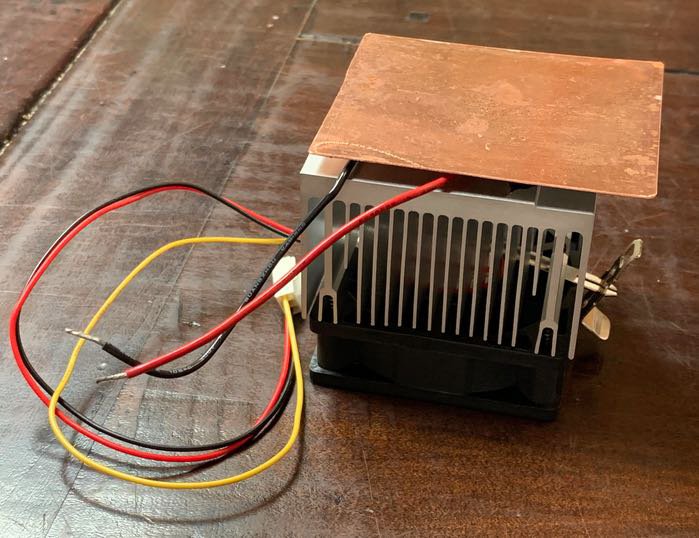

Electroholic Anonymous Posted August 25, 2020 Share Posted August 25, 2020 1 hour ago, Django said: The Tilta cooling system may work for all we know. The deep freeze experiment showed that the R5 timer Ā only seems to get triggered after a certain temp threshold. Ā ...Of course these latest findings prove we donāt even need an externalĀ cooling system to begin with! What deep freeze experiment? I missed that. I have built a Tilta freezer myself 3 weeks ago, and I can confidently state that based on my experiments, ramming 60W of power into a Peltier element, cooling the back of the R5 to -5 degrees Celsius, that it has ZERO impact on the overheating timer. See pictures of my crude but effective Peltier cooling system. The cooling works, the sensor is 5 to 10 degrees colder, the card slot around 10 degrees Celsius colder, but zero impact, at leat with this version 1.0.0 R5 firmware. The Tilta is a marketing creation, and drawn up by a technical drawing artist. Having worked a considerable part of my career as a hardware and software engineer for a telecom networking giant, this is my guess. I could be wrong, and that Canon and Tilta are working together and that Tilta has access to a newer firmware that does take temperature measurements into account. 11 minutes ago, Stanly said: Very odd indeed! Might beĀ last minute decision, or even part of plan to eventually "solve all issues" by the time camera truly ships. Ā This + the fact that @Andrew ReidĀ had to use a formatted card after every "reset" might point to camera reading the contents of the card with time stamps to know if there was an 8K / 4K HQ etc. recorded recently. Ā I wonder what happens if you record 8K until camera overheats in one R5, then insert the same card into a different R5 ... if the code is this flawed (quite possible, since it looks to be a last minute thing) ā the fresh R5 might think it is overheated without ever being powered on. Good suggestions, I also thought of that. However, I can rule this out based on my experiments. I am describing this in the description and first comment of my video. Sometimes, roughly 1 in 3 times, the card does not write fast enought after a sudden power interruption. The manual of the R5 specifically states to perform a low-level format when this happens, this is indeed effective. In the other cases that the card writes just fine after the power interruption, it gladly gives 15:00 for 8K RAW, every time. Andrew Reid 1 Link to comment Share on other sites More sharing options...
Electroholic Anonymous Posted August 25, 2020 Share Posted August 25, 2020 \ As is wrote above, despite 60W of Peltier cooling power supplied, with a copper heatspreader covering the whole back of the R5 behind the LCD screen and cooling it to -5 degrees Celsius, risking internal condensation, it has ZERO impact on the time I can record in 8K RAW, with my R5 with firmware v 1.0.0. I was willing to walk around with this ugly contraption if it would give me longer recording times. I need a full NP-F970 battery per hour for the maximum cooling. I doubt Tilta will apply that much cooling power. Hanriverprod, Matins 2, visionrouge and 2 others 2 1 1 1 Link to comment Share on other sites More sharing options...
Davos Posted August 25, 2020 Share Posted August 25, 2020 Peltier coolers are very very inefficient but as Andrew and others have shown any form of cooling is completely irrelevant to the recording times of the R5! The Tilta mock up appeared rather quickly and just gave the fan boys something to grasp onto and prolong the denial that Canon was actually shafting its customers. It's damning that owners have to resort to such measures - look at it how butt ugly that cooler is! Just fix the damn camera Canon. You created this mess, you fix it. Link to comment Share on other sites More sharing options...
