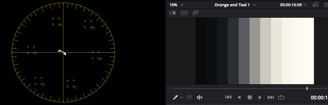

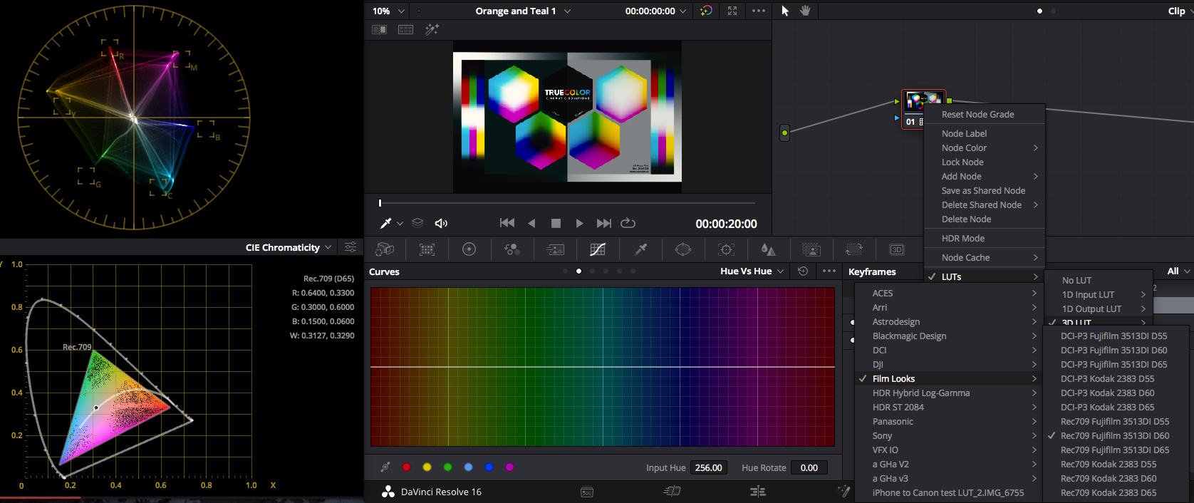

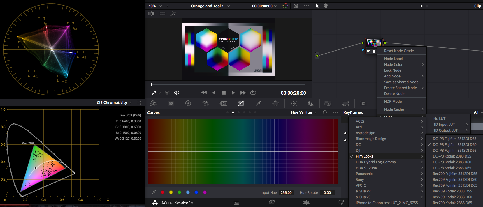

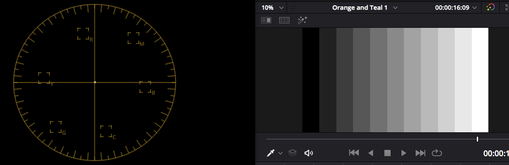

kye Posted December 29, 2019 Author Share Posted December 29, 2019 Let's start with film emulation. Resolve comes with a bunch of Film Emulation LUTs, let's play with the Kodak 2383 D60 LUT. Firstly, here's a greyscale to see what it does to luminance: The first is unprocessed, and so has nothing on the vectorscope as there is no colour. The second clearly shows that there is a push towards orange in the highlights, and a push towards teal in the shadows. If we change to a smoother gradient and zoom into the vectorscope further (by saturating the image hugely), we get this: From this we can see that it saturates the upper and lower mids more than the highlights and shadows, and that it isn't a straight application of two hues, but the hue varies. If we crop out the highlights and shadows in order to confirm which bits of the image are which bits in the vectorscope then this is what we get: Which confirms that the 'hook' parts of the vectorscope were the highlights and shadows. So there are changes in saturation and also hue applied to greyscale tones, but this is the OT look in this film stock. I suggested to the guys on LiftGammaGain that the film emulations in Resolve must be pretty good and was met with skepticism, however, if we assume that any lack of rigour on the part of the person creating these LUTs would tend towards making them overly simplistic rather than overly complex (a relatively safe assumption, but one all the same) then that suggests that this type of non-linear application of tint is likely in film stocks. So, what does this LUT do to colour? This is a very handy LUT stress-test image courtesy of TrueColor.us: Before image shows that the test image has hues that are in-line with the primary reference markers on the vectorscope, and that all the lines are straight, indicating there is also equal saturation of the image. After image shows a number of interesting things: The most saturated areas of the image are reduced saturation but the mid-levels of saturation are increased, giving a non-linear saturation response that would tend to increase saturation in the image without clipping things, very nice but not relevant to the OT look In terms of relative saturation, the Yellows are the most saturated, Cyan is next most saturated, Red and Magenta are in the middle of the range, and Blue and Green are the least saturated In terms of Hue, Cyan got pushed towards blue a bit, Yellow got pushed a bit orange, Magenta got pushed a little red, and RGB seemed unaffected @Juan Melara made an excellent video re-creating this LUT (he did the D65 version, which has a warmer white-point, but the overall look should be the same): The video is interesting as he uses a range of techniques that apply OT elements to the image: He uses a set of curves which apply a cooler tint to the shadows and a warmer tint to the highlights, and by having different curves for the Red and Green channel, gets some Hue variation across that range too Then there's a Hue vs Sat curve that saturates Yellow and Cyan above the other hues: Then a Hue vs Hue curve that pushes Yellow slightly towards Orange, Green towards Cyan, and Blue towards Cyan (up in the graph pushes colours left on the rainbow in the background of the chart): Then he has two YUV nodes each with a separate Key that are too complicated to explain easily here, but affect both the hue and saturation of the colours in the image. Juan also has the Resolve Powergrade available for download for free on his website, so check it out: https://juanmelara.com.au it's in his store, but it's free. So film tends to have elements of OT. Here are some additional film emulation LUTs in Resolve for comparison - note that all of them have Yellow and Cyan as the most saturated primaries.. EthanAlexander and heart0less 2 Link to comment Share on other sites More sharing options...

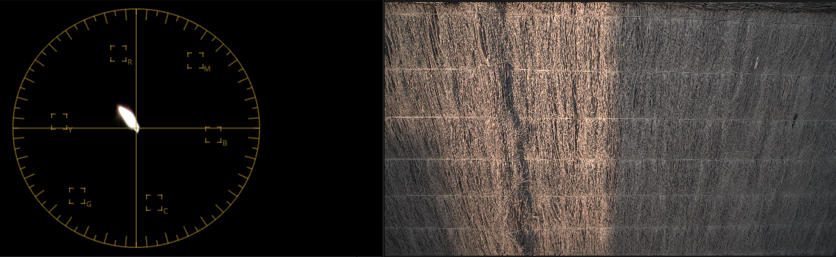

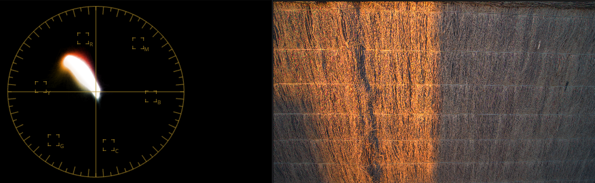

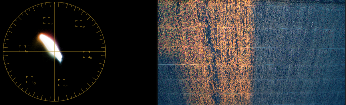

kye Posted January 3, 2020 Author Share Posted January 3, 2020 Thanks to a nice sunset, I took a few RAW photos that are interesting. Here's the first one - sunlight and shade on the fence (which is made of small sticks). The image looks fairly neutral, if perhaps a little warm. In realty the sticks are pretty neutral, doing the silvering that weathered wood tends towards. If we apply some OTT saturation for diagnostic purposes, we get this: That looks fine, not counting the over-saturation, but is well within the colour palette of cinema. If I shift the WB a little towards "neutral" and put some colour in the shadows then this is what we get. You'll note from the vectorscope that this has had a slightly non-linear effect (I did this adjustment with the Offset control in the first node, so not sure why it would do that) but I don't think it takes us too far from reality: So, this is the natural colours created when the suns light is scattered by the atmosphere, which is why sunsets are orange/red/purple and the sky is blue. The sun is a pretty good approximation of a source of full-spectrum black-body radiation: https://lco.global/spacebook/light/black-body-radiation/ https://en.wikipedia.org/wiki/Black-body_radiation There appears to be a spectrum from Blue to Red that objects follow, depending on their colour temperature. Here's a chart showing the colour temperature of various stars for example: As all of these are sources of broad spectrum radiation they all kind of act the same in terms of rendering colour, also including incandescent light globes and fire. Here's the spectrum of an incandescent light globe: and I suspect that fire is broadly the same. We didn't really get different coloured light sources until we started messing with chemistry and making things like fluoresce, like this fluorescent light: So, the Orange / Teal look occurs in nature, and I presume we attach some kind of psychological sense of well-being from times we spent with other folks around a fire, being both warm and (relatively) safe. Link to comment Share on other sites More sharing options...
