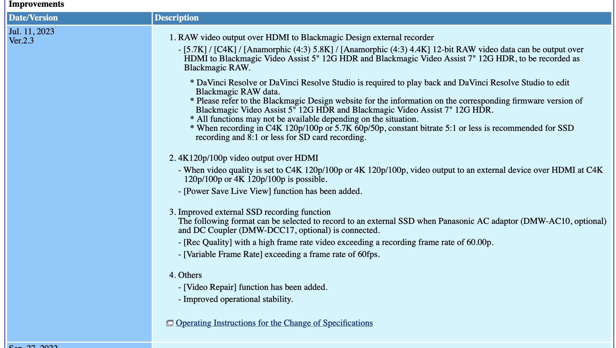

John Matthews Posted July 11, 2023 Share Posted July 11, 2023 Panasonic just released firmware 2.3. In it, there are various things. I'd be interested in knowing some thoughts of users. I feel like it's a bigger update than they previously said. Link to comment Share on other sites More sharing options...
John Matthews Posted July 11, 2023 Share Posted July 11, 2023 I feel like there's a little less delay when making short sequential clips. There's a little more delay on the first clip, but it seems to start and stop a little better. Does anyone else have that impression? Link to comment Share on other sites More sharing options...
kye Posted July 12, 2023 Author Share Posted July 12, 2023 12 hours ago, John Matthews said: Panasonic just released firmware 2.3. In it, there are various things. I'd be interested in knowing some thoughts of users. I feel like it's a bigger update than they previously said. Not a user, but having RAW 5.7K60 and C4K120 and 4.4K anamorphic seems a lot like it's now in cinema camera territory. Things like the ability of RED cameras to have RAW at high frame rates was one of the things that I thought separated them from the usual prosumer cameras that mere mortals like I could afford. Maybe I'm just behind the times, but if you were shooting something serious like high-end music videos / high-end docs / low-budget features and had the ability for 5.7K up to 60p (for those emotional/surreal moments) and also C4K 120p for any special effects shots (like if shooting an emotional sports doco) then it makes it a serious camera for those tasks. John Matthews and PannySVHS 2 Link to comment Share on other sites More sharing options...
John Matthews Posted July 12, 2023 Share Posted July 12, 2023 5 hours ago, kye said: Not a user, but having RAW 5.7K60 and C4K120 and 4.4K anamorphic seems a lot like it's now in cinema camera territory. Things like the ability of RED cameras to have RAW at high frame rates was one of the things that I thought separated them from the usual prosumer cameras that mere mortals like I could afford. Maybe I'm just behind the times, but if you were shooting something serious like high-end music videos / high-end docs / low-budget features and had the ability for 5.7K up to 60p (for those emotional/surreal moments) and also C4K 120p for any special effects shots (like if shooting an emotional sports doco) then it makes it a serious camera for those tasks. It's WAY more than what I need! I would have probably purchased a G9 hadn't it been for the ridiculously low price, new, with 3 year warranty for a flagship product. I have absolutely no need for it other than creativity. I'm going to watch the Lumix live stream tomorrow as I think they'll say something. Still, the bigger feature for me is the high frame rates on an external SSD. PannySVHS and kye 2 Link to comment Share on other sites More sharing options...
