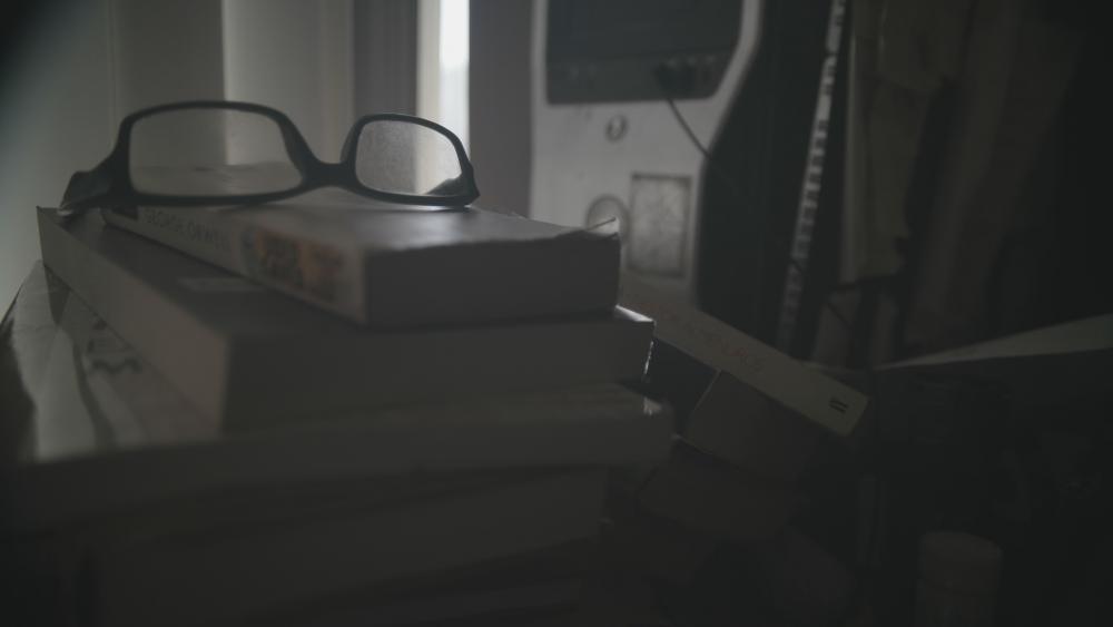

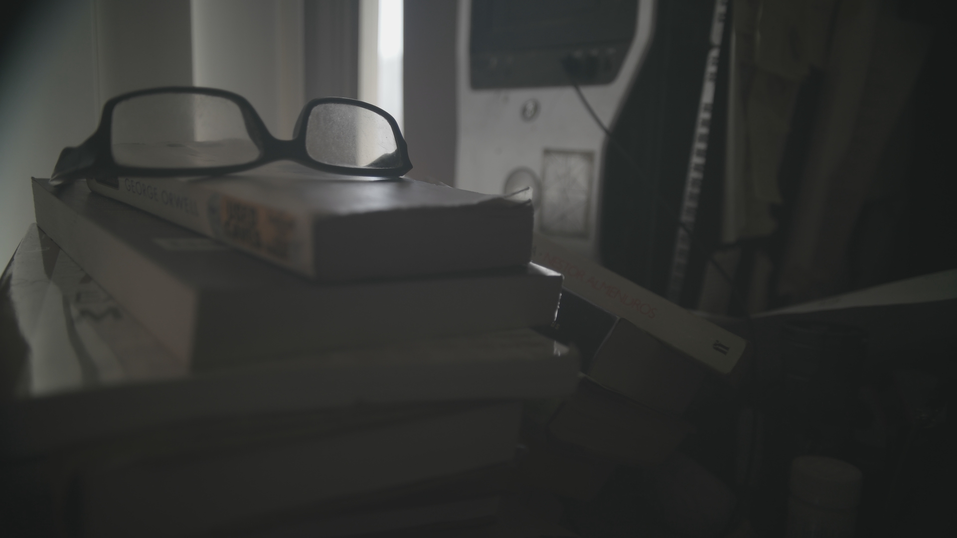

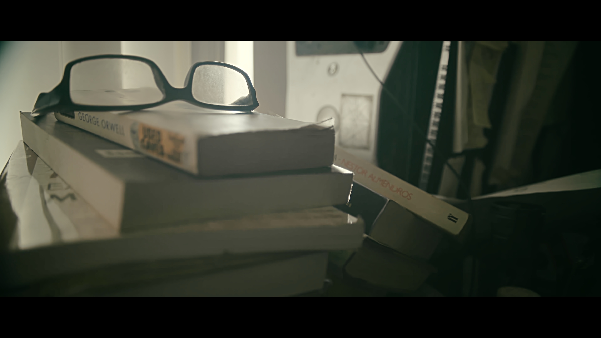

Happy Daze Posted March 29, 2018 Share Posted March 29, 2018 I have lately been experimenting with video capture settings on the NX1 and I have been exploring a method of increasing dynamic range which I don't think has yet been touched upon. It's really no big deal and I am not making any great claims but it may be of interest to some so I produced a quick video How-To. Take is as fun, I have done very little real-world testing and it may be of little use, but over to you. Francesco Tasselli, lucabutera, ShapDaddy and 4 others 7 Link to comment Share on other sites More sharing options...

Happy Daze Posted March 30, 2018 Author Share Posted March 30, 2018 I have just had a chance to test outside. It's very overcast so contrast between ground and sky is wide. What I have noticed is that the highlights are still clipping but at a lower level than with standard exposure which seems to fail the process. BUT.... Try turning the colour controls in the profile to a POSITIVE figure +1.20/1.30 (or whatever) and then use negative exposure compensation to protect the highlights. This give a smoother curve than both the first method and standard exposure. The shadows appear brighter whilst the highlights don't appear to burn and the scopes look smooth. There might be a sweet spot somewhere, so I am going to carry on playing for a while. Link to comment Share on other sites More sharing options...
Happy Daze Posted March 30, 2018 Author Share Posted March 30, 2018 Method 2 is producing some surprising results indoors. Just for fun turn the color in the profile to full 1.99 on all 3 colours. Now use a negative exposure comp to bring the scene to the same level as would be the standard exposure profile. The ISO for capture is much lower and the noise is much less using the custom method compared to standard exposure. Anyone else? Matthias Scheja 1 Link to comment Share on other sites More sharing options...
Happy Daze Posted March 30, 2018 Author Share Posted March 30, 2018 OK, so I strongly believe that you can gain an extra whole stop in low light by using method 2. Profile settings: color R G B +1.99, contrast -5, Saturation -1, Sharpness -10 (the contrast, saturation & sharpness are to taste but I find the contrast at -5 produces flatter more realistic results). Once you set the profile you can achieve a similar exposure to standard by using negative -1 exposure compensation. Note how the ISO drops as a result of the negative exposure compensation yet when scenes from standard and this custom profile are compared there do not appear to be any disadvantages just lower noise! Obviously you will need to adjust exposure compensation for different scenes to protect the whites as much as you probably would in standard exposure but you will need around an extra stop of negative exposure using this profile.. Next to test externally. Matthias Scheja and iam_andy 2 Link to comment Share on other sites More sharing options...
Happy Daze Posted March 30, 2018 Author Share Posted March 30, 2018 Testing outside using the new profile, it's very overcast here at the moment, I found my self switching between negative 1.0 and 1.3, but compared to the same scene with Picture Wizard off there is more dynamic range. Also there is at least 1 stop more to be gained which could prove invaluable in failing light. I hope that you test this and share your results. I have not tried adjusting any other settings which I have left at standard. This may also work for the gamma DR profile as well, more tests are needed. I will be using this profile for the next few weeks just to see if it is reliable. Matthias Scheja, Kisaha, iam_andy and 1 other 4 Link to comment Share on other sites More sharing options...

IKSLIM Posted April 1, 2018 Share Posted April 1, 2018 On 3/30/2018 at 3:20 PM, Happy Daze said: Method 2 is producing some surprising results indoors. Just for fun turn the color in the profile to full 1.99 on all 3 colours. Now use a negative exposure comp to bring the scene to the same level as would be the standard exposure profile. The ISO for capture is much lower and the noise is much less using the custom method compared to standard exposure. Anyone else? Man You made my day!! Your trick with colour boost is simply one of THE BEST tricks with NX1 i ever tried! RESPECT TO YOU MAN! I can definitely see less contrasty curve in a more pleasant way. On top of that EXTRA STOP, which is additional bonus! I double checked with Manual Mode (M) also: it works the same way, for both: video and photo also (jpeg definitely).. There is a bit of colour change in miner, but, all together makes picture more pleasant to my eye. RESPECT TO YOU MAN! and thanks for such a great trick discovered…. The same as you, i will try to shoot at least a project with "Colour Boost" profile to report wether or not.... Link to comment Share on other sites More sharing options...
Kisaha Posted April 1, 2018 Share Posted April 1, 2018 1 hour ago, IKSLIM said: Man You made my day!! Your trick with colour boost is simply one of THE BEST tricks with NX1 i ever tried! RESPECT TO YOU MAN! I can definitely see less contrasty curve in a more pleasant way. On top of that EXTRA STOP, which is additional bonus! I double checked with Manual Mode (M) also: it works the same way, for both: video and photo also (jpeg definitely).. There is a bit of colour change in miner, but, all together makes picture more pleasant to my eye. RESPECT TO YOU MAN! and thanks for such a great trick discovered…. The same as you, i will try to shoot at least a project with "Colour Boost" profile to report wether or not.... Can you explain the workflow a bit more? I am not clearly understanding what is going on here! I use only M for video, what is the workflow for that? Link to comment Share on other sites More sharing options...
IKSLIM Posted April 1, 2018 Share Posted April 1, 2018 8 hours ago, Kisaha said: Can you explain the workflow a bit more? I am not clearly understanding what is going on here! I use only M for video, what is the workflow for that? Just boost R G B colors to max (sounds creasy but it works) in custom1 picrure profile. Everything else left untouched. You will see it strait... Kisaha 1 Link to comment Share on other sites More sharing options...
IKSLIM Posted April 1, 2018 Share Posted April 1, 2018 I’m thinking on RGB trick discovered: As far as i understand Samsung RGB logic (realised in PictureProfile tuning) - it is the middle point of a curve. Thus, when we rise all three together, we make picture brighter and less contrasty without touching exposure (ISO). I can report: i have very nice improvement with boosting BlackLevel up to +15 on top of new RGB boost, + Expose Compensation - 2. I can strongly recommend ALL NX1 users to experiment with RGB boost… Matthias Scheja 1 Link to comment Share on other sites More sharing options...
Happy Daze Posted April 1, 2018 Author Share Posted April 1, 2018 1 hour ago, IKSLIM said: I’m thinking on RGB trick discovered: As far as i understand Samsung RGB logic (realised in PictureProfile tuning) - it is the middle point of a curve. Thus, when we rise all three together, we make picture brighter and less contrasty without touching exposure (ISO). I can report: i have very nice improvement with boosting BlackLevel up to +15 on top of new RGB boost, + Expose Compensation - 2. I can strongly recommend ALL NX1 users to experiment with RGB boost… Very pleased that you like the discovery. It may be my imagination but I am also noticing an improvement in auto-focus speed/accuracy and a reduction in cadence. The colours for me are a definite improvement and there is most surely an improved dynamic range. A much more pleasing picture in many respects. I feel like I have new camera, weird!!?? The exposure compensation varies with lighting conditions, but I do find that -5 contrast is also quite flattering. Cheers, Paul. Link to comment Share on other sites More sharing options...
