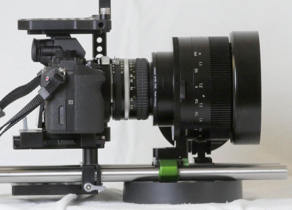

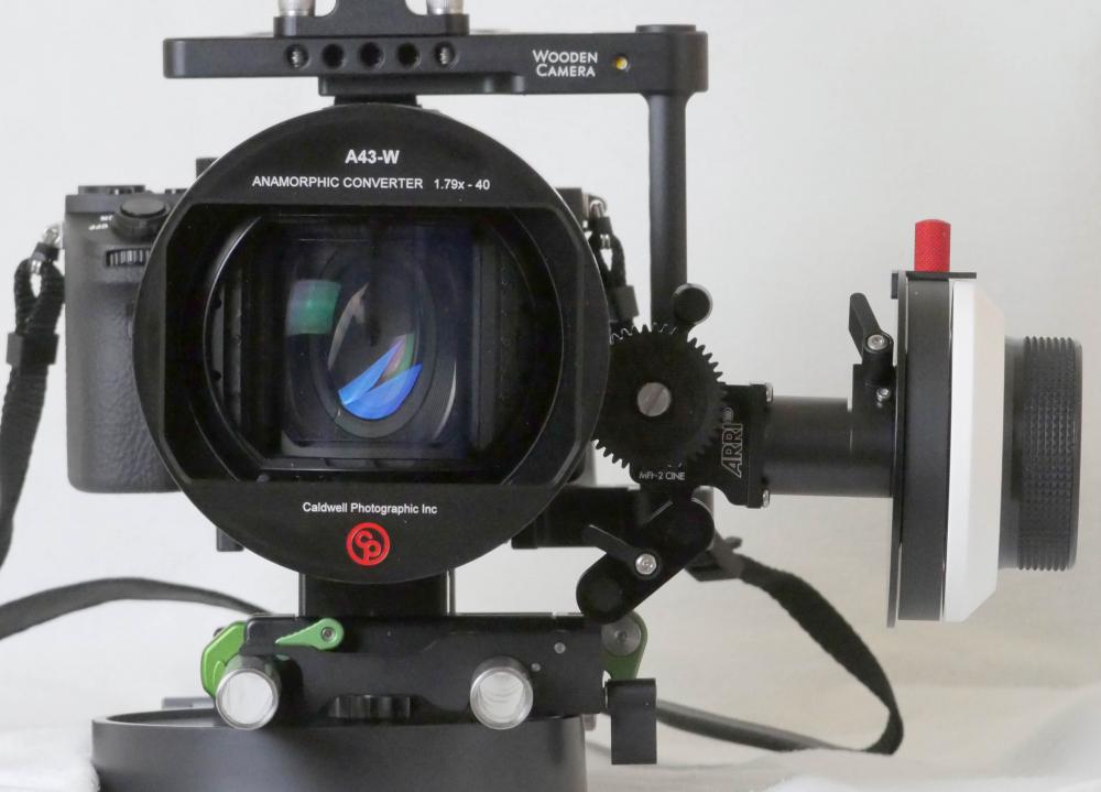

Popular Post Brian Caldwell Posted January 14, 2018 Author Popular Post Share Posted January 14, 2018 7 hours ago, Cinegain said: Would love to see a Metabones single focus anamorphic adapter in one way or another. Veydra had looked into it, but weren't sure where Panasonic would go with the next gen sensor specs. I've built prototypes of an iscorama-style single-focus adapter, but its really only suitable for shorter focal lengths in the 35mm to 75mm range. Also, its a bit large, and the front element moves during focusing, which may cause some issues with matte boxes. I'm also building a second type better suited for longer focal lengths in the 75 to 200mm range. I'm still debating whether to modify these for internal focusing, which would be good for heavy-duty cine use, but would make the adapters larger, heavier, and more expensive. To be honest, I've put the adapter project on hold until I get a few focal lengths in my anamorphic prime series completed. Georgios, maxmizer, elgabogomez and 8 others 11 Link to comment Share on other sites More sharing options...

IronFilm Posted January 14, 2018 Share Posted January 14, 2018 Heresy! Posting pics of an a7 series camera in a GH5S thread Orangenz and bzpop 2 Link to comment Share on other sites More sharing options...
