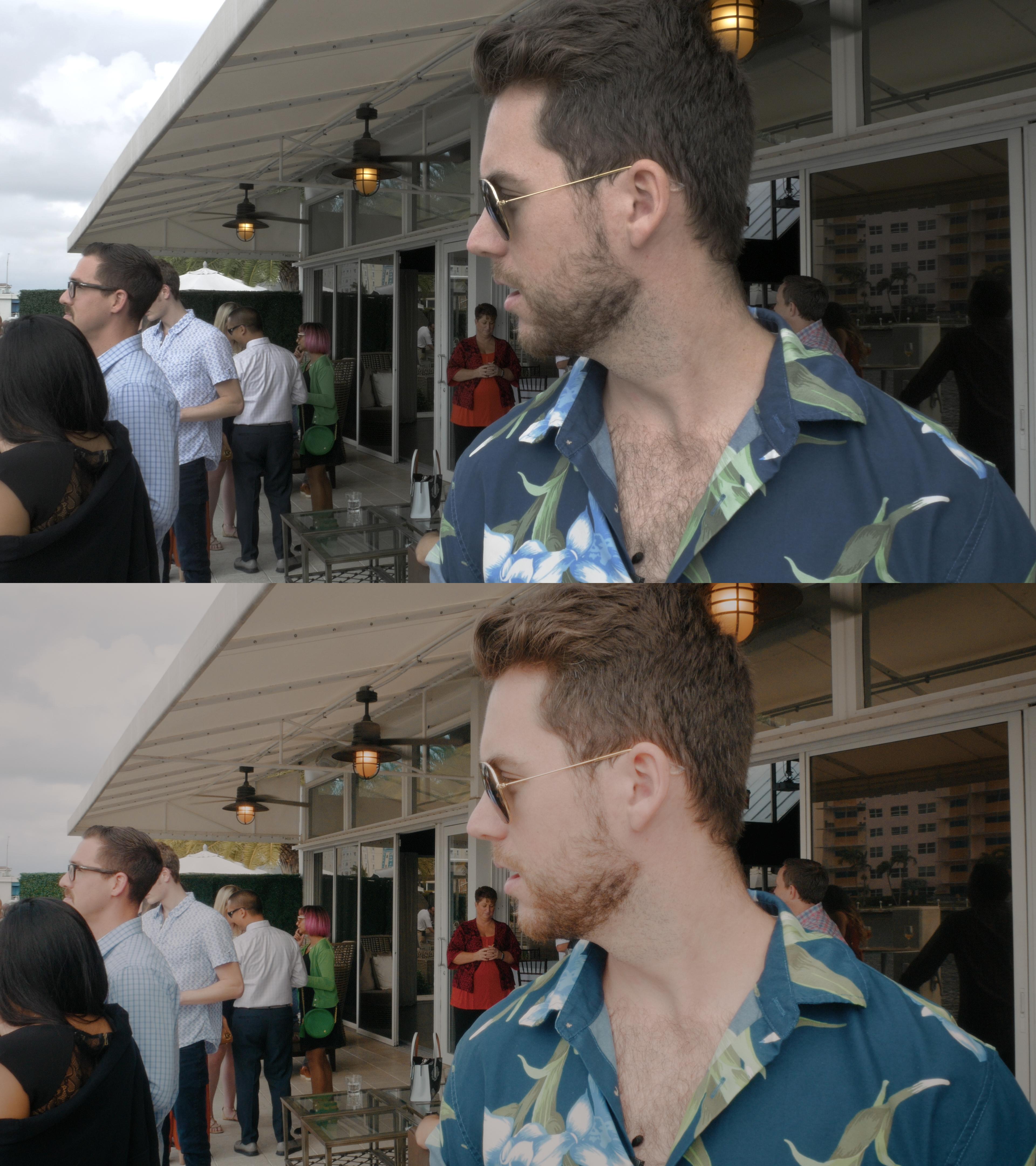

katlis Posted December 3, 2018 Share Posted December 3, 2018 I've been carrying around my little GX85 w/ Oly pancake zoom more often for casual photography, and the occasional impromptu video. Who needs a "Pocket 4K" when you can have a Pocket Alexa! ? But really, it fits in my pocket. Bottom screen grab has GHAlex with some additional grading. It works miracles on this "hacked" Cine-D at like f/20. Link to comment Share on other sites More sharing options...
Sage Posted December 3, 2018 Author Share Posted December 3, 2018 @katlis Perhaps one day I'll support the GX85 directly; that will tighten things up considerably! Looks good I'm doing a deep dive into html/css at the moment, and filming this weekend Link to comment Share on other sites More sharing options...

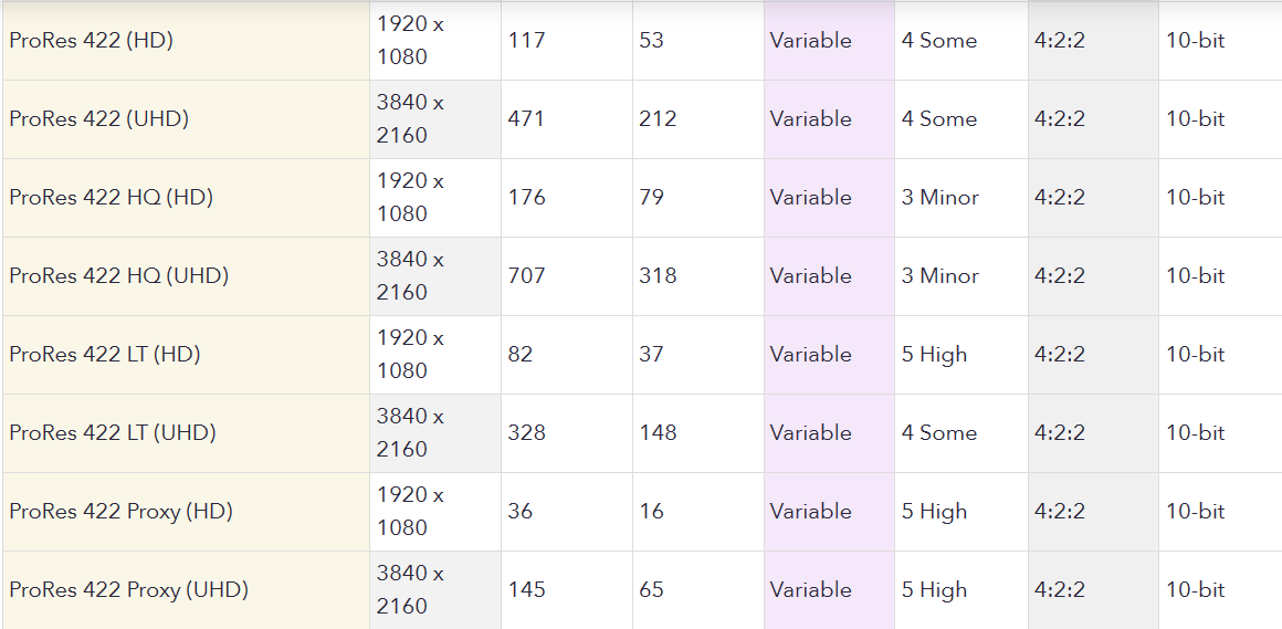

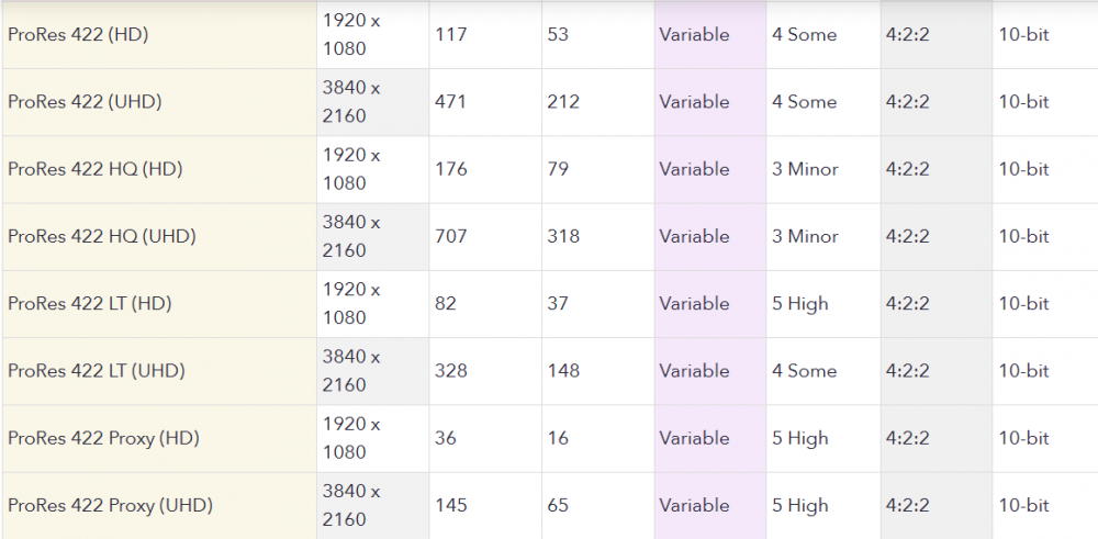

mirekti Posted December 4, 2018 Share Posted December 4, 2018 @Sage What codecs are you using? At the moment I am using Atomos with DNxHD, and might switch to ProRes as it offers 10 bit recording for all of their offered codecs in Atomos. I was thinking of using ProRes LT, but not sure how aggressive you LUT actually is. Should I rather go with 422? Atoms has these options (HQ, 422, LT). Link to comment Share on other sites More sharing options...
Sage Posted December 4, 2018 Author Share Posted December 4, 2018 30 minutes ago, mirekti said: @Sage What codecs are you using? At the moment I am using Atomos with DNxHD, and might switch to ProRes as it offers 10 bit recording for all of their offered codecs in Atomos. I was thinking of using ProRes LT, but not sure how aggressive you LUT actually is. Should I rather go with 422? Atoms has these options (HQ, 422, LT). I would use HQ myself (which is still a touch soft). GHa v3 will be transparent to the material (no need to worry about teasing apart macroblocks etc) deezid 1 Link to comment Share on other sites More sharing options...
dia3olik Posted December 4, 2018 Share Posted December 4, 2018 1 minute ago, Sage said: I would use HQ myself (which is still a touch soft). do you mean soft VS uncompressed vid coming off the hdmi or VS the best quality option of DNX inside the Atomos? Link to comment Share on other sites More sharing options...
Sage Posted December 4, 2018 Author Share Posted December 4, 2018 1 minute ago, dia3olik said: do you mean soft VS uncompressed vid coming off the hdmi or VS the best quality option of DNX inside the Atomos? Back a few years, there was a comparison of the various flavors of mezzanine codecs against raw, and they all softened the image. They had a filmic quality (inherently soft), and I quite liked it, though that's why I opt for at least 200mbps with a 2K intraframe codec Link to comment Share on other sites More sharing options...
Wild Ranger Posted December 4, 2018 Share Posted December 4, 2018 Hello everyone! I'm been working in several projects lately, here i wanted to to show some still of a new short film i shot last week. The final look will be in black & white, but here i will put some stills in color with V3 and my grade. Also some Vlog stills. Vlog: ade towell, mercer, jase and 3 others 6 Link to comment Share on other sites More sharing options...
mirekti Posted December 4, 2018 Share Posted December 4, 2018 21 minutes ago, Sage said: at least 200mbps with a 2K intraframe codec Third column is Mb/s for 24p. Taken from: https://blog.frame.io/2017/02/13/50-intermediate-codecs-compared/ Link to comment Share on other sites More sharing options...
