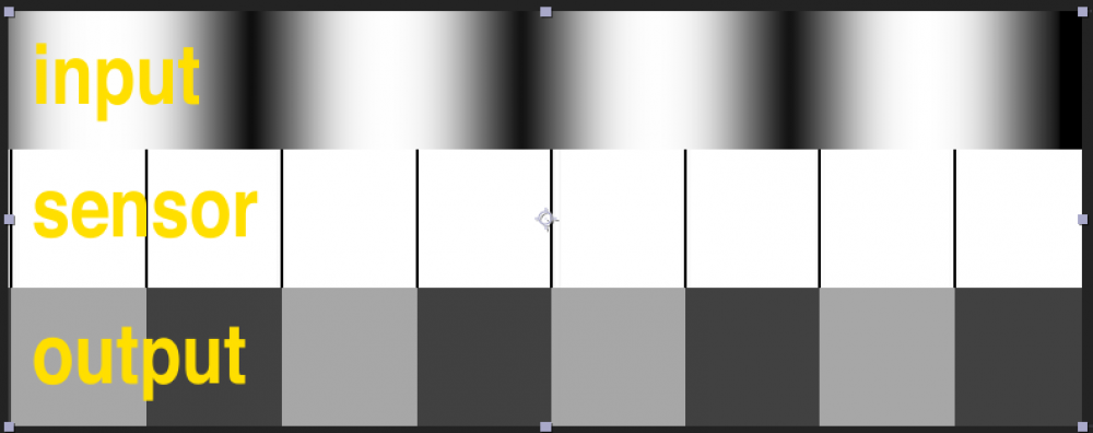

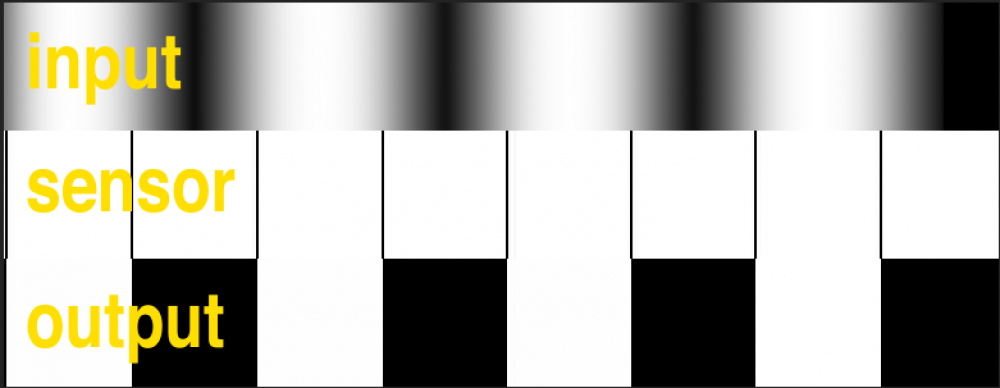

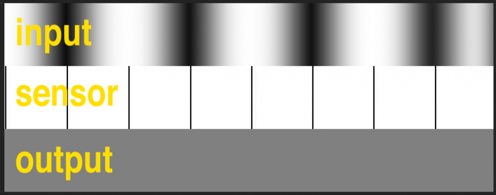

HockeyFan12 Posted July 26, 2017 Share Posted July 26, 2017 6 hours ago, jcs said: Maybe the FS700 isn't on the list because of aliasing and chroma artifacts, and perhaps skintone color science isn't up to the other cameras? Might also be related to having to use 3rd party devices to get 4K. While we were able to get decent skintones and color from the FS700 (and the slomo was great), it was hit or miss, and so we went back to Canon when we acquired our next professional-level camera: C300 II instead of FS7. While the FS7 has improved color science and overall image quality compared to the FS700, the C300 II still has nicer skin tones with less effort. Even if the FS7 had matching image/color quality, C300 II still wins for native EF lens support and usable AF. With the C300 II set up with ARRI settings, ARRI LUTs can be used and it's like using an Alexa with AF! Is the Alexa still superior in DR and total image quality- absolutely, even though the C300 II is "4K" (which it really isn't- it's less than 4K and aliases!). If Netflix really wanted to make this about 4K quality, they'd base the decision on shooting a 4K test chart. How many professional cameras actually produce a real, measurable, alias-free 4K image? Sony F65 ("8K") Red ("6/7/8K")? Alexa 65 (6.6K)? Pre Nyquist Sampling Theory, we need 2x oversampling to fully capture a signal without aliasing. Along with an optical low-pass filter, it might be possible to get 'close enough' so aliasing is minimal/not visible with less than 2x oversampling, so a test chart is helpful. Here the F65 rules (and maybe Red at 7K; only a 1080p output was provided): So how does the Alexa 65 compare to the F65 and Red shooting a 4K test chart? The only camera I would put in the same league as the Alexa for color and overall look for skin is the F65 based on high-end Hollywood movies. I suspect the Alexa may be much easier to achieve great skintones and that's why the F65 isn't used as often for high-end productions (and the insane data rate of the F65). If Netflix didn't have this 4K requirement, it would probably be dominated by Alexas, which isn't good for competition, so that's a plus in a sense (Alexa 65 is very expensive and rental only). The C200 420 8-bit 4K won't qualify since it's not 10-bit. The 4K raw should qualify if it's log-encode (otherwise must be 16-bit linear to qualify), though it's not true 4K either- not enough photosites and both it and the C700 alias in 4K. What about the GH5 4K 10-bit? Would be interesting to see how it does on the same 4K test chart / conditions Geoff Boyle is shooting. There's a wide-ranging misunderstanding of Nyquist sampling theory when it comes to images, and I think you might be following that widely-publicized misunderstanding. If not, my apologizes but I think it's such an interesting topic (which I was totally wrong about for years) that I will butt in: Nyquist does not apply to image sensors how many people think it does. A 4k sensor actually CAN resolve a full 4K (well, technically anything less than 4k so 99.99%) signal, and fully. It's only Bayer interpolation and the presence of anti-aliasing filters that reduces this number in a meaningful way. What it boils down to is that a line pair represents a full signal wave. Yes, you can only fully capture less than 2048 line pairs in 4k without aliasing, as per Nyquist. But that's still 4096 lines. So... with a Foveon or monochrome sensor you can capture full 4k with no aliasing on a 4k sensor. Really! You can! (Assuming you also have a high pass filter with 100% mtf below 4k and 0% mtf above 4k. Which... doesn't exist... but still.) The other point of confusion is the idea that a line pair on a normal resolution chart represents a sine wave. It doesn't. And THAT is 99% of the reason why there's aliasing on all these test charts. It represents a sawtooth wave, which has infinitely high overtones. So mtf should be measured with a sinusoidal zone plate only, as the Nyquist theorem applies to sine waves specifically (well, it applies to anything, but sawtooth waves are effectively of infinite frequency because they contain infinite high odd order harmonics). Since most resolution charts are lines–sawtooth–waves, rather than sinusoidal gradients, even the lowest resolution lines are actually of effectively infinite frequency. Which might be another reason why you see such poorly reconstructed lines and false colors around the very high contrast areas of the window in Yedlin's test in the other thread. To that extent, the use of anti-aliasing filters is more just "whatever works" for a given camera to split the difference between sharpness and aliasing, and not correlated with Nyquist in any specific way. Bayer patterns I believe remove a little less than 30% of linear resolution, but in practice it looks a lot sharper than 70% sharpness due to advanced algorithms and due to aliasing providing the illusion of resolution... So the resolution issue requiring over-sampling is due to anti-aliasing filters and Bayer pattern sensors and balancing things out between them so you get a sharp enough image with low enough aliasing. It's not Nyquist eating half your spatial resolution. I'm no engineer by any means and I have made this mistake in the past and now feel guilty for spreading misinformation online. Also, I'm normally an 8-bit-is-fine-for-me-and-probably-for-everyone type person, but for next generation HDR wide gamut content you need 10 bit color and a wide gamut sensor. I think Netflix is going for a future proof thing and perhaps it is due to legal. That is a very astute comment. It's not an aesthetic choice, but a legal one. Otherwise, anything could be called "true 4k." (Fwiw you can include small amounts of b cam footage shot on other cameras or even stock footage.) IronFilm and maxotics 2 Link to comment Share on other sites More sharing options...

jcs Posted July 26, 2017 Share Posted July 26, 2017 1 hour ago, HockeyFan12 said: There's a wide-ranging misunderstanding of Nyquist sampling theory when it comes to images, and I think you might be following that widely-publicized misunderstanding. If not, my apologizes but I think it's such an interesting topic (which I was totally wrong about for years) that I will butt in: Nyquist does not apply to image sensors how many people think it does. A 4k sensor actually CAN resolve a full 4K (well, technically anything less than 4k so 99.99%) signal, and fully. It's only Bayer interpolation and the presence of anti-aliasing filters that reduces this number in a meaningful way. What it boils down to is that a line pair represents a full signal wave. Yes, you can only fully capture less than 2048 line pairs in 4k without aliasing, as per Nyquist. But that's still 4096 lines. So... with a Foveon or monochrome sensor you can capture full 4k with no aliasing on a 4k sensor. Really! You can! (Assuming you also have a high pass filter with 100% mtf below 4k and 0% mtf above 4k. Which... doesn't exist... but still.) The other point of confusion is the idea that a line pair on a normal resolution chart represents a sine wave. It doesn't. And THAT is 99% of the reason why there's aliasing on all these test charts. It represents a sawtooth wave, which has infinitely high overtones. So mtf should be measured with a sinusoidal zone plate only, as the Nyquist theorem applies to sine waves specifically (well, it applies to anything, but sawtooth waves are effectively of infinite frequency because they contain infinite high odd order harmonics). Since most resolution charts are lines–sawtooth–waves, rather than sinusoidal gradients, even the lowest resolution lines are actually of effectively infinite frequency. Which might be another reason why you see such poorly reconstructed lines and false colors around the very high contrast areas of the window in Yedlin's test in the other thread. To that extent, the use of anti-aliasing filters is more just "whatever works" for a given camera to split the difference between sharpness and aliasing, and not correlated with Nyquist in any specific way. Bayer patterns I believe remove a little less than 30% of linear resolution, but in practice it looks a lot sharper than 70% sharpness due to advanced algorithms and due to aliasing providing the illusion of resolution... So the resolution issue requiring over-sampling is due to anti-aliasing filters and Bayer pattern sensors and balancing things out between them so you get a sharp enough image with low enough aliasing. It's not Nyquist eating half your spatial resolution. I'm no engineer by any means and I have made this mistake in the past and now feel guilty for spreading misinformation online. Also, I'm normally an 8-bit-is-fine-for-me-and-probably-for-everyone type person, but for next generation HDR wide gamut content you need 10 bit color and a wide gamut sensor. I think Netflix is going for a future proof thing and perhaps it is due to legal. That is a very astute comment. It's not an aesthetic choice, but a legal one. Otherwise, anything could be called "true 4k." (Fwiw you can include small amounts of b cam footage shot on other cameras or even stock footage.) I am an engineer and Nyquist Sampling Theory applies to all forms of signals, including images (2 dimensional pixel sequences): https://en.wikipedia.org/wiki/Nyquist–Shannon_sampling_theorem Undersampling and Moiré (a symptom of aliasing): Properly sampled (for some reason this image on Wikipedia is larger than the Moiré example): "(well, it applies to anything, but sawtooth waves are effectively of infinite frequency because they contain infinite high odd order harmonics)" - I always thought the simple explanation was sawtooth and square waves are discontinuous functions and require an infinite number of summed sinusoids (Fourier, related to the discrete cosine transform and sampling/reconstruction theory) to exactly reconstruct the discontinuous edges. However in practice it doesn't need to be perfect, as it works fine for graphics and sound. What lead you to believe that Nyquist doesn't apply to image sensor sampling? Do you have link to a math or science paper explaining the mathematics along with example images? We usually agree, especially on audio gear! From https://www.edmundoptics.com/resources/application-notes/imaging/camera-resolution-for-improved-imaging-system-performance/: Quote The absolute limiting resolution of a sensor is determined by its Nyquist limit. This is defined as being one half of the sampling frequency, a.k.a the number of pixels/mm (Equation 3). I do acknowledge that in practice it may be possible to under sample (<= the Nyquist frequency) when using a well-tuned optical low pass filter, such that the aliasing is so minimal in practice it's not worth worrying about. In terms of actual examples I'm aware of, the most alias-free, detailed 4K examples I have seen have all been from well-over 4K sensor resolution, the most detailed seen so far with the Sony F65 ("8K" (kinda)). I would expect 6+ K Red and Alexa 65 to also do very well. I hadn't studied this before, however the so-called Kell Factor is said to reduce the displayable resolution by a factor of .9 for HDTVs: https://en.wikipedia.org/wiki/Kell_factor. A 1080p CCD camera can be displayed at only 1728×972 resolution in order to avoid beat frequency patterns. I'm not sure if I've ever observed this effect on computer monitors (or HDTVs). Didn't find any examples via the google? Have you noticed how detailed, alias-free, and natural 1080p shot at "4k" looks, then downsampled in post to 1080p? The same applies to 4K: "8K" sampled down to 4K looks superior to lower resolution examples. Recall how the F65's "8K" sensor looks way more detailed (and has no apparent aliasing!) vs. all the other cameras in this test: From real-world examples alone I'm calling Shenanigans on statements that Nyquist doesn't apply to images (or 2K doesn't really matter vs 4K, e.g Steve Yedlin's recent videos on resolution). Happy to butter up some popcorn and learn something new if someone has math and example images which show otherwise Link to comment Share on other sites More sharing options...

HockeyFan12 Posted July 26, 2017 Share Posted July 26, 2017 4 hours ago, jcs said: I am an engineer and Nyquist Sampling Theory applies to all forms of signals, including images (2 dimensional pixel sequences): https://en.wikipedia.org/wiki/Nyquist–Shannon_sampling_theorem Undersampling and Moiré (a symptom of aliasing): Properly sampled (for some reason this image on Wikipedia is larger than the Moiré example): "(well, it applies to anything, but sawtooth waves are effectively of infinite frequency because they contain infinite high odd order harmonics)" - I always thought the simple explanation was sawtooth and square waves are discontinuous functions and require an infinite number of summed sinusoids (Fourier, related to the discrete cosine transform and sampling/reconstruction theory) to exactly reconstruct the discontinuous edges. However in practice it doesn't need to be perfect, as it works fine for graphics and sound. What lead you to believe that Nyquist doesn't apply to image sensor sampling? Do you have link to a math or science paper explaining the mathematics along with example images? We usually agree, especially on audio gear! From https://www.edmundoptics.com/resources/application-notes/imaging/camera-resolution-for-improved-imaging-system-performance/: I do acknowledge that in practice it may be possible to under sample (<= the Nyquist frequency) when using a well-tuned optical low pass filter, such that the aliasing is so minimal in practice it's not worth worrying about. In terms of actual examples I'm aware of, the most alias-free, detailed 4K examples I have seen have all been from well-over 4K sensor resolution, the most detailed seen so far with the Sony F65 ("8K" (kinda)). I would expect 6+ K Red and Alexa 65 to also do very well. I hadn't studied this before, however the so-called Kell Factor is said to reduce the displayable resolution by a factor of .9 for HDTVs: https://en.wikipedia.org/wiki/Kell_factor. A 1080p CCD camera can be displayed at only 1728×972 resolution in order to avoid beat frequency patterns. I'm not sure if I've ever observed this effect on computer monitors (or HDTVs). Didn't find any examples via the google? Have you noticed how detailed, alias-free, and natural 1080p shot at "4k" looks, then downsampled in post to 1080p? The same applies to 4K: "8K" sampled down to 4K looks superior to lower resolution examples. Recall how the F65's "8K" sensor looks way more detailed (and has no apparent aliasing!) vs. all the other cameras in this test: From real-world examples alone I'm calling Shenanigans on statements that Nyquist doesn't apply to images (or 2K doesn't really matter vs 4K, e.g Steve Yedlin's recent videos on resolution). Happy to butter up some popcorn and learn something new if someone has math and example images which show otherwise You're right and I'm wrong. I misread your post. Again, I'm not an engineer, just interested in how things work. I thought what you were implying is what I used to (incorrectly) think: a 4k sensor can only resolve 2k before it begins aliasing. Because Nyquist says you can resolve 50% of the frequency before aliasing. And... a lot of great 2k images come from 4k downconversion... so... it makes sense... The truth, however (I think) is that a 4k sensor can resolve all the way up to 4k without aliasing... because there are two pixels in every line pair and 2 * 1/2 = 1. But... this is only so long as that 4k image represents, for instance, a 4k zone plate with resolution equivalent to fewer than 2048 sinusoidal gradients between black and white (line pairs, but in sinusoidal gradients rather than lines): But the zone plates in the links above are black and white like pairs. Hence infinite odd order harmonics (or actually I think square waves would be right, not sawtooth waves, which would mean every harmonic is represented? I don't know the equation for a square wave): So yes, the F65 looks just great, but those resolution charts will theoretically cause problems for any sensor so long as the resolution isn't being reduced by the airy disc and/or lens flaws. Because black and white zone plates like the one above are of theoretically infinite resolution so you need a high pass filter elsewhere in the acquisition chain or anything will alias. Anyhow, I just think it's interesting that non-sinusoidal resolution charts represent, in theory, infinite resolution at any given frequency because of the higher order harmonics and that anti-aliasing filters are, ultimately, fairly arbitrary in strength, and tuned more to taste than to any given algorithm or equation, and only one small part of a big mtf chain. Nature abhors a straight line let alone a straight line with infinite harmonics so in most real world use the aliasing problems seen above will not present themselves (though fabrics and some manmade materials and SUPER high contrast edges will remain problematic and I see a lot of aliasing in fabrics with the Alexa and C300, the cameras I work with most, as well as weird artifacts around specular highlights). In conclusion, you're right and I am definitely wrong as regards my first post; I misread what you wrote. And if I'm also wrong about any of what I've written in this one I'm curious to learn where I have it wrong because ultimately my goal is to learn, and in doing so avoid misinforming others. This also explains why the F3 and Alexa share a similar sensor resolution less than twice the (linear) resolution of their capture format. Bayer sensors seem to be about 70% efficient in terms of linear resolution and 2880 is slightly greater than 1920/0.7. Canon's choice to oversample by a factor of 2 with the C300 was just due to their lack of a processor at that time that could debayer efficiently enough I think, nothing to do with Nyquist. Link to comment Share on other sites More sharing options...
jcs Posted July 26, 2017 Share Posted July 26, 2017 @HockeyFan12 I think you mean low pass filter (vs. high pass)? Anti-aliasing filter, aka OLPF = optical low pass filter. A low pass filter lets low frequencies 'pass' and cuts higher frequencies. I would code a square wave using the equation with the sgn() function here (or something not using a transcendental function if speed is critical): http://mathworld.wolfram.com/SquareWave.html. You can see how summed sinusoids can be used to recreate a square wave in the last equation in that link (Fourier Synthesis). One would not code it this way as it would be very slow! Bayer reconstruction is pretty neat math, however it doesn't 'overcome Nyquist' and actually is especially prone to color aliasing. This is a pretty cool: https://***URL removed***/articles/3560214217/resolution-aliasing-and-light-loss-why-we-love-bryce-bayers-baby-anyway. Simple link summary: more resolution = less aliasing, which means more actual resolution captured (vs. false detail from aliasing). The C300 only oversamples in green, and barely so at that (really need at least four pixels => one pixels vs. two pixels => one pixel). Actually we need more than 2x the pixels per Nyquist, exactly 2x is problematic at the max freqency (thus an OLPF can help here). The Alexa is undersampled for 2K/1080p at 2.8K and even 3.4K. The F65 (and perhaps Red) make clear what it takes to get alias-free, true 4K resolution. How much you can cheat in practice with less sensor resolution and tuned OLPFs can be tested shooting those fun charts Interestingly, Super-Resolution uses the information that is aliasing to construct real detail from multiple frames. Link to comment Share on other sites More sharing options...

HockeyFan12 Posted July 26, 2017 Share Posted July 26, 2017 10 hours ago, jcs said: @HockeyFan12 I think you mean low pass filter (vs. high pass)? Anti-aliasing filter, aka OLPF = optical low pass filter. A low pass filter lets low frequencies 'pass' and cuts higher frequencies. I would code a square wave using the equation with the sgn() function here (or something not using a transcendental function if speed is critical): http://mathworld.wolfram.com/SquareWave.html. You can see how summed sinusoids can be used to recreate a square wave in the last equation in that link (Fourier Synthesis). One would not code it this way as it would be very slow! Bayer reconstruction is pretty neat math, however it doesn't 'overcome Nyquist' and actually is especially prone to color aliasing. This is a pretty cool: https://***URL removed***/articles/3560214217/resolution-aliasing-and-light-loss-why-we-love-bryce-bayers-baby-anyway. Simple link summary: more resolution = less aliasing, which means more actual resolution captured (vs. false detail from aliasing). The C300 only oversamples in green, and barely so at that (really need at least four pixels => one pixels vs. two pixels => one pixel). Actually we need more than 2x the pixels per Nyquist, exactly 2x is problematic at the max freqency (thus an OLPF can help here). The Alexa is undersampled for 2K/1080p at 2.8K and even 3.4K. The F65 (and perhaps Red) make clear what it takes to get alias-free, true 4K resolution. How much you can cheat in practice with less sensor resolution and tuned OLPFs can be tested shooting those fun charts Interestingly, Super-Resolution uses the information that is aliasing to construct real detail from multiple frames. Low pass filter, yes. My bad. I'm not saying that Nyquist doesn't apply to sensors. Not at all. Let's forget about Bayer patterns for now and focus on monochrome sensors and Nyquist. What I'm saying is that the idea, which I've read online a few times and you seem to be referencing in the paragraph about the C300, that a 4k monochrome sensor means you can resolve up to 2k resolution without aliasing (because we can resolve up to half the frequency) is misguided. A 4k monochrome sensor can in fact resolve up to full 4k resolution without aliasing on a sinusoidal zone plate (1/2 frequency per line pairs * 2 lines per line pair = 1 frequency in lines). So you can resolve up to 4096 lines of horizontal resolution from a 4k sensor without aliasing (up to 2048 line pairs). On a monochrome sensor, if you framed up and shot up to 4096 alternating black and white lines they should not alias on that sensor so long as they were in a sinusoidal gradient pattern rather than strictly hard-edged black and white and so long as they filled the entire frame. But that same sensor will exhibit aliasing under otherwise identical conditions on a black and white (square wave) zone plate of that same resolution/frequency because square wave lines contain overtones of effectively infinite frequency. It's the overtones, not the fundamental frequencies, that cause aliasing in this case. So a 4k black and white square wave zone plate will cause a 4k sensor (monochrome or Bayer) to alias, but not because of Nyquist dictating that you need less than half that resolution or the camera will alias, but because the sensor can resolve up to that full resolution in sine waves (1/2*2=1), it's just that black and white line pairs (square waves) contain infinite higher order overtones and of course those overtones will far surpass the frequency limit of the sensor. I'm not saying Nyquist doesn't apply to sensors, just that its application is often misunderstood. The 2X scaling factor is not a magic number and there are reasons Arri went with a 1.5* scaling factor instead (which coincides closely with Bayer's 70% efficiency; 1.5*.7 is just over 1). That's all I'm arguing. I think we just misunderstand each other, though. Everything you've written seems right except for the focus on the 2X scaling factor. Link to comment Share on other sites More sharing options...
