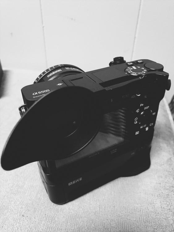

kidzrevil Posted October 8, 2017 Share Posted October 8, 2017 Alot of dealbreakers in the body for me at least. I had to add a ton of accessories to it including battery and thumb grips to make it worth using. If you can compromise and use the evf the image quality of the Sony is well worth it. True 6k to 4k downscale. The resolution difference between the a6500 and my panasonic is night and day @jase Link to comment Share on other sites More sharing options...
ThomHaig Posted October 8, 2017 Share Posted October 8, 2017 On 06/10/2017 at 10:39 PM, kidzrevil said: @kidzrevil - nice! - looks similar to what I've been using. I agree, the battery grip and eye-cup do tons to make it nicer to work with. I'm curious, what that accessory that looks like a lever coming out of the hotshoe? Don't think I've seen that before. kidzrevil 1 Link to comment Share on other sites More sharing options...
kidzrevil Posted October 8, 2017 Share Posted October 8, 2017 @ThomHaig hey ! Its a thumb grip. I didn’t even know they make those things for cameras but apparently its been a thing since like forever lol it makes the camera more stable because your thumb tends to go over the top of the camera and it can be uncomfortable. The thumb grip definitely helped me eliminate alot of the camera shake. dont forget the cineasy touch mod for the record button its another vital accessory Link to comment Share on other sites More sharing options...

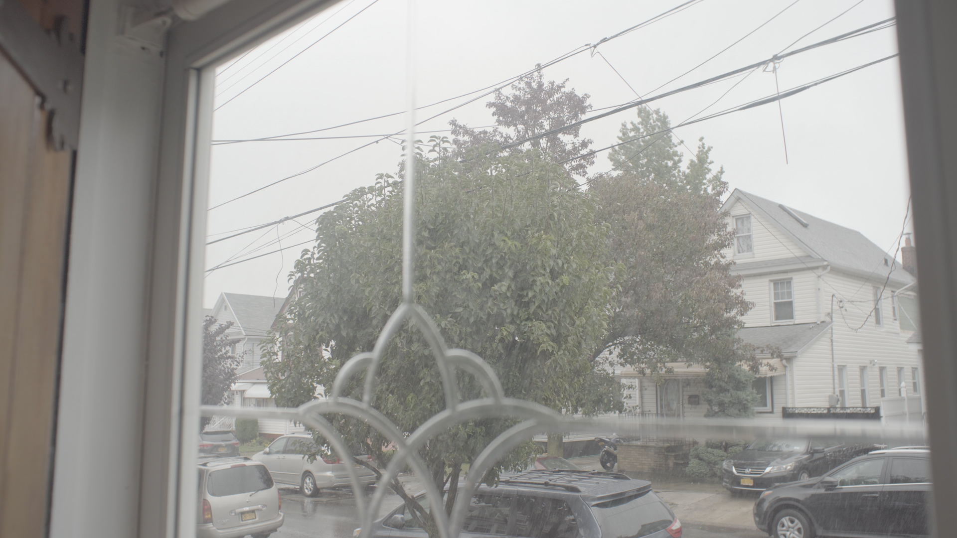

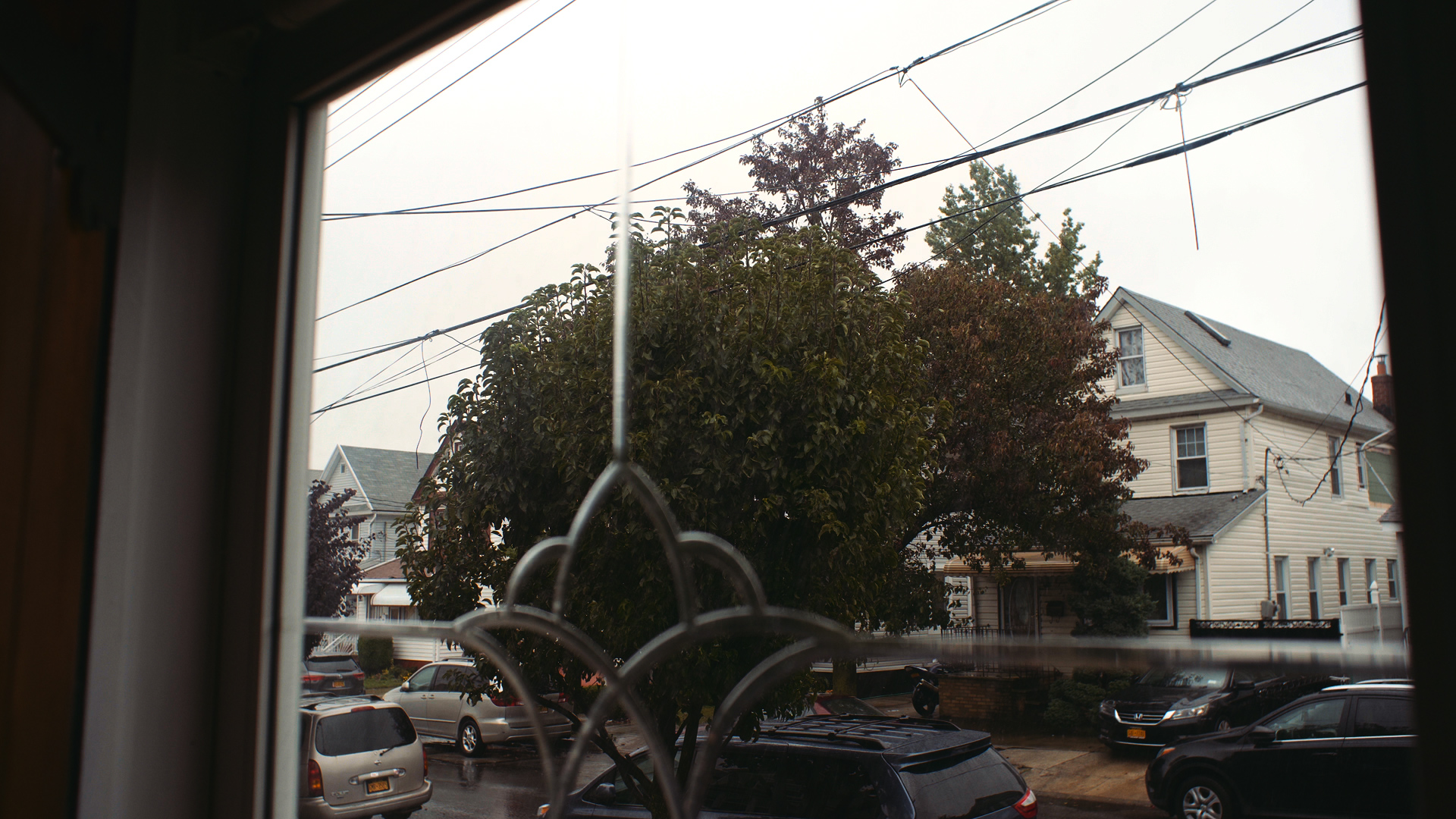

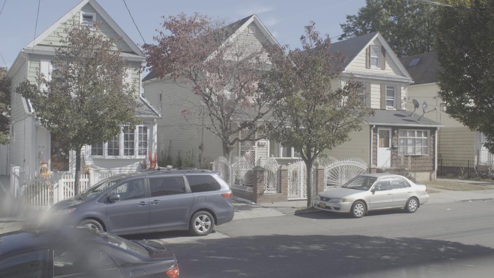

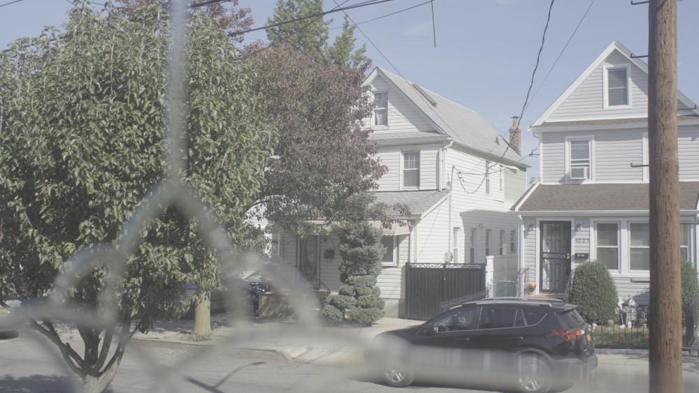

kidzrevil Posted October 9, 2017 Share Posted October 9, 2017 Sony SLOG w/ sgamut3.cine I boosted the color depth to +15 to add more useful data to the 8 bit color space. I made sure to expose my brightest areas up to 95 zebras. I then transcoded the files to 10bit 444 1080p. To my surprise the app I used to downscale the files added true color depth and microcontrast to the image. Fun fact : according to the cineon (which SLOG3 is based on) white papers the difference between 8bit Cineon files and 10bit files are imperceptible when the image is printed to the 6-7 stop dynamic range of our tv’s. Link to comment Share on other sites More sharing options...
kidzrevil Posted October 9, 2017 Share Posted October 9, 2017 Im pretty much going to treat the a6500 as a 1080p 10bit 444 camera from now on. Ever since I've discovered the joys of true down scaling (not the adobe premiere crap) to 10 bit 1080p slog3 became extremely satisfying to use. this software from hdcinematics.com is incredible ! Its down scaling algorithm for transcoding files really adds tremendous value to these 4k files for all of us who deliver in 2k resolution. these images were exposed to the right up to its clipping point at 95 zebras. In some scenes that I was overexposed up to 5 stops ! I recommend you shoot on manual so you can always expose to the right using zebras not the metering system. This gives enough light to the dark shades in the sky that cause banding because of lack of data. Never shoot to preserve highlights with slog3, shoot to brighten shadows as much as possible and pull them down in post ! I used filmconvert (you can use koji advance plugin as well) to pull the exposure down up to 5 stops. I tried the same in lumetri with luts and it created ugly artifacts. This leads me to believe that filmconvert's plugin is changing the white point or something of the expected image and making the appropriate corrections for the printed image. Pulling down the overexposed image shifts the bright parts of the dynamic range that were far away from the noise floor down into its correct 6-7 stop range appropriate for viewing on a monitor. Im amazed at the results, let me know what you think or what you would like to see. Link to comment Share on other sites More sharing options...

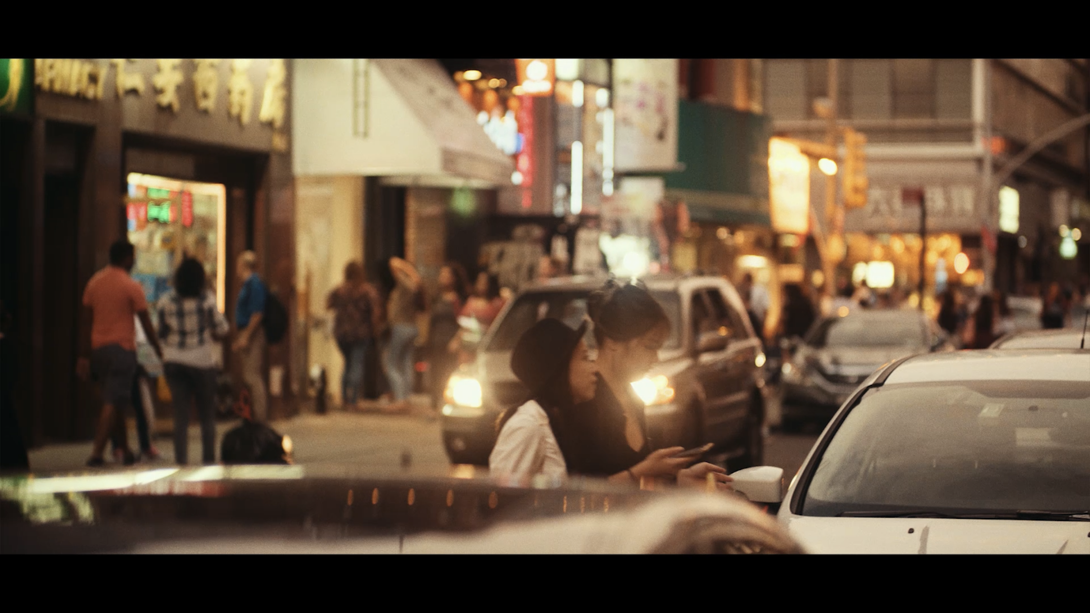

tonysss Posted October 10, 2017 Share Posted October 10, 2017 22 hours ago, kidzrevil said: Im amazed at the results, let me know what you think or what you would like to see. For me eyes there is too much contrast and dark, information in the shadows is lost. Color is great. Link to comment Share on other sites More sharing options...
kidzrevil Posted October 10, 2017 Share Posted October 10, 2017 16 minutes ago, tonysss said: For me eyes there is too much contrast and dark, information in the shadows is lost. Color is great. There is no information in the shadows that are lost. Check your waveform. Also feel free to play with the jpg for yourself being that its a log profile thats not clipped on either end all the luma and chroma information are still in thebfiles. Link to comment Share on other sites More sharing options...
tonysss Posted October 10, 2017 Share Posted October 10, 2017 the whole spell is 16-235 , (press whole dynamic range sensor to luminance levels 16-235) full range 0-255 will not play almost none consumer device. But, colors is amazing... Link to comment Share on other sites More sharing options...
kidzrevil Posted October 10, 2017 Share Posted October 10, 2017 @tonysss huh ? Link to comment Share on other sites More sharing options...

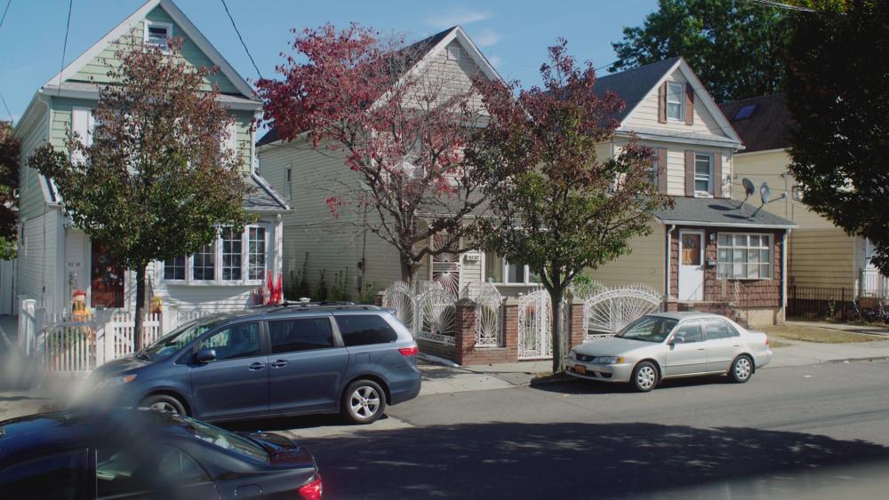

markr041 Posted October 18, 2017 Share Posted October 18, 2017 When not challenged by very high DR, I prefer Standard. But, what do I know? Aussie Ash, UncleBobsPhotography, Thomas Hill and 1 other 4 Link to comment Share on other sites More sharing options...
kidzrevil Posted October 18, 2017 Share Posted October 18, 2017 smart move. Its a more effective use of the 0-255 range @markr041 honestly pp off will be the best option for many. Not many of us are great at color correction or grading so shooting LOG is overrated unless you know how to harness it. Standard is more than sufficient 29 minutes ago, markr041 said: When not challenged by very high DR, I prefer Standard. But, what do I know? these colors look better than anything I can produce in LOG mode. Honestly. Link to comment Share on other sites More sharing options...
Thomas Hill Posted October 19, 2017 Share Posted October 19, 2017 2 hours ago, markr041 said: When not challenged by very high DR, I prefer Standard. But, what do I know? Beautiful! Is this Standard SOOC? I really dig the colors/look of this one. Is it standard, too? You and Kidz have me seriously thinking about a 6500. kidzrevil 1 Link to comment Share on other sites More sharing options...
kidzrevil Posted October 19, 2017 Share Posted October 19, 2017 On 10/10/2017 at 10:58 AM, Herbert Massey said: I hope the GH5 pressures them to offer 4:2:2 10 bit. I made a promise to myself that I'd never buy another 8bit video camera after my NX1. an a7000 or something with 4:2:2 10 bit would be a game changer. Im already amazed at the fact that I get a full frame look out of this when using the speedbooster ! I wish they make an official battery grip for this thing too 4 hours ago, Thomas Hill said: Beautiful! Is this Standard SOOC? I really dig the colors/look of this one. Is it standard, too? You and Kidz have me seriously thinking about a 6500. yeah @markr041 footage is amazing. The colors look so good Link to comment Share on other sites More sharing options...
markr041 Posted October 19, 2017 Share Posted October 19, 2017 The colors in both videos are Standard, sooc. Only exposure, contrast altered in post. Thomas Hill 1 Link to comment Share on other sites More sharing options...
