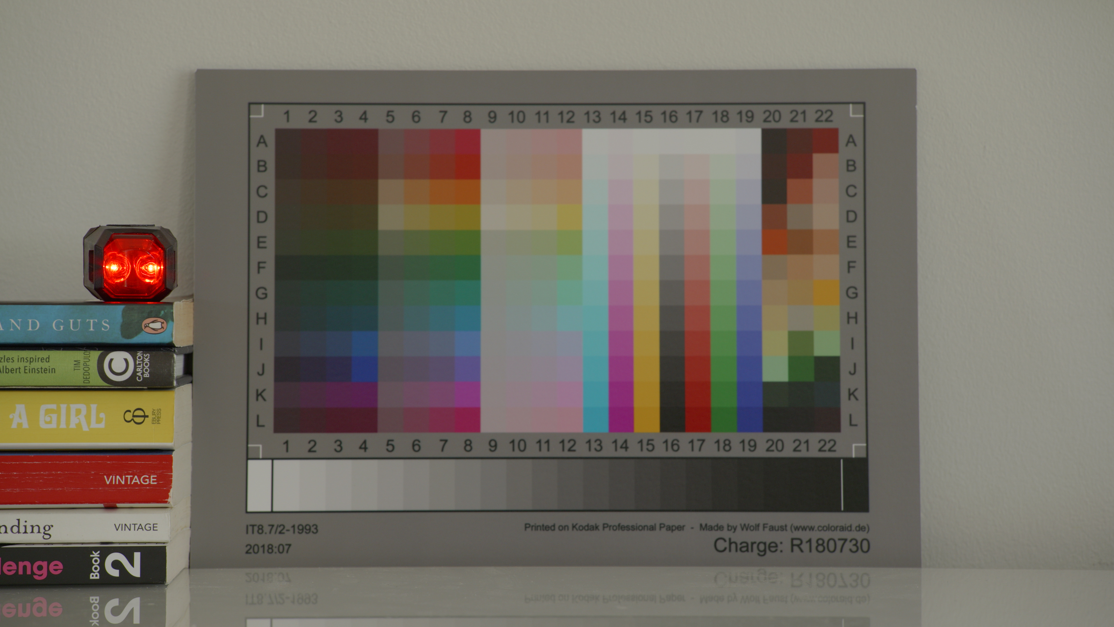

hyalinejim Posted June 13, 2023 Share Posted June 13, 2023 New firmwares today "NEW Firmware 13th June 2023 The LUMIX S5II v2 firmware update will offer RAW data output over HDMI (Requires Software Upgrade Key DWW-SFU2). In addition to ProRes RAW, Blackmagic RAW will now be available. Improved image quality when shooting with V-log. Live View Composite, which is pre-installed on the LUMIX S5IIX, is also among the new features included in the firmware update. Lumix S5IIX v1.1 Improved performance - Improved image quality when shooting with V-log. - Improved compatibility with some SD cards. - Improved operational stability. See: https://www.panasonic. com/global/consumer/lumix/s/firmware_update.html or https://av.jpn.support.panasonic. com/support/global/cs/dsc/download/index4.html " ntblowz, Thpriest and kye 3 Link to comment Share on other sites More sharing options...
hyalinejim Posted June 13, 2023 Share Posted June 13, 2023 The only major image quality improvement I can spot is a removal of a weird chromatic aberration that I'd never noticed before. before after Juank and 92F 2 Link to comment Share on other sites More sharing options...
MrSMW Posted June 13, 2023 Share Posted June 13, 2023 10 hours ago, hyalinejim said: Improved image quality when shooting with V-log Other than your weird chroma, I wonder what that entails? Link to comment Share on other sites More sharing options...
hyalinejim Posted June 13, 2023 Share Posted June 13, 2023 16 minutes ago, MrSMW said: I wonder what that entails? Ha ha! Nobody knows yet. Colours are the same. The red clipping problem is different, but not gone. Shadow banding remains. Interestingly, that shot was with a Canon 70-200 f4 with Sigma Mc21. So with the new firmware maybe the camera can now do chromatic aberration correction with other lenses. It would have been a bit easier if they just told us what they did 😂 kye, deezid and Juank 3 Link to comment Share on other sites More sharing options...
