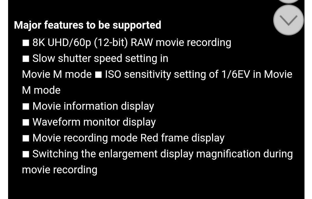

ND64 Posted October 28, 2021 Share Posted October 28, 2021 Waveform monitor comes with firmware update. herein2020, ntblowz, IronFilm and 1 other 3 1 Link to comment Share on other sites More sharing options...

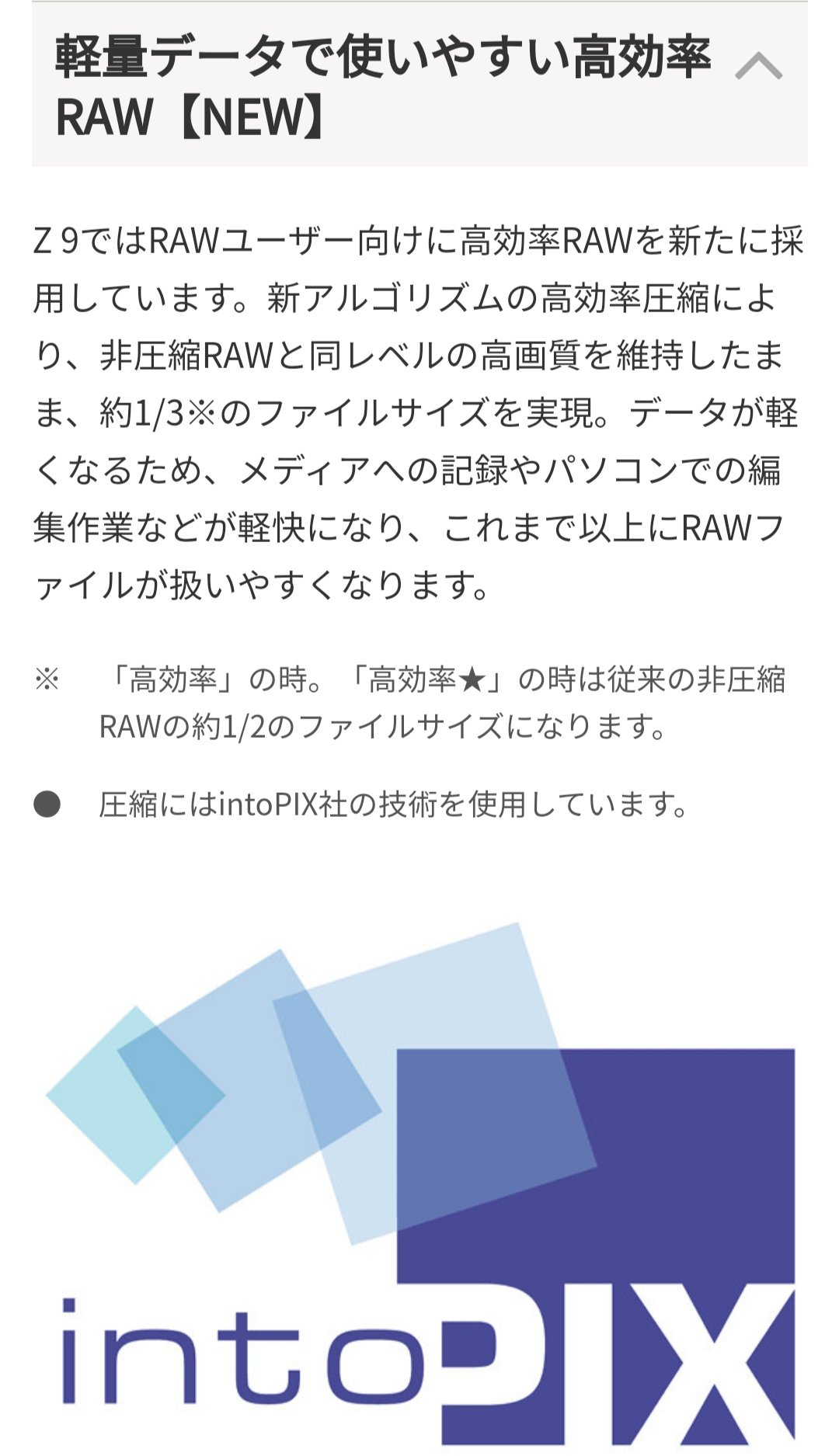

ND64 Posted October 28, 2021 Share Posted October 28, 2021 They have licensed the raw technology from a company called intoPIX. Its kinda a surprise, because their new raw technology announced just one month ago! Here is what they call TICO-RAW: https://www.intopix.com/tico-raw Emanuel and Juank 2 Link to comment Share on other sites More sharing options...

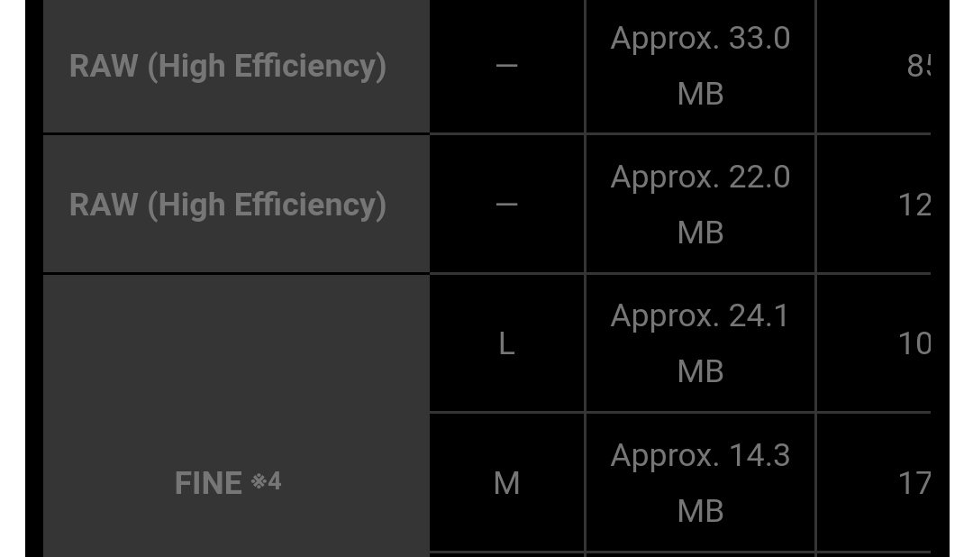

ND64 Posted October 28, 2021 Share Posted October 28, 2021 Ok, I want this RAW, RIGHT NOW! High Efficiency raw size is LESS than size of high quality Jpeg! Juank and Emanuel 2 Link to comment Share on other sites More sharing options...

cookietub Posted October 29, 2021 Share Posted October 29, 2021 5 hours ago, Eric Calabros said: They have licensed the raw technology from a company called intoPIX. Its kinda a surprise, because their new raw technology announced just one month ago! Here is what they call TICO-RAW: https://www.intopix.com/tico-raw How do you know this? Source, please. Link to comment Share on other sites More sharing options...
ND64 Posted October 29, 2021 Share Posted October 29, 2021 57 minutes ago, cookietub said: How do you know this? Source, please https://www.nikon-image.com/products/mirrorless/lineup/z_9/features04.html Link to comment Share on other sites More sharing options...
