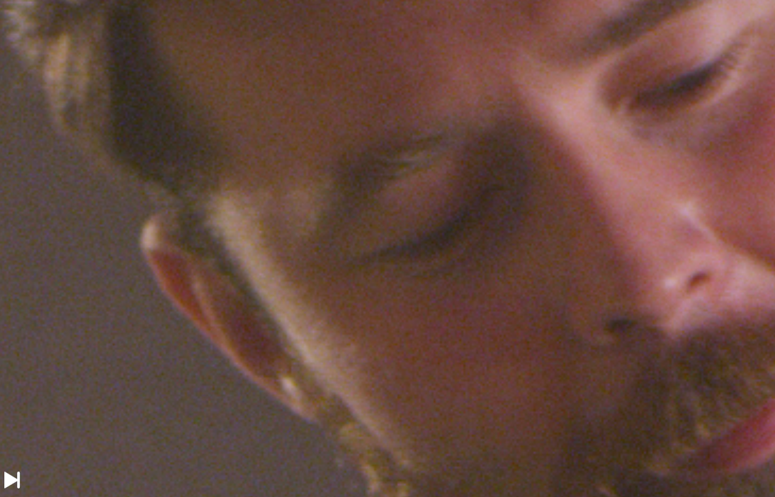

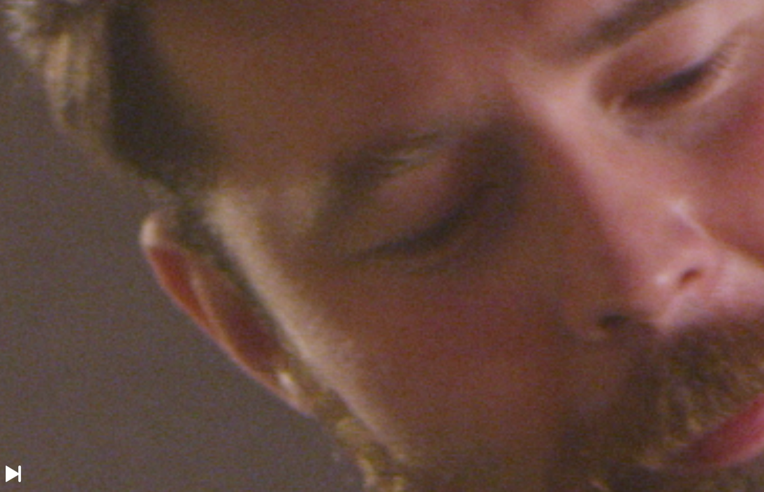

kye Posted February 27, 2022 Share Posted February 27, 2022 Cameras are starting to get Prores, and opinions range from "prores is irrelevant" and "prores is old" to "this is the best thing ever!". So which is right? Actually, both. Why Prores is irrelevant... Prores isn't better quality than h264 or h265. Here's a test I did. I took an 8K RAW clip from RED Helium and put it on a 4K timeline and exported it as uncompressed from Resolve, then took that 4K uncompressed and using FFmpeg (which is much better than Resolves export quality) and created 4K versions of the clip in Prores HQ, 10-bit h264 IPB, 10-bit h264 ALL-I, 10-bit h265 IPB, 10-bit h265 ALL-I, all matching the same bitrates. The results were that all the h264/5 files and the ProresHQ looked basically identical to the original - even at 300% magnification. Here's the original 8K RAW on 4K timeline (at 300%): and here's one of the h26x files (remember they all look the same): So, 10-bit h26x is as good as Prores HQ - case closed right? No. To be technically correct, the statement is "10-bit h26x is as good a codec as Prores HQ at the same bitrate". Why Prores is spectacular... The bitrate of Prores HQ in 4K is just over 700Mbps. Not a lot of cameras with that bitrate option!! Most are more like 100Mbps. Well, here's what that looks like: Ummm.... where did the detail go? Prores benefit number one... guaranteed high bitrates. But that's using FFmpeg to take as much processing time as it likes, what about when it's being done in-camera? Well, using FFmpeg to convert a 1080p uncompressed reference file to Prores HQ happened at 53fps and 10-bit h264 IPB was at 7.2fps. That's over 7x more computation to create a file of equivalent bitrate. Do cameras differ in h264 quality? Absolutely. I suspect that computation load is a factor here. If a manufacturer is compromising on quality for lowering processing requirements in-camera then the results will be worse than the 100Mbps result above. Prores benefit number two... lower processing power required, potentially meaning less temptation to compromise quality. But the codec / bitrate isn't the only thing that impacts the image - processing also matters. Specifically, NR and sharpening. This is where things get difficult to compare because not many cameras have both - typically cameras are either RAW/Prores or h264/5. However, when you choose a codec you are also choosing the processing, because cameras mostly don't give full control for sharpening and NR on all profiles. It will be interesting to see the GH6 profiles and how they compare, but mostly Prores are aware that the huge file sizes aren't for consumers and so will configure Prores to have less processing. Prores potential benefit number one... lower sharpening and NR applied in-camera. What about RAW? RAW is great. The semi-compressed RAW formats make shooting RAW wonderfully flexible, giving the benefits of RAW without being forced to spend more on media than on your camera, but once-again, RAW isn't directly comparable. ProresRAW and B-RAW mostly require an external recorder, making your camera larger, requiring extra cables and rigging, requiring additional batteries and chargers, and introducing more points of failure in your setup. Some cameras have internal RAW, some even offer compressed internal RAW, but what if those cameras don't suit your requirements or shooting style? Prores potential benefit number two... in-camera with no extra equipment or hassles. RAW is typically a 1:1 pixel readout. This means that you either shoot using the full sensor resolution or shoot with a crop. Shooting with the full sensor resolution means that you'll need compressed RAW or you'll have large file sizes (like the Sigma FP), and also that your computer may have to bear the burden of decompressing / debayering / downscaling a file with higher resolution than your timeline, which is something worth considering as I know a number of people who put all their money into cameras and lenses and are struggling with older computers to edit their work on. This will become more and more significant as sensor resolutions gradually creep up past 6K, 8K and beyond. Why not crop? Well, goodbye wide-angle lenses, and hello to an extra step on set where you have to apply the sensor crop factor and your resolution crop factor to the lens focal length every time you want to change lenses on set. If you have time on set and good systems and lots of support then that's fine, but mistakes are inevitable and the less complicated things are the less likely they are to be made. Prores potential benefit number three... in-camera downsampling. So there we are. Prores is an old irrelevant codec superceded by h264 and then by h265, but when its implemented in a camera the implications are potentially quite significant for many people, depending on what and how you shoot. PannySVHS, webrunner5 and mercer 3 Link to comment Share on other sites More sharing options...

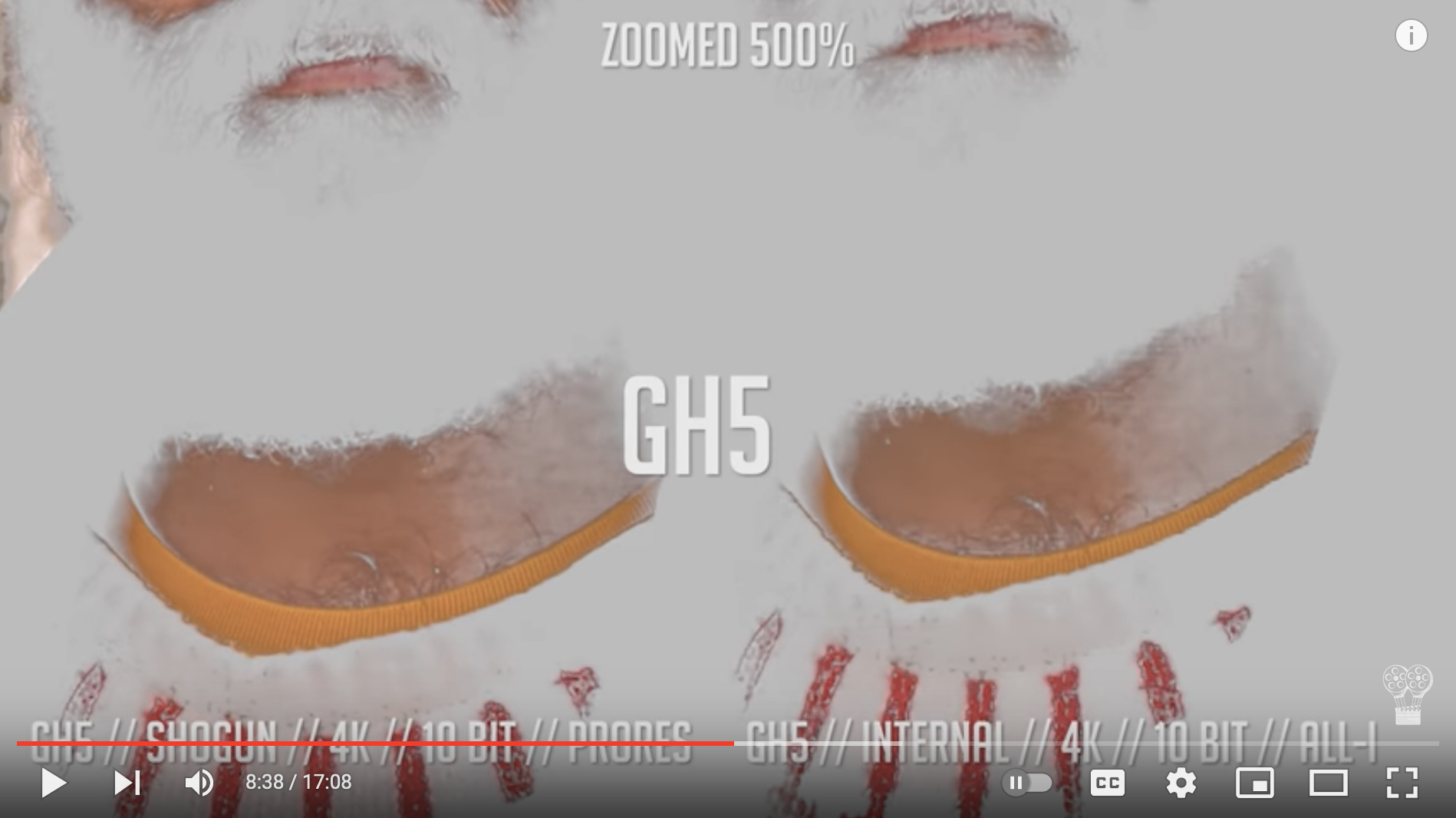

Mark Romero 2 Posted March 1, 2022 Share Posted March 1, 2022 I saw a video a while back comparing the all-i codecs on the GH5 with prores recorded on a Ninja and it seemed like the prores was better at avoiding macroblocking in motion. So I guess in theory it allows better keying in post. I thought the video was by Andy Dax, but apparently it was by another group of filmmakers (in Norway)? I can't seem to find it on the Andy Dax channel. kye 1 Link to comment Share on other sites More sharing options...
kye Posted March 1, 2022 Author Share Posted March 1, 2022 5 hours ago, Mmmbeats said: The main advantages of ProRes over H.264 and H.265 are smoother playback and better facility for bouncing down to further generations. Its designed to work really well in a post production environment, which it does superbly in my experience. Its no surprise at all that the codecs look similar at the same data rates, in fact it is H.265 that you would expect to look the best as it is the most efficient encoder. Of course H.264 looks good at reasonable data rates. If it didn't it wouldn't have been utilised as an acquisition codec by just about every manufacturer under the sun at some point. The point is that IPB codecs are horrendous in a post environment. People are excited by ProRes 422HQ in the GH6 because, unlike the other two codecs, it is *guaranteed* to have high data rates (1.9 Gbps is what they are saying), and it will fit straight into our post workflows. The GH5 is relatively unique in that it offers a good selection of ALL-I codecs, which I use and are just wonderful in post. I guess other cameras would benefit from this though, as not many other models/manufacturers seem to have this included. Interestingly, I thought for the test I would encode and re-encode each codec over and over again until one of them started breaking down, but I setup ffmpeg to do that on a 1080p version (to save processing time) and after 8 generations on h264 IPB at the same bitrate as Prores HQ I had to pause because the file looked the same. At first I thought that ffmpeg was being too clever for me and just copying the stream instead of re-encoding it, but when I zoomed in crazily (something like 800%) there were subtle differences. So really, all else being equal and when given enough bitrate, they all do a great job, so it's really the other factors that I highlighted in my post that are the deciding factors. 1 hour ago, Mark Romero 2 said: I saw a video a while back comparing the all-i codecs on the GH5 with prores recorded on a Ninja and it seemed like the prores was better at avoiding macroblocking in motion. So I guess in theory it allows better keying in post. I thought the video was by Andy Dax, but apparently it was by another group of filmmakers (in Norway)? I can't seem to find it on the Andy Dax channel. I suspect you are talking about this video? This is probably the part you're referring to? I found it hard to tell TBH, even with it moving, but that is a comparison between Prores on the Shogun, which is either HQ at 700Mbps or Prores 422 at 471Mbps vs the GH5 codec which is 400Mbps, so there's not much difference in the bitrate there. The 400Mbps is on the high side compared to most cameras bitrates, and with the GH6 in 5.7K they'd be looking at 1500Mbps or 1000Mbps, which are significantly more again, so the bitrates really are pretty serious. TBH, there's a point in diminishing returns with bitrate, not just because of accuracy vs bitrate, but also that if you multiply the resolution and bitrate by 9x (1920 x 3 is 5.7K) you're not increasing the size of the screen that the viewer will view the image on, so actually, once there is sufficient bitrate to render the screen to a certain optical quality it doesn't really require much more if you increase the resolution on the same display, or at least, it doesn't need to increase by a factor of 9. Of course, if you're doing green-screen or other hard-edged keying, cropping in post, stabilising significantly, compositing and other VFX operations then that's a different story, but those are specialist applications and not general ones. Mmmbeats and Juank 2 Link to comment Share on other sites More sharing options...
Mark Romero 2 Posted March 1, 2022 Share Posted March 1, 2022 11 minutes ago, kye said: I suspect you are talking about this video? Yes, that was the one. I don't think I would notice ANY difference between the all-i internal codecs and prores external unless I was keying, which i freaking HATE to do (I mean, I hate even trying to light a green screen so you can imagine what I am like at 4:00am trying to key around hair, but then again, I am using the 150Mbps 10-bit 4:2:2 Long GOP from the S1 or S5). Juank and kye 2 Link to comment Share on other sites More sharing options...
kye Posted March 1, 2022 Author Share Posted March 1, 2022 4 hours ago, Mark Romero 2 said: Yes, that was the one. I don't think I would notice ANY difference between the all-i internal codecs and prores external unless I was keying, which i freaking HATE to do (I mean, I hate even trying to light a green screen so you can imagine what I am like at 4:00am trying to key around hair, but then again, I am using the 150Mbps 10-bit 4:2:2 Long GOP from the S1 or S5). Absolutely. In the real world we're probably talking about the difference between 100Mbps h265 or 240Mbps h264 ALL-I (both from A73) vs 700Mbps All-I Prores HQ, or similar. Or, comparing Prores HQ with RAW but where RAW requires an external recorder and costs many hundreds of dollars and requires cables, extra batteries, more things to charge, etc etc. Link to comment Share on other sites More sharing options...
