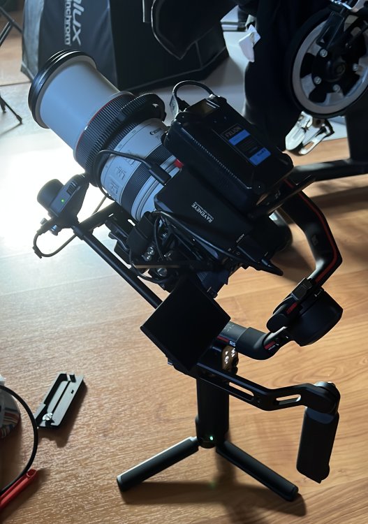

Ty Harper Posted October 19, 2022 Share Posted October 19, 2022 Anyone using the R5C with a gimbal? Would love to know what other owners are using and what the experience has been like. Currently looking at either the RS2 or RS3 but I'm coming from the Glidecam era so gimbals are new to me. I'll also be looking to use mine with the battery grip and compatible Smallrig cage which I have no interest in dismantling - so curious how that might limit or complicate things for me. Link to comment Share on other sites More sharing options...

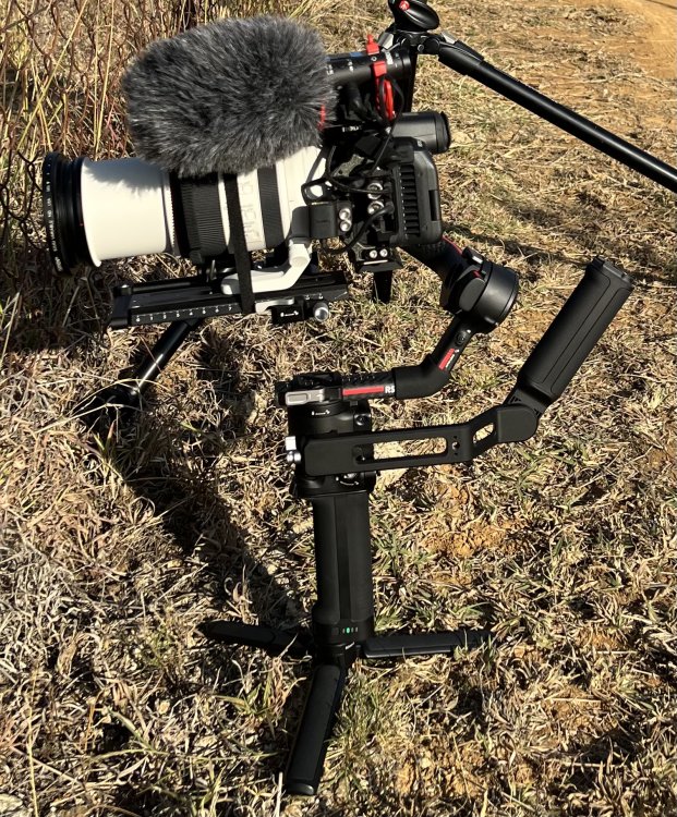

gt3rs Posted October 22, 2022 Share Posted October 22, 2022 On 10/19/2022 at 8:58 PM, Ty Harper said: Anyone using the R5C with a gimbal? Would love to know what other owners are using and what the experience has been like. Currently looking at either the RS2 or RS3 but I'm coming from the Glidecam era so gimbals are new to me. I'll also be looking to use mine with the battery grip and compatible Smallrig cage which I have no interest in dismantling - so curious how that might limit or complicate things for me. I used the R5c with the full cage and the FxLion One Battery on top of the cage on a Ronin S quite a bit and depending on the lens is a bit at the limit with the clearance. The EVF of the R5c is stick out quite a bit and the cage need some more space on the motor side. Sold the S and now I use a RS3 Pro and due to stronger motors and longer harms I can mount whatever with no issue. For my Africa project I did use a lot with the 70-200 and no problem at all to balance and still have enough clearance to go underslung. Although Smallrig claims the cage to be compatible with the DJI arca plate ,mine is not and I tested with RSC2 (too small for this camera anyway) and RS3 Pro plates and due to the security pin both cannot take the cage directly. I have the R5 full cage so maybe. Bottomline either you mount the DJI arca adapter (that comes with the gimbal) on the tripod hole of the cage or if you want something more solid you need to buy this: SMALLRIG Quick Release Plate for Arca-Type Standard Compatible with DJI RS 2 / RSC 2 / RS 3 / RS 3 Pro Gimbal - 3154 or this SMALLRIG Camera Quick Release Plate Adapter with Arca-Swiss for DJI RS 2/RSC 2/RS 3/RS 3 Pro & for Ronin-S Gimbal - 3061. I use the gimbal on high vibration environment quite a bit, on MTB, Motorbike, Jeep, Skii, Heli so the stronger motor of the RS3 Pro is a no brainer for my usage. For only 200g more is imo worth. The new auto locking of the RS3 and RS3 Pro seems a small thing but it makes life so much easier. The Dancing Babamef, Ty Harper and Juank 1 2 Link to comment Share on other sites More sharing options...

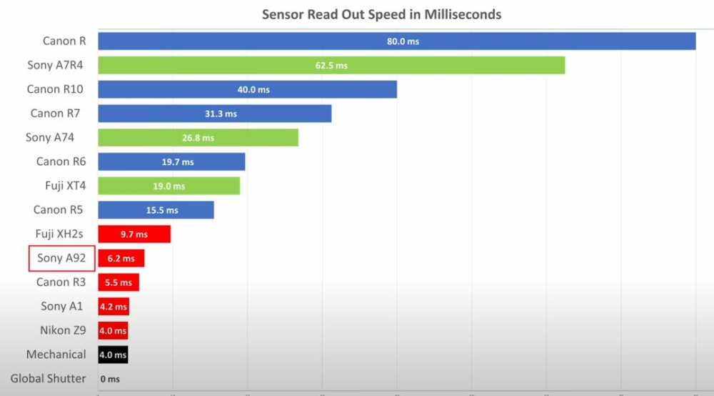

filmmakereu Posted December 4, 2022 Share Posted December 4, 2022 5 hours ago, ntblowz said: On R5/R5C 8K/4K Fine it is 15.5ms, on 4K standard mode and 4K50p it change to 9.6ms, on 5.9K RAW APS-C it is 11.5ms On R7 the 4K Fine mode it is around 31ms according to the graph, so if 4K50P is 14.5ms then I think 4k non standard will be the same as 4K50p. I knew Gordon done the test of 4K fine, 4K standard and 1080p quality comparison on the R5, 4k standard is still way sharper than 1080p. Any estimation how bad rolling shutter is on R5 C 8K50P/60P? Link to comment Share on other sites More sharing options...
ntblowz Posted December 4, 2022 Share Posted December 4, 2022 This is the only test I can see that they did 8K25p and 8K50P rolling shutter, seems like same rolling shutter performance on 25p and 50p Emanuel and filmmakereu 2 Link to comment Share on other sites More sharing options...
filmmakereu Posted December 4, 2022 Share Posted December 4, 2022 38 minutes ago, ntblowz said: This is the only test I can see that they did 8K25p and 8K50P rolling shutter, seems like same rolling shutter performance on 25p and 50p Does it record 8K50P internally after all? Full lens stabilization and autofocus internally? Supplied with the EF lenses via their adapter too? What lenses have you used there? Link to comment Share on other sites More sharing options...
filmmakereu Posted December 4, 2022 Share Posted December 4, 2022 I have read lens stabilization and autofocus only works on 8K50P when powered externally... Is it true? Link to comment Share on other sites More sharing options...
ntblowz Posted December 5, 2022 Share Posted December 5, 2022 20 hours ago, filmmakereu said: I have read lens stabilization and autofocus only works on 8K50P when powered externally... Is it true? Yeah, 8K50/60P internally in RAW format only. If you have PD-powerbank connect to R5C it will power the lens and AF as well. filmmakereu and Emanuel 1 1 Link to comment Share on other sites More sharing options...
gt3rs Posted December 5, 2022 Share Posted December 5, 2022 On 12/4/2022 at 10:45 AM, filmmakereu said: Any estimation how bad rolling shutter is on R5 C 8K50P/60P? around 15ms same as 24-30p, 8ms 120p the above chart is misleading as it seems for photo not video, r3 is 9.9 in ff 24-60 filmmakereu and Emanuel 1 1 Link to comment Share on other sites More sharing options...
