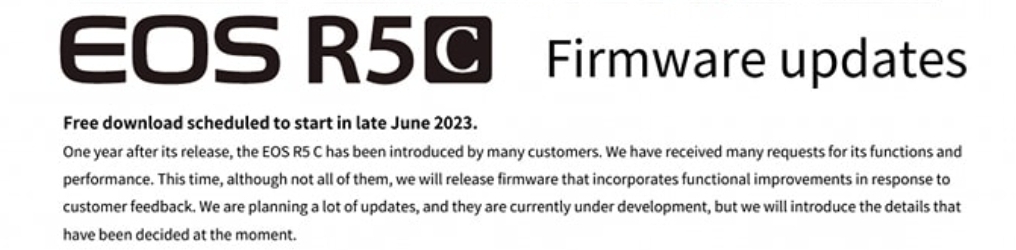

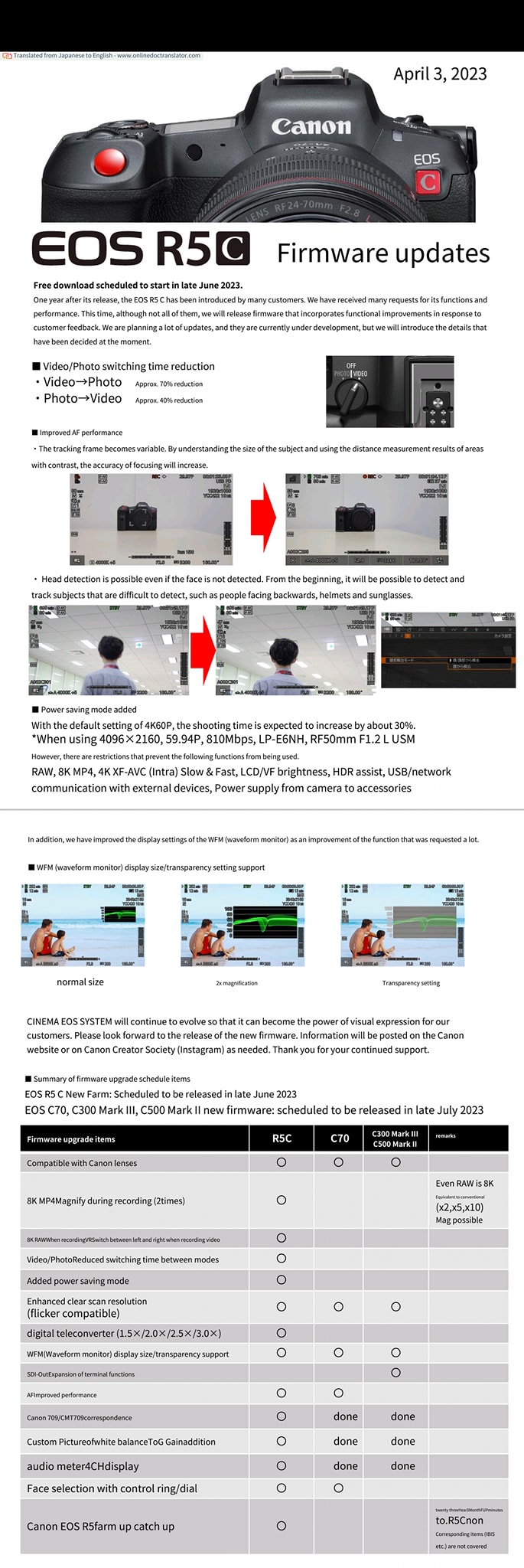

Ty Harper Posted April 3, 2023 Share Posted April 3, 2023 Here's a more comprehensive list of the R5C updates via Barry Griffin's IG: https://www.instagram.com/barry_canonproimaging/ EOS R5 C Firmware Update: Flex Zoom & CN8x15 IAS Lens support Mount Adapter EF-EOS R 0.71x support (same lens support as EOS C70) RF-S Lens support (RF-S 18-45mm, RF-S 18-150mm, RF-S 55-210mm) EOS R5 Catchup update (adds features from R5’s July, Nov & March FW release) Dual Fisheye: Enables Left/Right switching for VR recording Improved Video/Photo mode switching Adds Power Saving Mode Enhanced Clear Scan resolution (improves compatibility with LED walls). Adds Digital-Teleconverter function (adds 1.5x / 2x / 2.5x / 3x magnification) Option to change WFM & Vectors cope size and transparency Adds Canon 709 / BT.709 / CMT 709 (same as previous CEOS FW update) Adds ‘G Gain’ White Balance option in Custom Picture settings Adds subject selection via Lens Control Ring as an assignable function === Additionally Youtuber Yusuke Osawa just released an interview he did with a Canon rep about the announced FW updates. Might be worth checking out for some: https://www.youtube.com/watch?v=uquTpEvgCRg Thanks to user 'sugoroku' over at DVXuser for translating some key things not mentioned by NewsShooter or Barry Griffin. Specifically the following (take everything with a grain of salt obviously!): "1) Extended battery life. It only works with XF-AVC and not for RAW recording but should extend battery life up to 30% longer. 2) Two autofocus improvements. One being detecting human head more precisely especially when facing backwards and the other being focus tracking box changing its size and shape depending on the tracking subject. (around 15min. mark on the video link below)" Django, ntblowz and Emanuel 1 2 Link to comment Share on other sites More sharing options...

Django Posted April 4, 2023 Share Posted April 4, 2023 12 hours ago, Ty Harper said: Additionally Youtuber Yusuke Osawa just released an interview he did with a Canon rep about the announced FW updates. Might be worth checking out for some: https://www.youtube.com/watch?v=uquTpEvgCRg Thanks to user 'sugoroku' over at DVXuser for translating some key things not mentioned by NewsShooter or Barry Griffin. Specifically the following (take everything with a grain of salt obviously!): "1) Extended battery life. It only works with XF-AVC and not for RAW recording but should extend battery life up to 30% longer. 2) Two autofocus improvements. One being detecting human head more precisely especially when facing backwards and the other being focus tracking box changing its size and shape depending on the tracking subject. (around 15min. mark on the video link below)" I just watched the Japanese interview with auto-translation and what the rep says is 30% increased battery life in 4K60p (there is even a little text insert in the bottom right that confirms it at 20:14). I don't see no mention of it being only for XF-AVC but that might have been lost in translation so I trust its correct. From my understandings, XF-AVC is where the R5C battery drainage is the worst so makes sense that they managed to fix that. I wonder what the increase is for regular 4K24/25/30p. 30% or more? They explain the fan is the main culprit of the power drainage so this low power mode may turn it down or something. This is quite the game changer as with a grip and 2 batteries that's 60% battery gain which should make it quite decent right? The photo/video switch time improvement is also good news. Man, I had ruled this camera out but might be warming up to it again! Kudos to Canon for such a solid update. They've been on a roll with them lately. Link to comment Share on other sites More sharing options...

Django Posted April 4, 2023 Share Posted April 4, 2023 9 hours ago, ntblowz said: Ah.. I see in the fine print of "Power Saving Mode" the restrictions (RAW, 8K mp4, XF-AVC Intra etc). So what does that leave you with? up to 4K60p mp4 & 8K XF-AVC Long GOP ? Link to comment Share on other sites More sharing options...
gt3rs Posted April 4, 2023 Share Posted April 4, 2023 53 minutes ago, Django said: Ah.. I see in the fine print of "Power Saving Mode" the restrictions (RAW, 8K mp4, XF-AVC Intra etc). So what does that leave you with? up to 4K60p mp4 & 8K XF-AVC Long GOP ? As I read is "XF-AVC Intra Slow and Fast" not normal fps, my bet is any XF-AVC (24,25,50 and 60) will have the power saving. Unfortunately there is no 8k XF-AVC on the R5c, is either RAW or MP4. Link to comment Share on other sites More sharing options...
