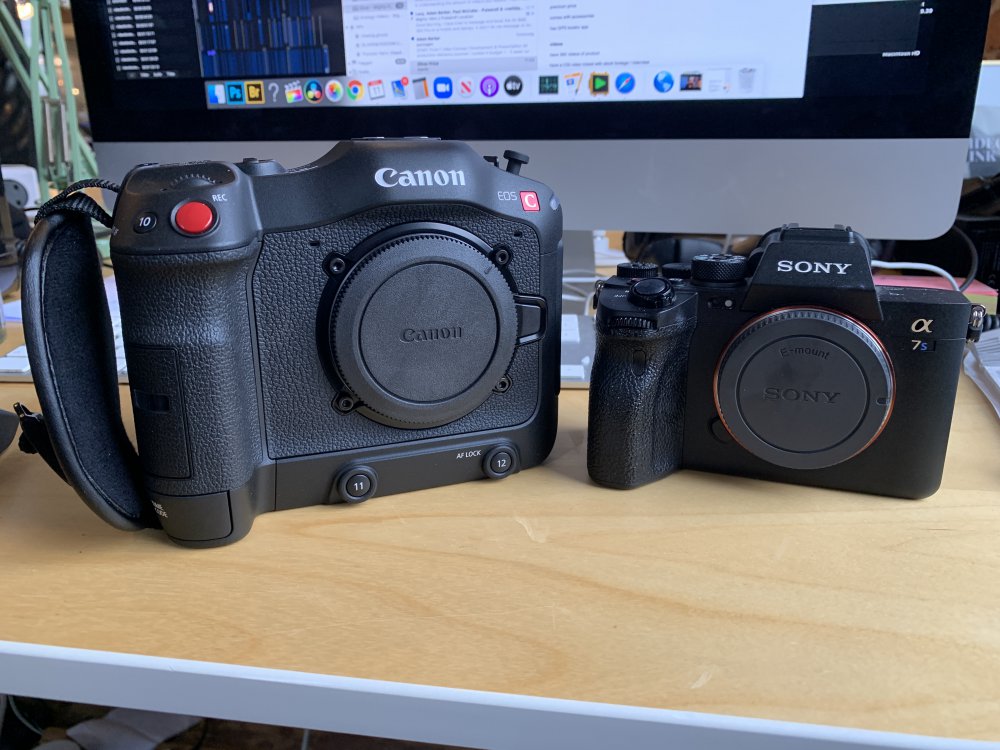

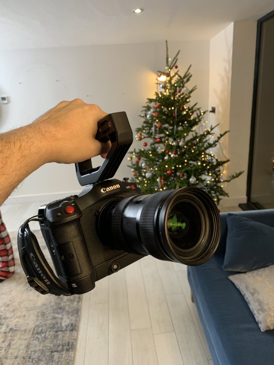

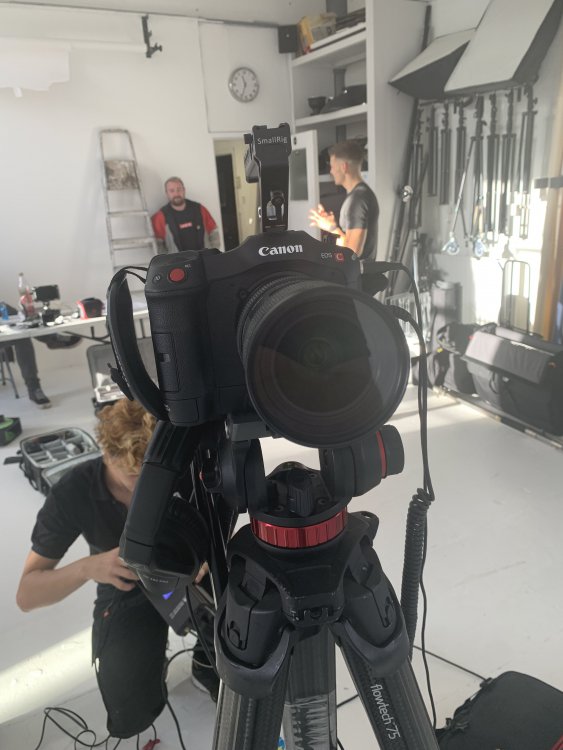

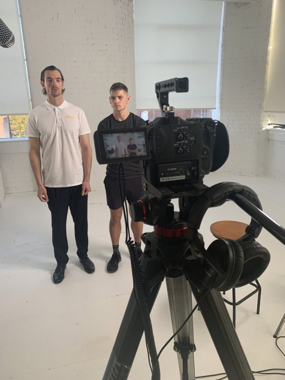

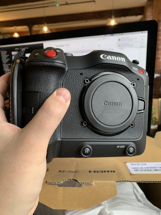

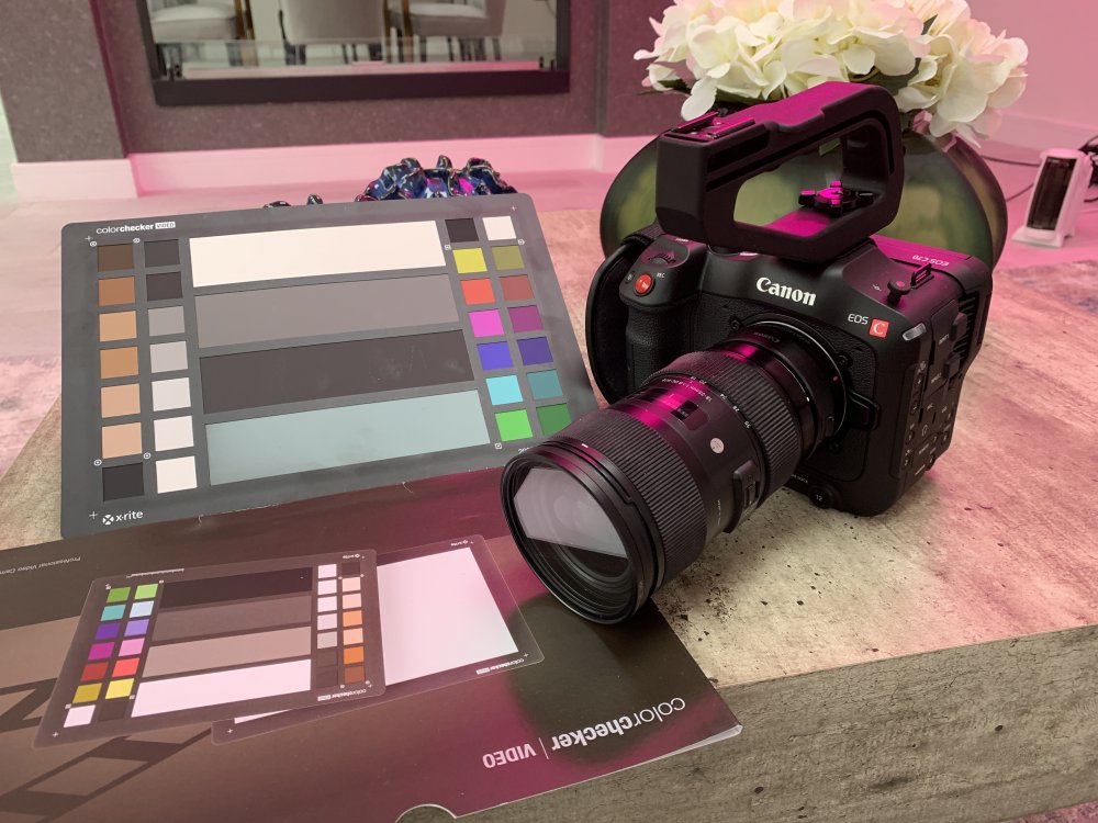

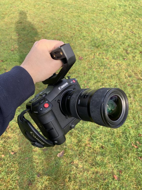

Popular Post Oliver Daniel Posted November 18, 2020 Popular Post Share Posted November 18, 2020 I got the C70 last week as part of CVP’s first batch. Even though I have the A7SIII, I bought it because Canon obviously read a post on this forum about what my “perfect camera” looks like. So I just had to. I sold my EVA1. I put it in the deep end straight away on 2 professional shoots for fitness brands. The videos aren’t finished so can’t share any footage yet! My impressions: 1. Body design is fantastic. Lovely in the hand and a joy to operate. Feels cheaper than other C-series for sure but still premium. Well built and easy to use. Very light too! 2. The screen is flimsy and should be more robust. 3. The joystick is drunk. You want to go left, but it goes up etc. Not sure if this is a “getting used to it” kinda thing, but it’s unusually tricky to get the hang of. 4. Record button is also a bit stubborn. You have to press that thing very well to get it to record or stop. 5. Quick touch screen menu is amazing. There’s no need to reboot the camera to change frame rates and codec like I did on the EVA1. 6. DIS is decent! Doesn’t feel overly robotic like other IBIS systems. But there’s a slight crop. 7. DPAF with the Sigma 18-35mm is pretty good. My Sigma 50mm hunted quite a bit though. 8. It has no tracking like the A7S3, only for faces. Seems the face tracking is disabled in 4k100fps. 9. Footage in all modes is crisp and clean. Not overly sharp, but detailed. It looks a bit more organic than the A7S3, which is clinical without a Promist. Noticed the A7S3 is a bit more contrasty in SLOG3 than CLOG3. The C70 has an edge in the shadows. 10. You can use a V60 in 4k100fps but comes up with a warning that it won’t work. It does, but sometimes cuts off due to a full buffer. Not often though. I’d still get a V90. 11. H265 footage plays back better than the A7S3 on my 2025 iMac. Still a sludge though. 12. Footage can be easily matched to the A7S3. Took me about a minute. Amazing how much Sony have improved it. In conclusion, I had a good first experience and I’m looking forward to the next shoot. I currently prefer the A7S3 but it’s too early to decide that really. Both are great and can be used together very seamlessly due to the Sony’s improved colour and codecs. Rinad Amir, BenEricson, JordanWright and 8 others 9 2 Link to comment Share on other sites More sharing options...

mkabi Posted November 20, 2020 Share Posted November 20, 2020 6 hours ago, EphraimP said: What EF adapter are you using? I haven't heard anything about the speedbooster coming out yet. I think he is using regular Canon EF to RF for the Sigma 18-35; its in the pictures. EphraimP 1 Link to comment Share on other sites More sharing options...
Oliver Daniel Posted November 20, 2020 Author Share Posted November 20, 2020 4 hours ago, mkabi said: I think he is using regular Canon EF to RF for the Sigma 18-35; its in the pictures. Yep! EphraimP 1 Link to comment Share on other sites More sharing options...
