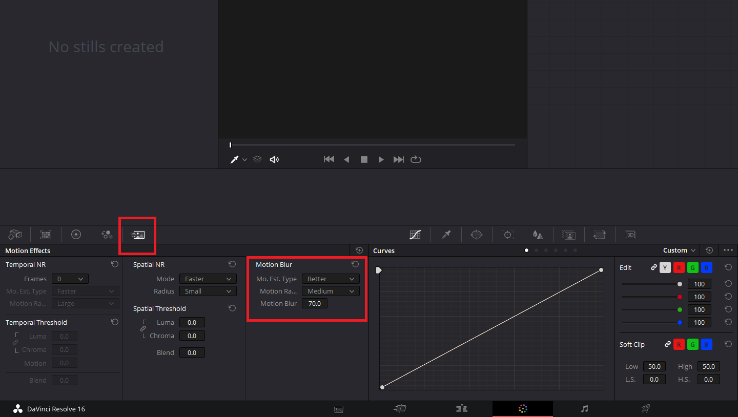

heart0less Posted May 24, 2020 Share Posted May 24, 2020 Resolve offers something like this. It's quite good, actually. Did you give it a whirl? Andrew - EOSHD and kaylee 1 1 Link to comment Share on other sites More sharing options...

Geoff CB Posted May 24, 2020 Share Posted May 24, 2020 The one in resolve is close enough that I'm not going to use ND's for shots on my Z6 anymore. Also for VFX work results are far better when you pull a key off a high shutter speed and then add the motion blur in post. Makes cleaning up hair work far easier. cameraeye and kaylee 2 Link to comment Share on other sites More sharing options...
kye Posted May 24, 2020 Share Posted May 24, 2020 20 minutes ago, Geoff CB said: The one in resolve is close enough that I'm not going to use ND's for shots on my Z6 anymore. Since I found out about the Motion Blur feature in Resolve I think I'll probably ditch NDs as well. I had it on my list to do some A/B tests and see how well it worked, so I'm looking forward to seeing what Andrew finds and reading the blog post. Link to comment Share on other sites More sharing options...
Video Hummus Posted May 24, 2020 Share Posted May 24, 2020 25 minutes ago, Geoff CB said: The one in resolve is close enough that I'm not going to use ND's for shots on my Z6 anymore. 2 minutes ago, kye said: Since I found out about the Motion Blur feature in Resolve I think I'll probably ditch NDs as well. What’s the performance like? I wonder if resolve’s implementation is GPU accelerated? Link to comment Share on other sites More sharing options...
Geoff CB Posted May 24, 2020 Share Posted May 24, 2020 3 minutes ago, Video Hummus said: What’s the performance like? I wonder if resolve’s implementation is GPU accelerated? It is GPU accelerated, I get Realtime playback in 4K on my GTX 2080. Just did this quick test to show how effective it is. It's not perfect, but it's so close that 99.9% of people wouldn't be able to tell the difference. Titles go faster than I expected but you get the gist. gt3rs and kye 2 Link to comment Share on other sites More sharing options...
