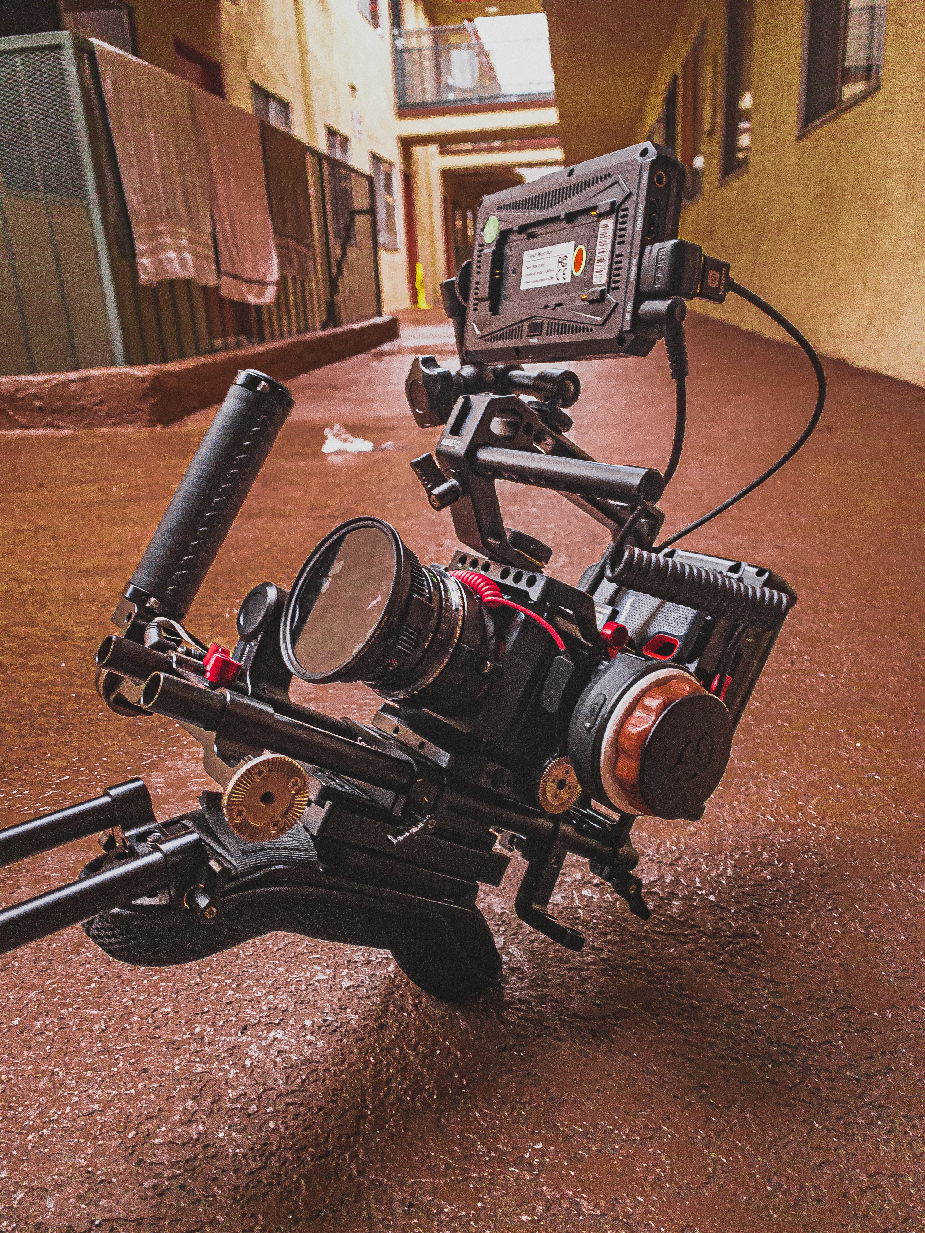

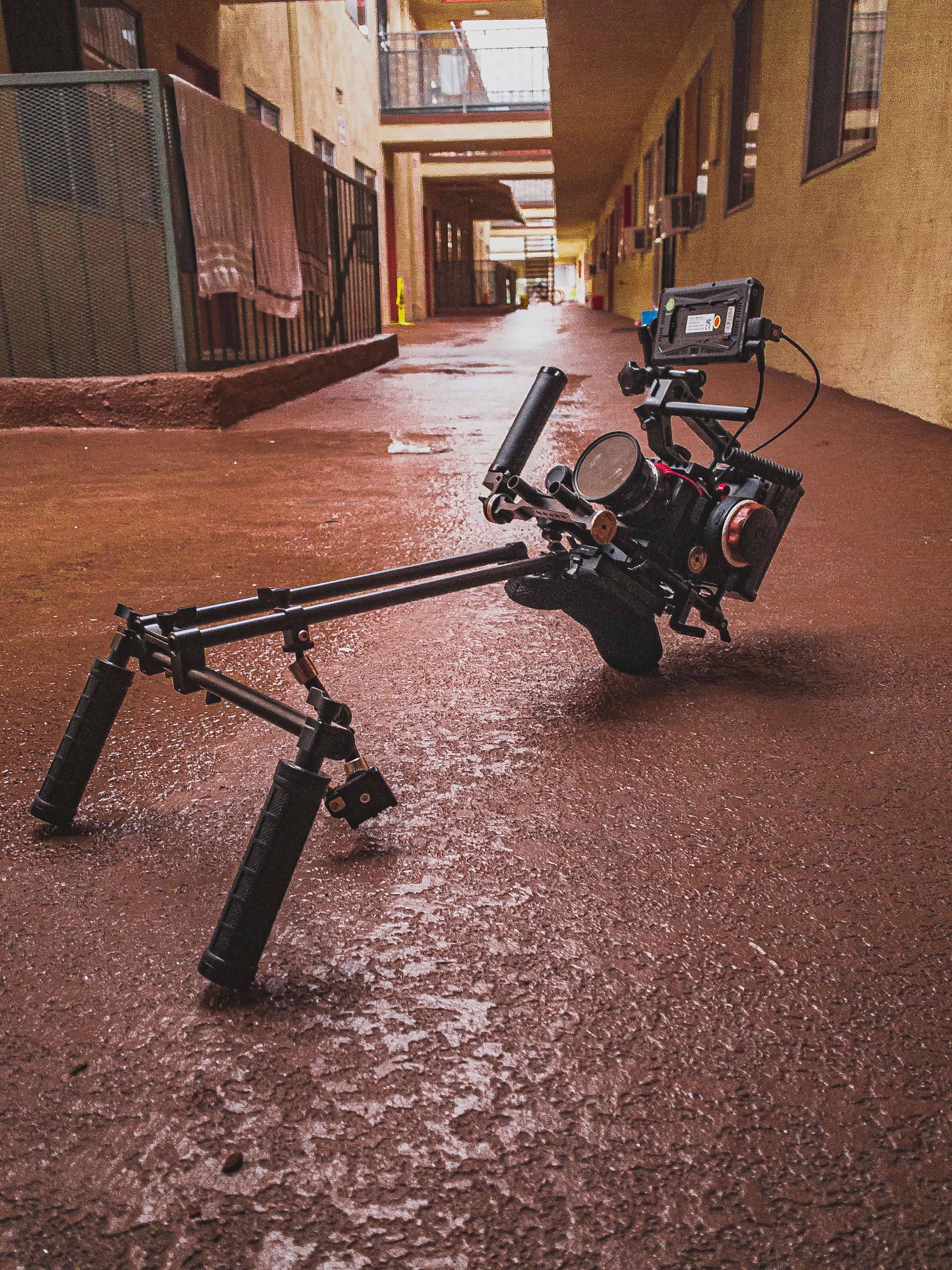

ktfright Posted March 14, 2020 Share Posted March 14, 2020 Just an update on my current setup. I really want a sigma 18-35 f/1.8 techie, Patrick B. and andrgl 3 Link to comment Share on other sites More sharing options...
