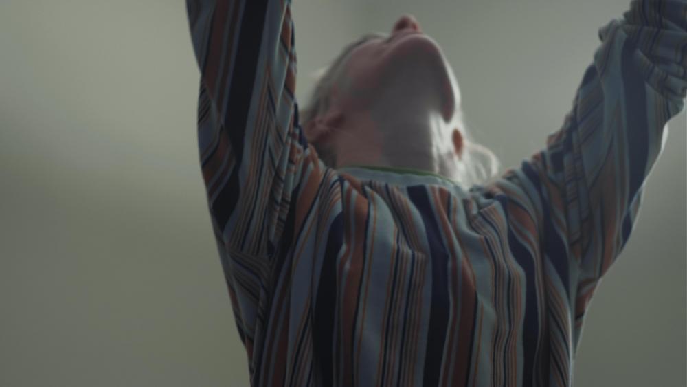

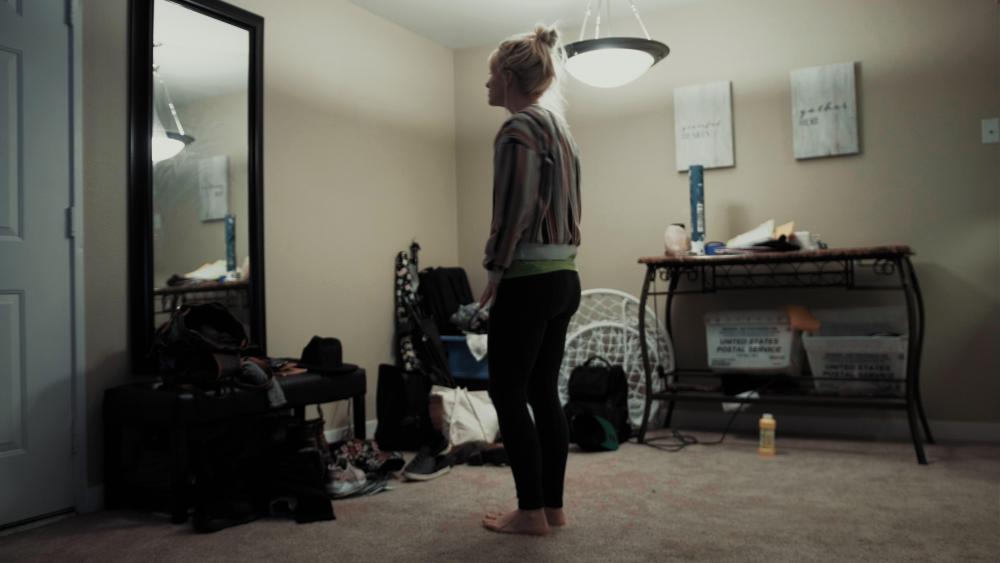

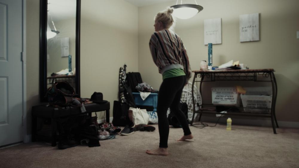

I don't know if this has been addressed here but I'm finding some issues with flog with the xt3. Has anyone experienced these "pink splotches" before? These were shot in 10bit H.265. I'm finding that the HLG doesn't suffer from this issue. I placed a lut to emphasize the issue. Any help would be appreciated!
Yes this issue was discussed extensively on this forum, see my post comparing F-log and HLG. There's something wrong with Fuji's F-log implementation, could be flaws in the encoding parameter. The solution is to shoot HLG instead, it's completely clean and in my opinion also offers better colourimetry than F-Gamut.
Please report this issue to Fujifilm by sending these photos along with a description http://www.fujifilm.com/contact/
We have to get Fujifilm's attention for a possible fix.

One thing I've discovered - and this might help some people - is that the rendering settings in Premiere can create extreme banding and blotches in your h256 footage once you apply a lut.
I had terrible problems with this on my Mac, before I realised I'd accidentally created a sequence with the Metal hardware acceleration setting selected under Project settings. When I changed it to OpenCL, the banding went away completely.
Might be something worth playing with. I usually find Software rendering to be the most reliable for quality, albeit by far the slowest.

Any chance you could share the original for this clip? Just the F-Log one.
I personally use Davinci and I have never seen banding on my X-T3 footage. Not once.
Did some tests, inside and outside, couldn't replicate the issue. However I see that F-Log has a messier red channel, so if you're unlucky, you could absolutely run into situations where the difference is as pronounced as in John Roque's examples. If there's an issue here, it must be about compression. That being said I wouldn't recommend against F-Log just yet, I never had any problems so far.
