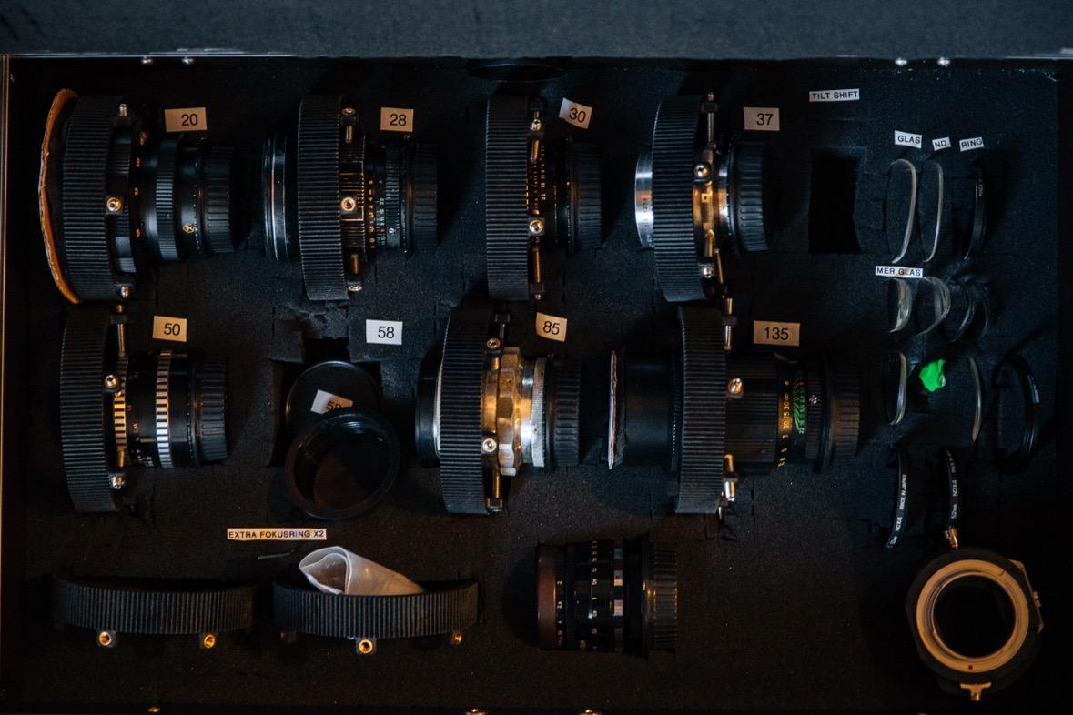

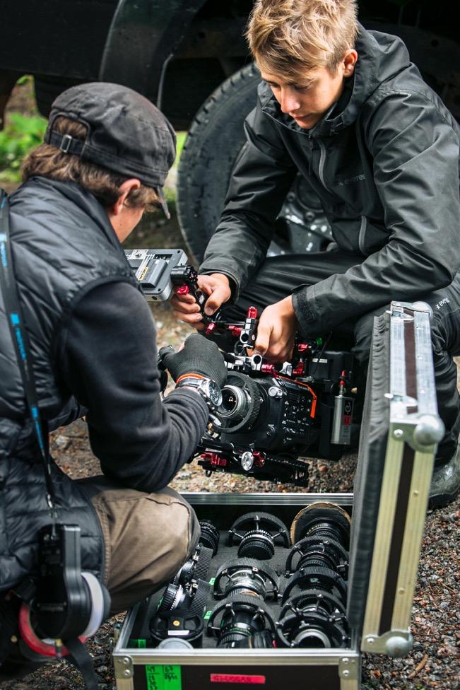

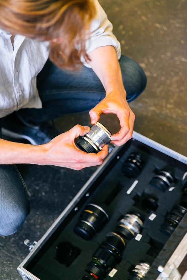

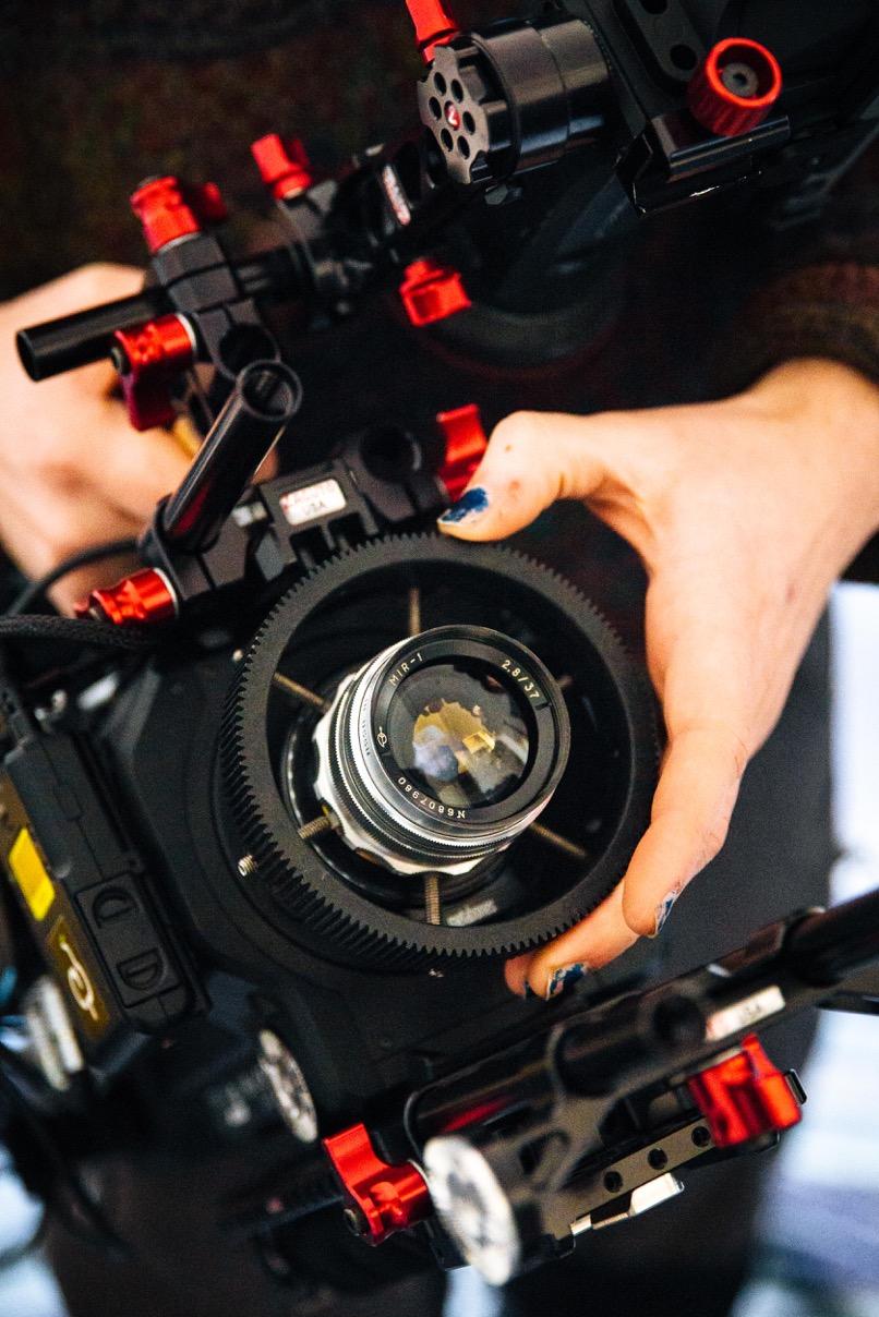

Brother Posted June 24, 2018 Share Posted June 24, 2018 I have nothing to do with this film other than i think it's amazing! They've been, like they always are, very open with everything through out the whole process. Including gear which is why i thought it would fit here on EOSHD. Premiered on Swedish cinemas four days ago. Total budget: $2M, shot on FS7 and vintage Russian lenses. More info below. Director Victor Danell on Facebook: "Last year I directed my first feature. Me and the DP wanted a lifeful and ”not so perfect” look to keep the story grounded, so we decided to shoot on vintage lenses. I relubed and added a oval iris on every lens my self. Shot on a Sony FS7 This is the complete set of lenses we used. A total price of less then $800. 20mm - Mir 20a 28mm - Mir 10a 30mm - Meyer-Optik Görlitz Lyidth 37mm - Mir 1a 38mm - Helios 44-2 + DSO wide angle adapter 50mm - Carl Zeiss Jena Pancolar 58mm - Helios 44-2 85mm - Jupiter 9 135mm - Tair 11a THE UNTHINKABLE / DEN BLOMSTERTID NU KOMMER http://www.imdb.com/title/tt5227746/?ref_=nv_sr_1" BTM_Pix, webrunner5, TwoScoops and 2 others 5 Link to comment Share on other sites More sharing options...

Danell Posted June 25, 2018 Share Posted June 25, 2018 11 hours ago, Linus N said: 1. One thing I found very intriguing was the non-Swedish-movie factor of your film. With this I'm referring to script, compositions, audio, sfx, vfx, camera movements, blocking, dialogue etc.. I very much enjoyed the "non-Dramaten-feeling" of the script/delivery from the actors. Was the whole step-away-from-the-Beck-vibe a conscious direction you took, and how did you go about it? 2. In terms of the vintage lenses, how on earth did you fit all the accessories on there? Seems like a tight fit! 3. Without spoling anything for anyone, I believe I spotted a few hommages to a variety of classic films embedded in The Unthinkable. if my observation is correct, do I win a cookie? Preferably a dammsugare, I love those. 1. Thank you! I really appreciate this. We don't really think so mush about this, we just do films the way we like to watch films ourself. (and we don't watch a lot of Beck) 2. It wasn't that hard. I attach some BTS stills of the camera 3. Of course! Easter eggs from most of my favorite films can be spotted in the movie. I'll send you a dammsugare if you can spot homages to The lord of the rings, Jurassic Park, Lost and Home Alone. I think this is the numbers you are looking for: 120 shooting days 79 hours of raw material 420 vfx shots 19 crashed cars Over 1000 extras 360 000 liter rain 3 broken bones 82 locations 3000 liter coffee 7 liter fake blood mercer and Aussie Ash 1 1 Link to comment Share on other sites More sharing options...
Danell Posted June 25, 2018 Share Posted June 25, 2018 12 hours ago, mjfan said: did you have just one camera? which camera settings did you use? what did you do for sound? thanks and great job! We used the Sony FS7 for 95% of the shots, and a Sony A7s mkII for the rest. Mostly when shooting in tight spaces, crash-cam stuff and the few times we needed more then 1 camera. Everything is shot in SLOG3, XAVC-I, 23,976 fps. (24fps wasn't available when we started shooting) This is the sound gear we used: - Recorder: Sound Devices 688 - Wireless: Wisycom MCR42, MTP30 - Mics: Sennheiser MKH50, Neumann KMR81, DPA Microphones 4060, 4098, 4018 - Timecode: Ambient Recording GmbH Timecode Link and ACD301. Link to comment Share on other sites More sharing options...

zerocool22 Posted June 25, 2018 Share Posted June 25, 2018 What lenses did you use most? Or what were the favorite lenses you used? Not surprised about going the vintage route, allthough I would have gone for more pricyer vintage lenses like the contax or summicrons. What was the decision criteria there? Budget or specific looks? And surely impressed how good you made the FS7 look Link to comment Share on other sites More sharing options...
Danell Posted June 25, 2018 Share Posted June 25, 2018 15 minutes ago, zerocool22 said: What lenses did you use most? Or what were the favorite lenses you used? Not surprised about going the vintage route, allthough I would have gone for more pricyer vintage lenses like the contax or summicrons. What was the decision criteria there? Budget or specific looks? And surely impressed how good you made the FS7 look Budget + look. We could afford more expensive lenses, but the look of the Russians were exactly what we wanted for this project. Together with the oval iris we added to all of the lenses they looked like vintage lenses, but without the cost, weight and headache that comes with real anamorphics. I think my favorite lens was the Helios 44-2 together with Richard Gale's wide angle adapter. The character is out of the world! zerocool22 1 Link to comment Share on other sites More sharing options...
