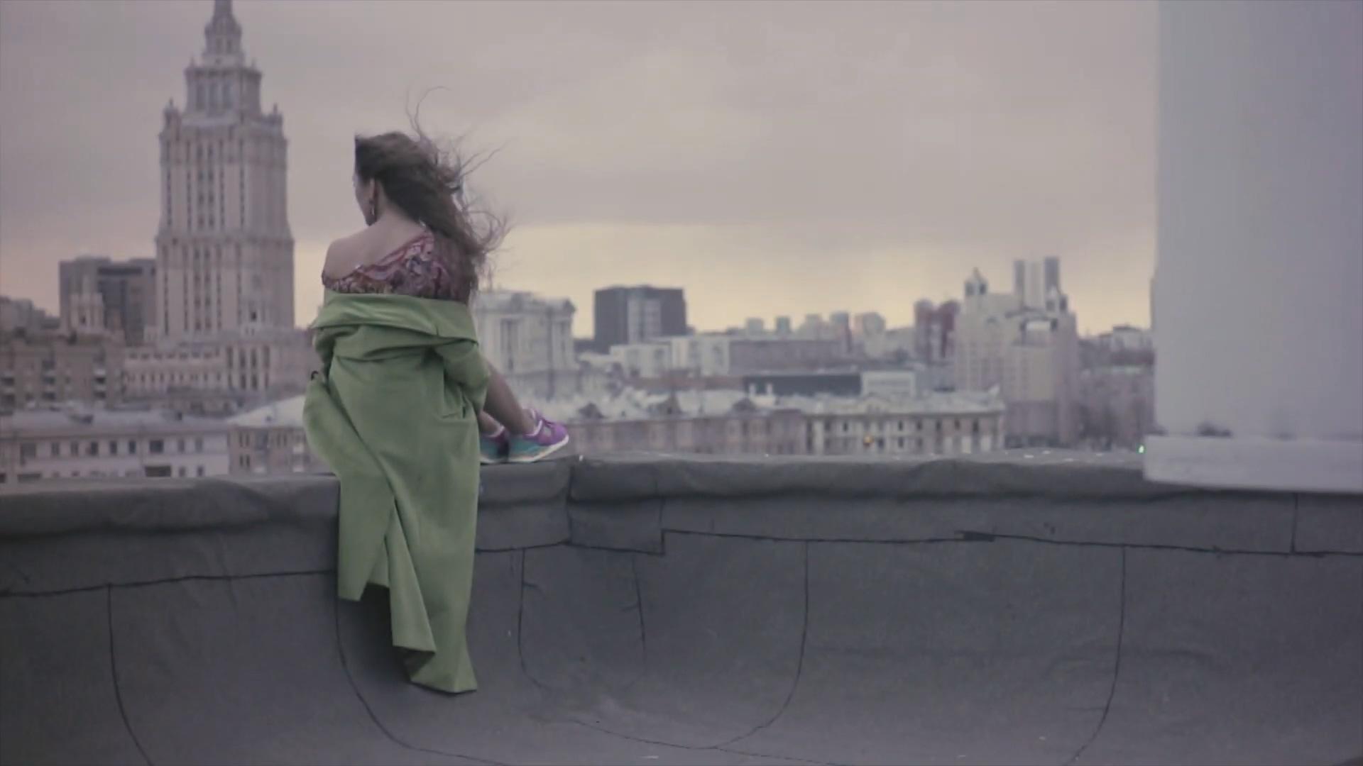

webrunner5 Posted April 19, 2019 Share Posted April 19, 2019 4.5K Raw. I really like the look of this one. Link to comment Share on other sites More sharing options...
youshouldtry11 Posted April 20, 2019 Share Posted April 20, 2019 11 hours ago, webrunner5 said: 4.5K Raw. I really like the look of this one. very nice video! I think the highlight is a bit 'hot'? webrunner5 1 Link to comment Share on other sites More sharing options...
webrunner5 Posted April 20, 2019 Share Posted April 20, 2019 I think in a lot of it, especially in the beginning, can be attributed to the super shallow DoF it has. That is something in bright conditions you really have to be aware of as it draws your eyes away from the main subject. Doing that over emphasizes the bright parts and appears overexposed, which in parts I am sure it is. I am not a big fan of super fast lenses, it just makes overall shooting a Lot easier to make mistakes, Not counting expensive. That is Not what a person needs lol, especially on the Video side. Now it might have been shot on a long Telephoto lens from a distance, who knows. But the danger still exists doing that. Ahh info said it was shot on a Canon Pancake EF-M 22mm lens. You can bet your Buttocks it was set to f2 a Lot lol. But I thought the hair on the woman was beautifully exposed and had a ton of detail. Perfect exposure through and through, no, but pretty damn impressive CS and resolution for a camera that cost just peanuts to buy. Emanuel 1 Link to comment Share on other sites More sharing options...
Emanuel Posted April 23, 2019 Share Posted April 23, 2019 With a LUT from the usual suspect our good fellow @ZEEK who has also added this piece in the meantime: webrunner5, Alpicat and heart0less 3 Link to comment Share on other sites More sharing options...
heart0less Posted April 23, 2019 Share Posted April 23, 2019 Gosh, this really looks like film. What a beast EOS M is.. Link to comment Share on other sites More sharing options...
Emanuel Posted April 25, 2019 Share Posted April 25, 2019 And here's a grab from that clip (handheld shot! : -) heart0less and webrunner5 2 Link to comment Share on other sites More sharing options...
