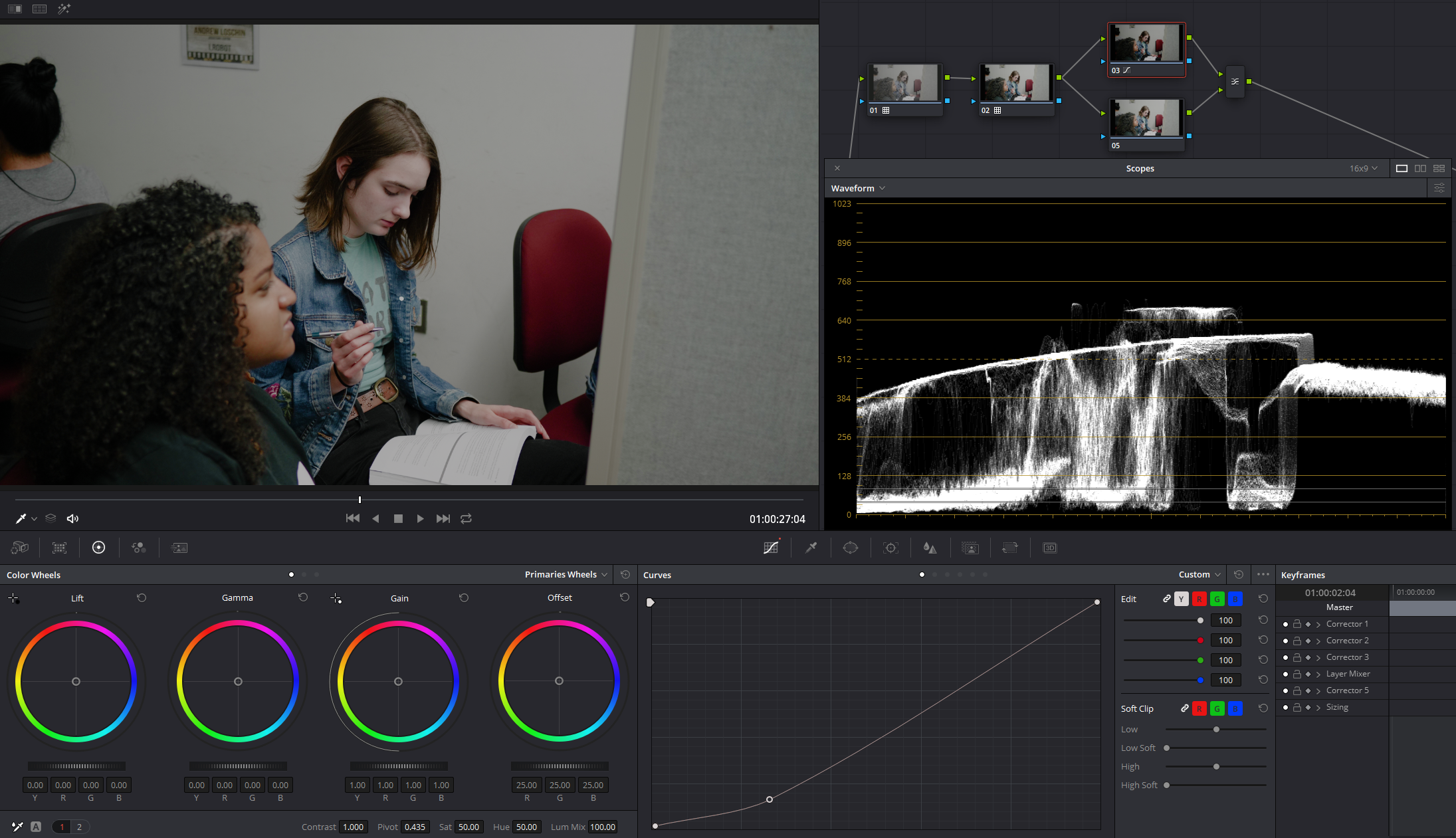

kye Posted November 18, 2018 Share Posted November 18, 2018 @Sage I have shot a bunch of footage at night with HLG at various exposure levels (ETTR as well as ETTL to keep highlights) and I'm wondering how to pre-process the footage in post to get the right levels for the LUTs. At what step in the Resolve node graph would you suggest adjusting the exposure back so skin tones are in the recommended 40-60 IRE, and which controls would you suggest (perhaps either the Gamma wheel or the Offset wheel?). Thanks! Link to comment Share on other sites More sharing options...
Sage Posted November 18, 2018 Author Share Posted November 18, 2018 @kye This is best accomplished by swapping the luma curve layer mixer structure with the conversion node. This way, black level and gamma may be set ahead of the conversion. Going forward, opt for moderate exposure, so that the luma stage may follow the conversion. Moderate exposure will allow substantial highlight range, while steering clear of the noise floor kye 1 Link to comment Share on other sites More sharing options...
