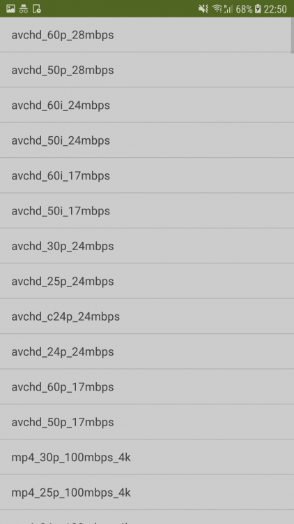

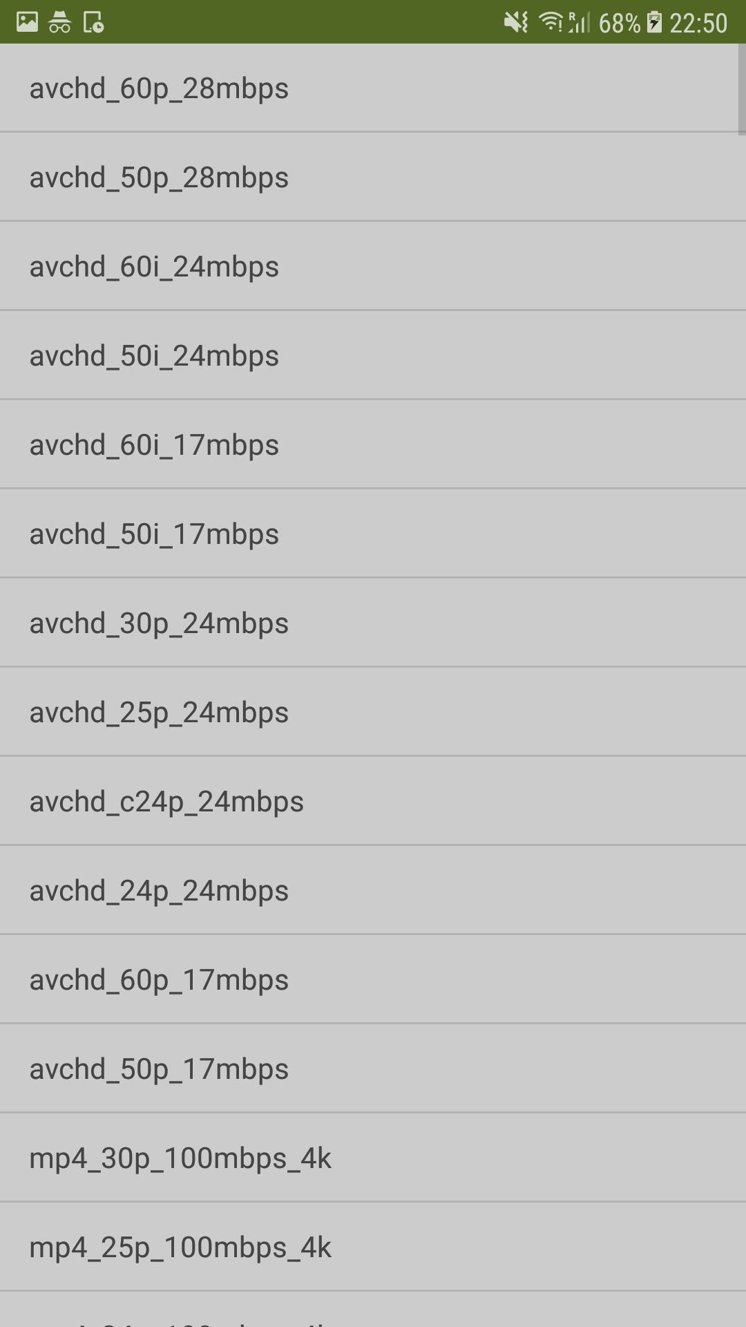

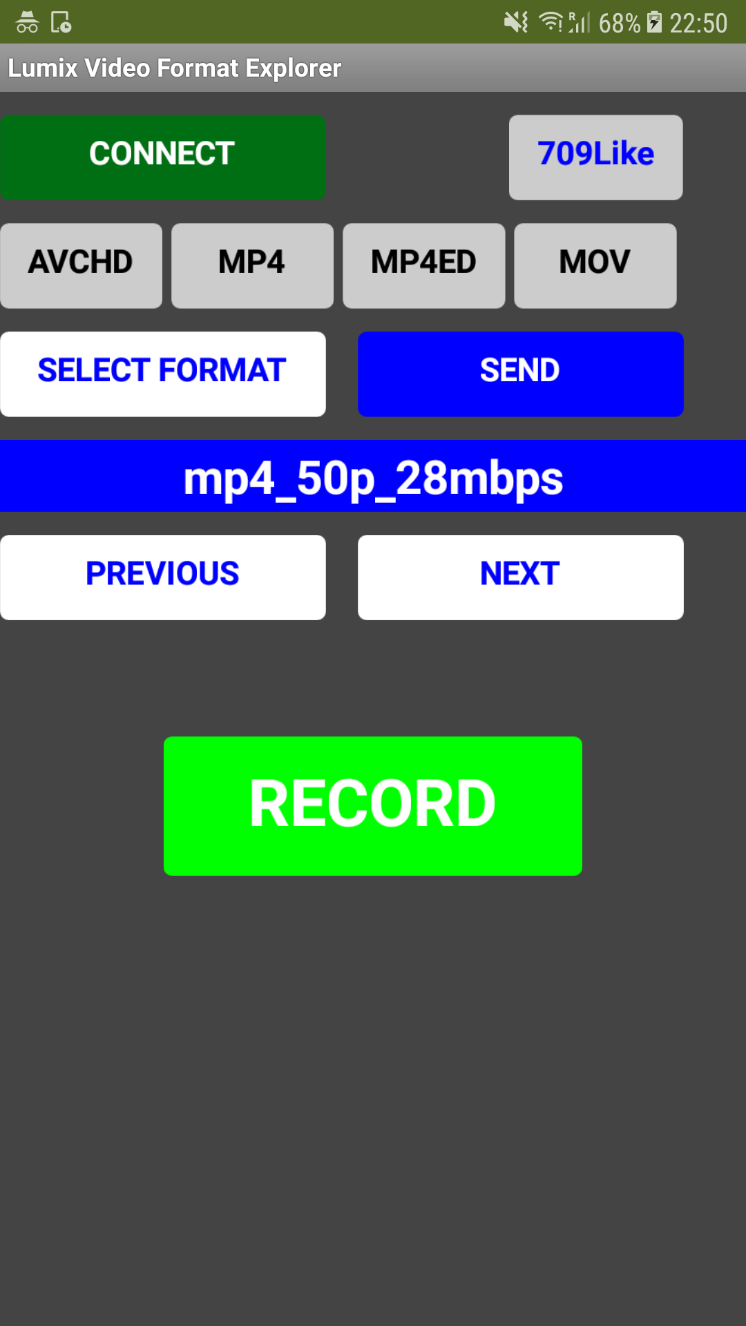

Super Members BTM_Pix Posted August 12, 2019 Author Super Members Share Posted August 12, 2019 OK for @jase or anyone else who wants to prod about in a bit more of a structured manner on their Lumix device, I have just knocked up this rough and ready Lumix Video Format Explorer app for Android. Usual story, attach your camera to your device over wifi and then open the app and hit the CONNECT button and your camera should clear its wifi screen and show that it is under remote control. If you want to see if the 709Like profile works on your camera then just hit the 709Like button and see what happens. Certainly does nothing on the GX80 but it seems to on the GX9 so its worth a go on similar later cameras. The next 4 buttons switch the video format of the camera and the MP4ED appears to populate the GX9 with additional options but again, nothing on the GX80. Next up, we have the SELECT FORMAT button. When you press that, you get this list (which scrolls to several pages). This is the list of every format returned from a probe of the GH5 so select the one you want to try and it will return you to the main screen with that one now shown in the blue banner beneath the SELECT FORMAT and SEND button. Obviously to send the currently selected recording format you then hit SEND. Beneath the blue banner are the PREVIOUS and NEXT buttons which will select the next recording format in the list and then automatically send it to the camera. The reason for the two different methods is obviously so you can use the list selection to get to a specific one you want rather than scrolling through and the PREVIOUS/NEXT auto method is better for stepping through regions of formats (i.e just the AVCHD ones). Finally, the RECORD button is a bit self explanatory and switches between red and green depending on status. The purpose of having the file name in the bigger banner is so that for testing you can point the camera at the phone (on a stand or propped up ideally) and then when you review the recorded file you will have a visual indicator of what file format you had told it to record in for easier confirmation. If you send the camera some file formats it really doesn't like then certainly on the GX80 this can sometimes result it in de-populating its list inside the camera (i.e. you can select MP4 but there are no different formats listed) but this can easily be resolved by choosing a known working format from the list and sending it which will restore the list. For the GX80 an example of this will be mp4_24p_100mbps_4k As this contains the full list of all 202 GH5 format variants, I'd probably say this is the definitive last hurrah for anyone trying to find any hidden type inside their Lumix cameras and is obviously fastest and the most structured way to do it so will be less painful than having to paste hundreds of commands into a browser. I think that this will be more fruitful for the latter cameras based on what seems to be happening with the GX9 so if you have one of those then using this you might be able to find more gold with that one a bit quicker. Also, if you come across someone with an LX100 Mark 2 then this app will let us quickly establish if there is anything in there as I now have a sneaking feeling there might be. Usual caveats regarding use of this app is that it doesn't send any commands other than those sent by the Panasonic app but obviously use of it is at your own risk. Your Android device should auto install the attached apk file when you download it but make sure you have your security settings set to allow installation of apps from “Unknown sources“. LumixVideoFormats.apk Marcio Kabke Pinheiro, billdoubleu, pauli and 2 others 2 3 Link to comment Share on other sites More sharing options...
