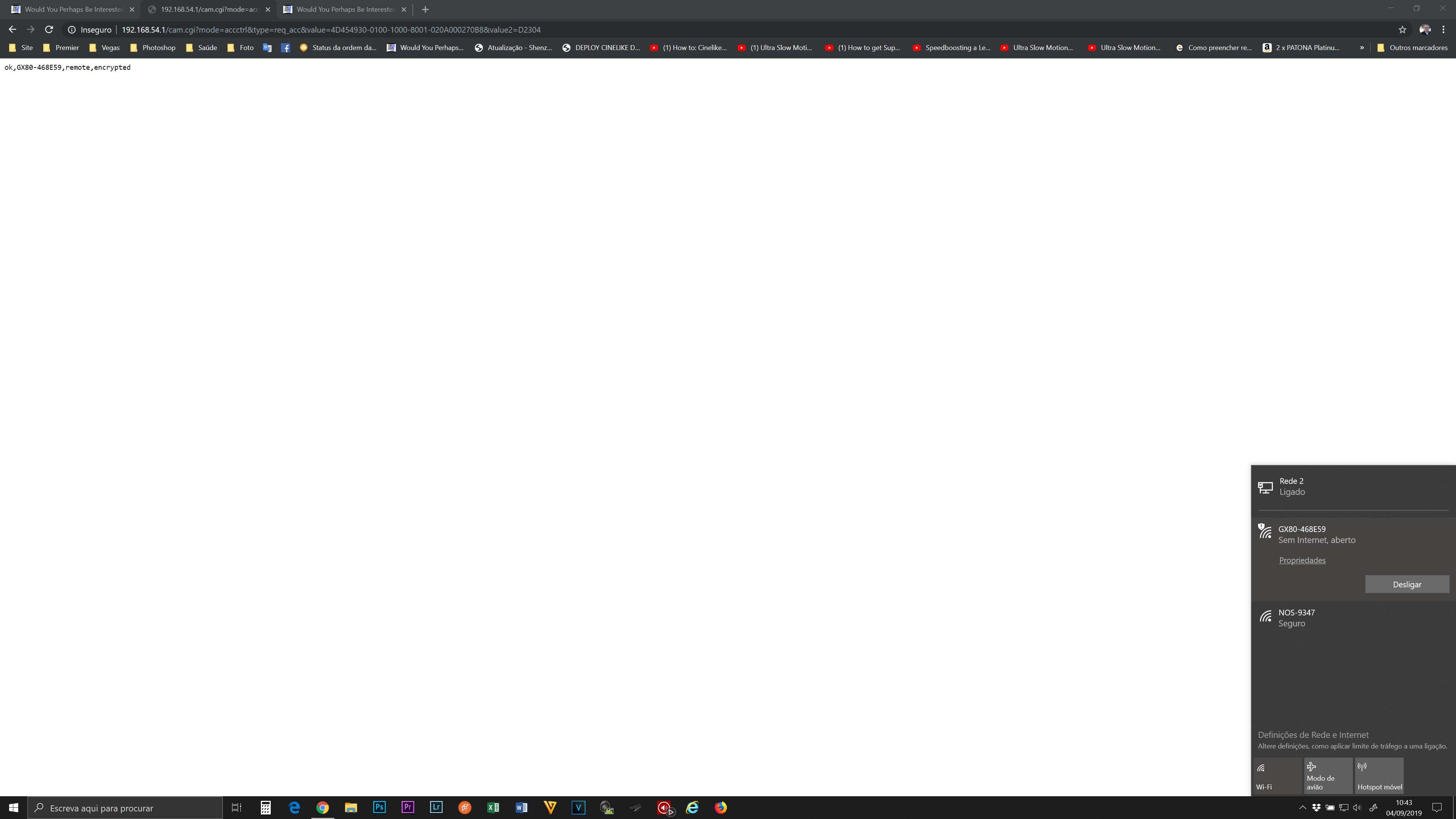

I just want to install the Cine Like D profile
I tried the previous method again, but it stops for this message "ok,GX80-468E59,remote,encrypted" and does not advance
What can I do?

On 9/4/2019 at 6:50 AM, Armando Jorge said:
Thanks for the answer BTM
I tried LumixVideoFormats-2.apk, but hanshake didn't work either

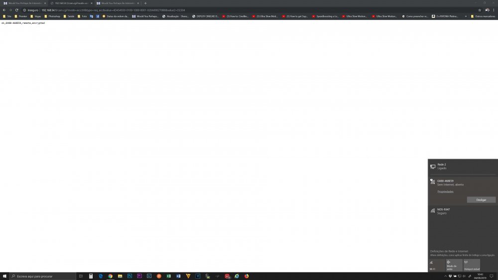

I tried the previous method again, but it stops for this message "ok,GX80-468E59,remote,encrypted" and does not advance, as attached image.
What can I do?
