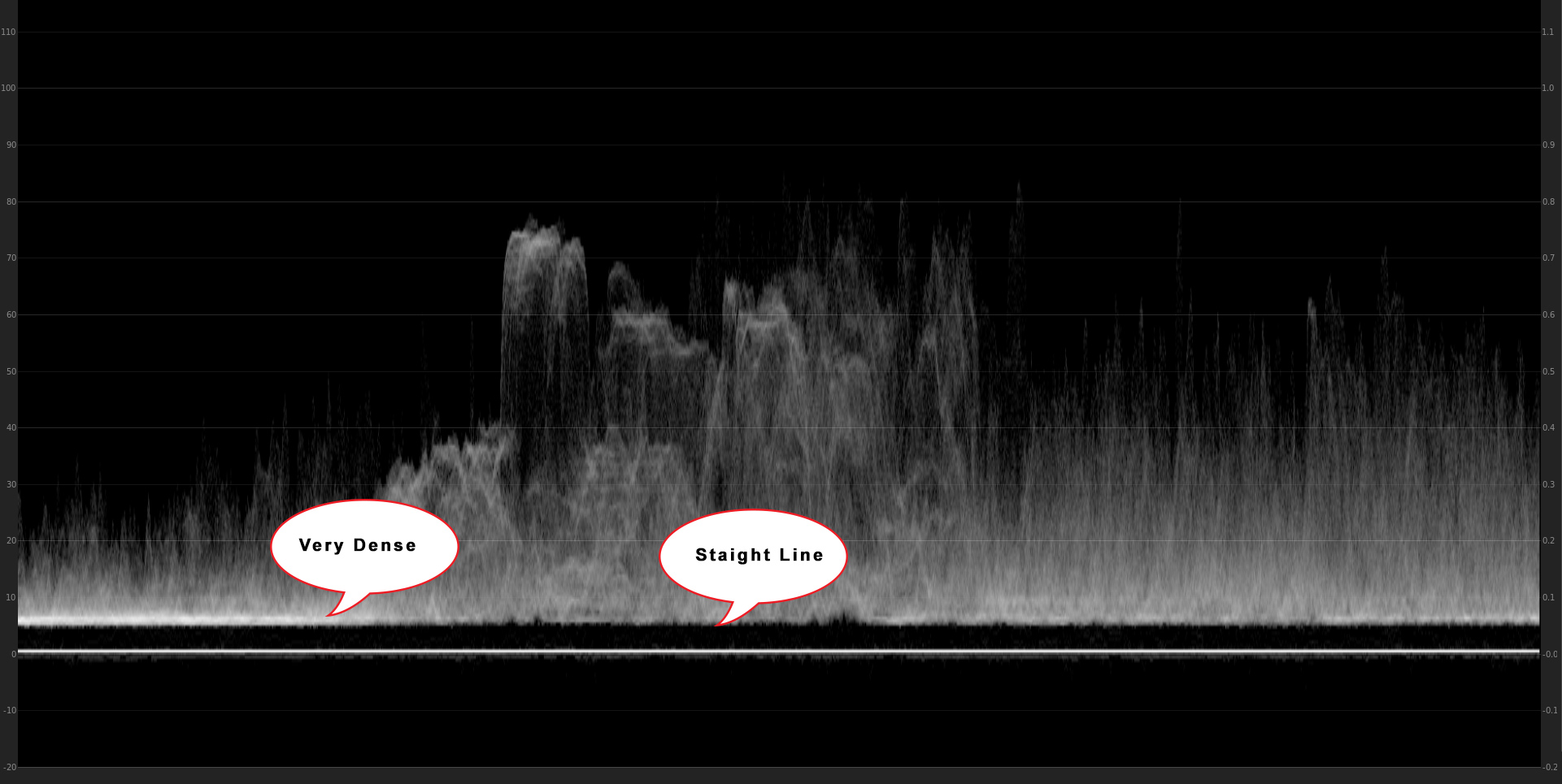

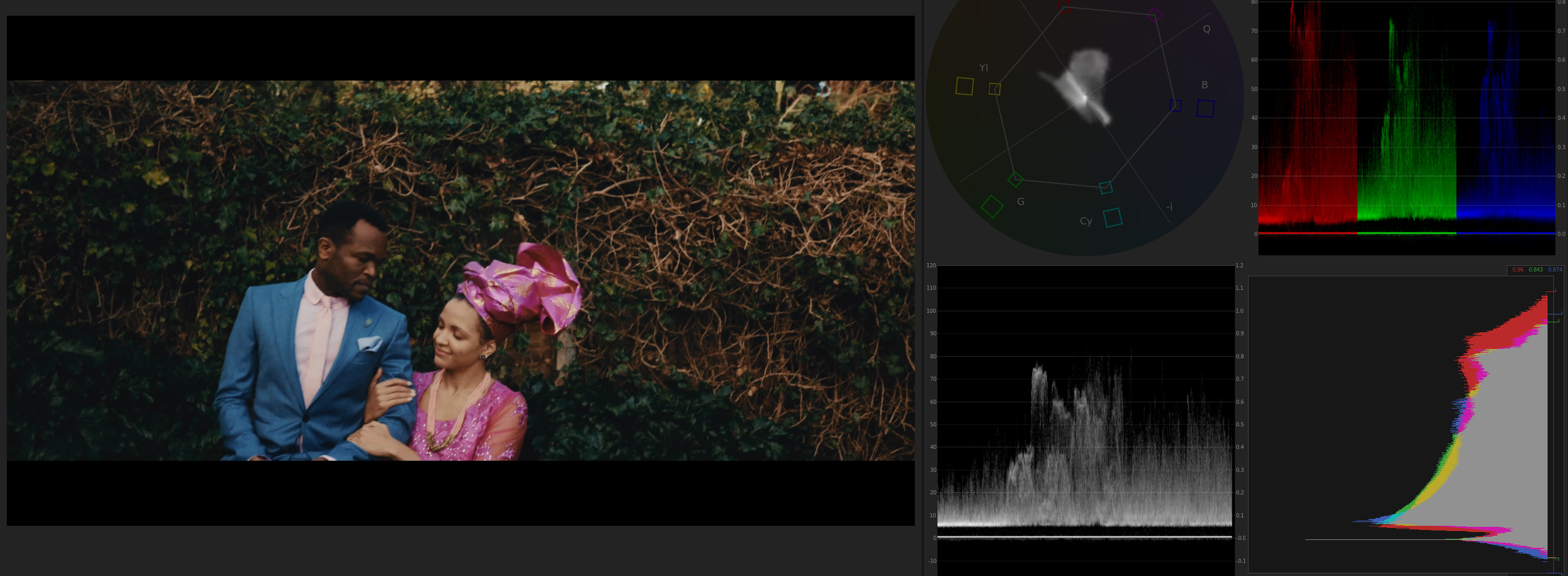

Cary Knoop Posted December 29, 2016 Share Posted December 29, 2016 Great work! One thing though, your black level floor is raised. If you want to get more shadows you should expand your shadows but if you simply raise the floor the only thing you will get is more compression artifacts and washed out dark colors . PannySVHS 1 Link to comment Share on other sites More sharing options...
PannySVHS Posted December 29, 2016 Share Posted December 29, 2016 @deezid, Hey, colors and footage looking fantastic! Gonna repost that in the GX85 thread, since it´s spinning dizzy about Panasonic color:). Your achieved look is just too beautiful! @Cary Knoop Does that mean you would pull the blacks all the way down to 0? So screenshot is before your recommended adjustments, right? cheers Link to comment Share on other sites More sharing options...
Cary Knoop Posted December 29, 2016 Share Posted December 29, 2016 1 minute ago, PannySVHS said: @Cary Knoop Does that mean you would pull the blacks all the way down to 0? So screenshot is before your recommended adjustments, right? cheers The problem here is that the blacks are more or less clipped, the floor looks like a straight line and it is very dense right above. It seems the shot was underexposed in camera. You could try to expand the dense area towards black using a secondary color correction. PannySVHS and webrunner5 2 Link to comment Share on other sites More sharing options...
