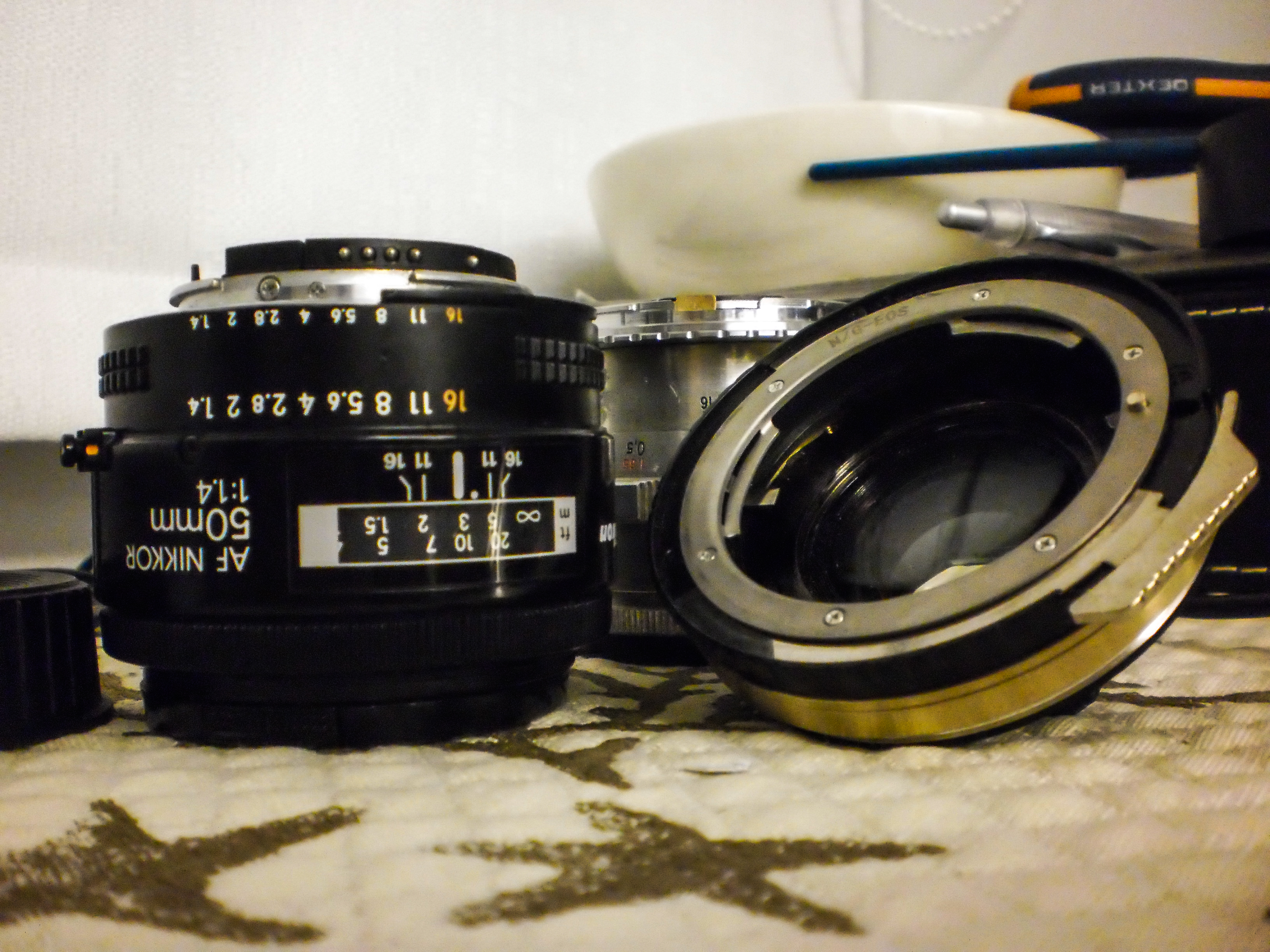

lucabutera Posted August 7, 2016 Author Share Posted August 7, 2016 14 hours ago, cojocaru27 said: nice work luca, thx for the effort. May i ask you what happen to the nikon adapter? As you, i have the nikon 50 1.4d lens and i would love to see some updated tests with this lens. What is the status on this one? This is shot with Nikon Nikkor 50mm 1.4 AF + NXL speed booster Prototype. cisco150 1 Link to comment Share on other sites More sharing options...

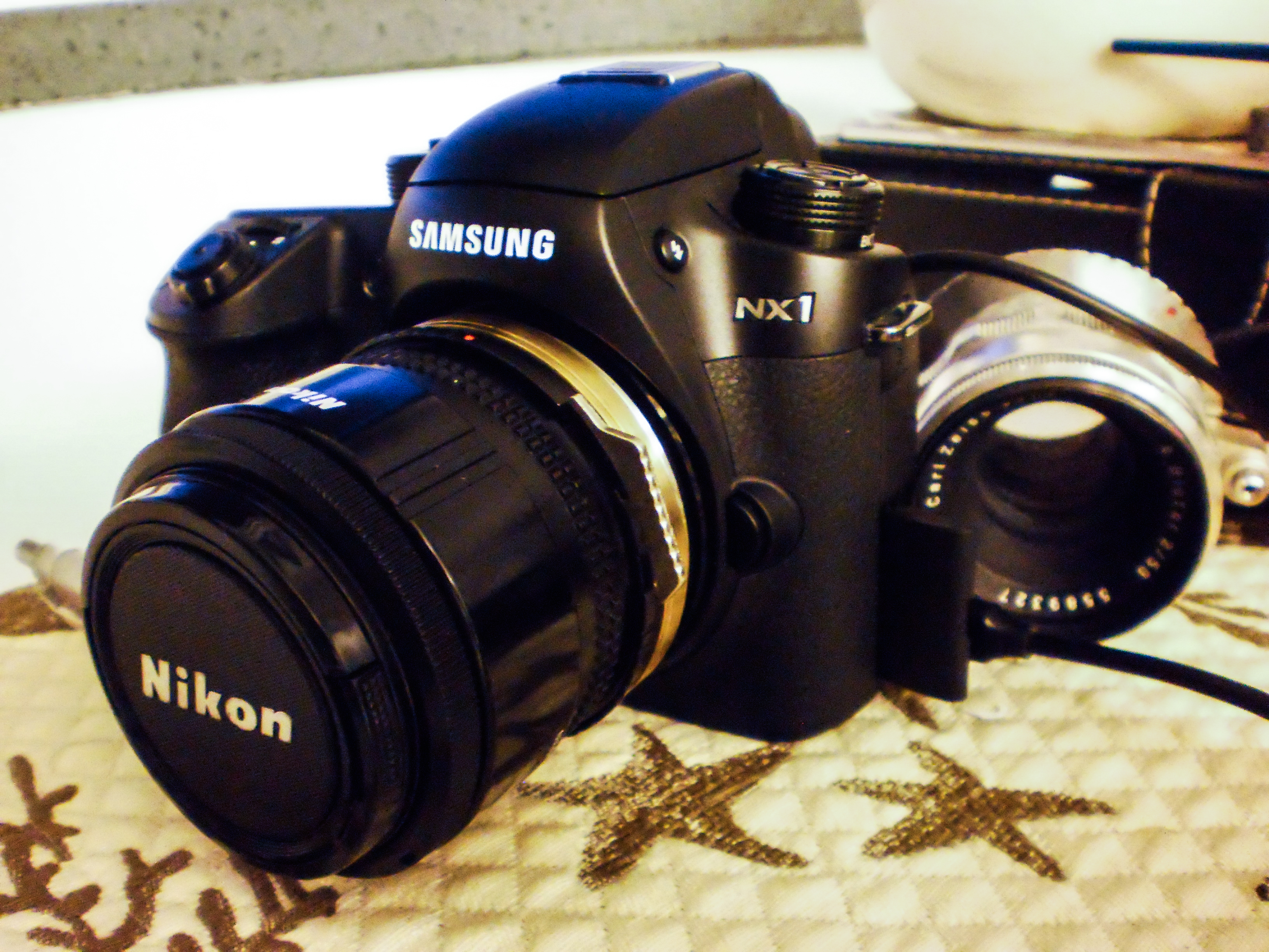

cojocaru27 Posted August 8, 2016 Share Posted August 8, 2016 it looks really promising luca. looking forward for it to be available. do u have an aprox deadline? and some pictures with the adapter and the lens on top of nx1 would be awesome. thx a lot. Link to comment Share on other sites More sharing options...

lucabutera Posted August 8, 2016 Author Share Posted August 8, 2016 10 hours ago, cojocaru27 said: it looks really promising luca. looking forward for it to be available. do u have an aprox deadline? and some pictures with the adapter and the lens on top of nx1 would be awesome. thx a lot. This is the NXL SB "for all lenses". Liam, sandro, MountneerMan and 3 others 6 Link to comment Share on other sites More sharing options...
