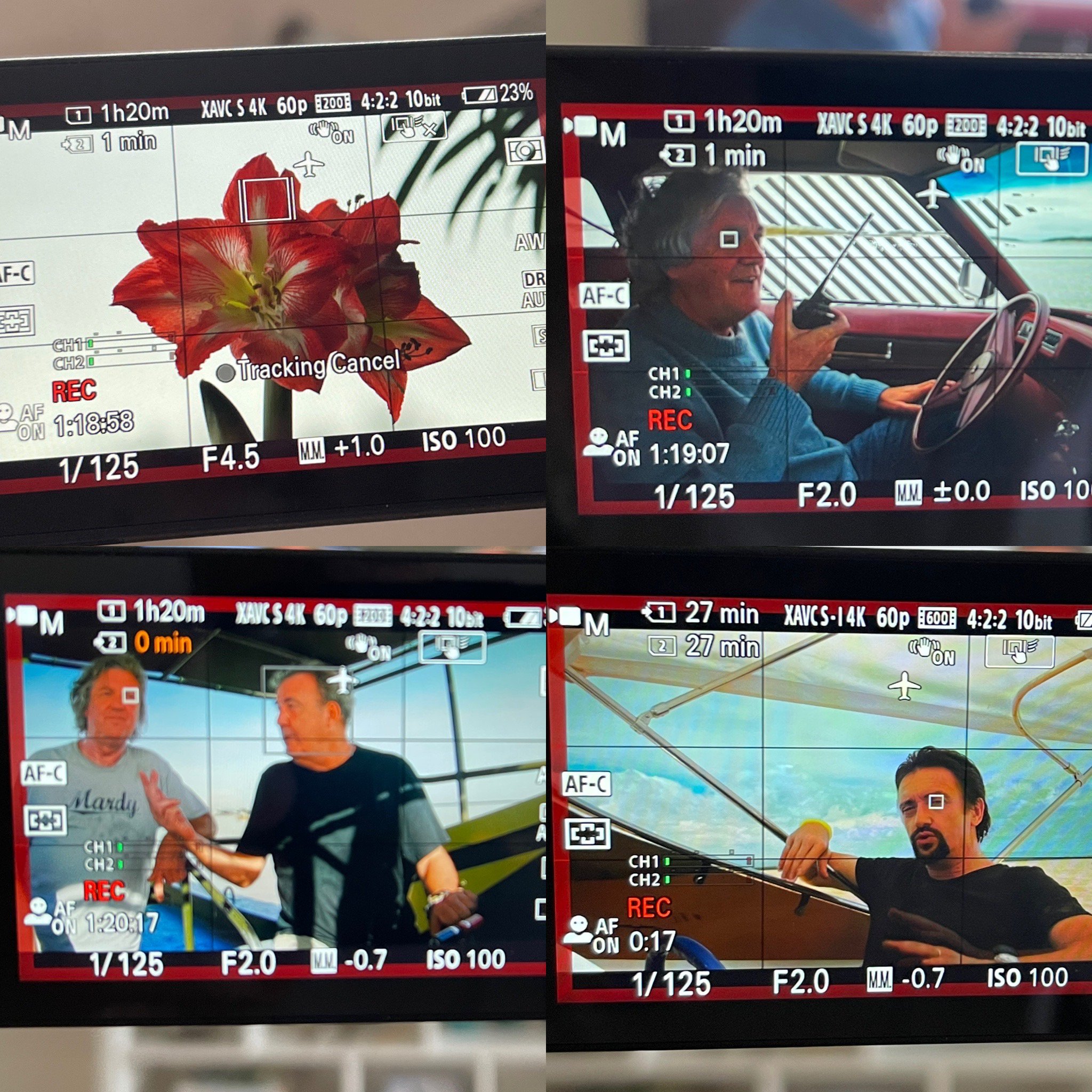

Trek of Joy Posted January 5, 2022 Share Posted January 5, 2022 So I decided to take a look at my copy after seeing this and the thread on Fred Miranda. If anyone is getting fast overheating times, I'd return it - you have a dud. I'm at over 4 hours of 4k60p and counting, only stopping for battery swaps and to reformat the card. Batteries have been at about 35% when pulled. With the settings below my 128gb card can only record for 1hr 20min so I've been stopping it just before its full. Batteries are warm to the touch, but not anything to worry about. Same for the back of the body where the LCD screen sits, I don't even have a temp warning yet. My settings with a 128gb Prograde V90 card: XAVC S - 4k60p - 10 bit 422 - 200mbps AF-c - wide area - Face/eye detection and touch tracking on Screen out like I always shoot Airplane mode to prolong battery life (always unless I'm transferring files) Temp warning set to high I started with the FE 85 just pointing at a static scene in my 77 degree apartment with the camera in front of the heater so it was blowing warm air on it. I hit tap to track on the flower as you can see in the image, so tracking was constantly engaged the whole time. I stopped it just before the card was full after almost 1hr 20min of recording. Then I moved to pointing it at the TV and swapped to the FE 35 to bootleg The Grand Tour (haven't seen the latest one, no spoilers LOL!). This should generate more heat since the camera would be busy detecting faces/eyes and tracking them - which it did beautifully. No heat warnings at all. This is far better than my a7III and absolutely crushes the a6300. I've never done a test with my a7sIII because it doesn't need it, but these results are far beyond what I should ever use. I'll try bumping to XAVC SI and the 600mbps bitrate, but I never shoot that because my 128gb cards only hold about 27 min of footage and after a year and a half with the a7sIII I don't see a difference with XAVC S. That said I have zero reservations about using the a7IV for my work as I've never recorded a 1hr 20min take - the longest for me is sunrises/sunsets at about 45 minutes from start to finish. I edit in 24p, a full 128gb card of 60p footage would be 3 hours slowed down. The photo shows the end of the three consecutive takes filling my cards and the switch to SI and its massive bitrate on the bottom right. Note the sweet eye AF LOL! Cheers Chris Link to comment Share on other sites More sharing options...
