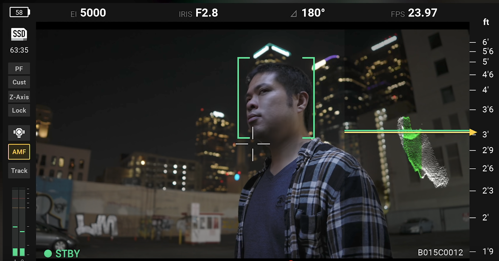

ntblowz Posted October 20, 2021 Share Posted October 20, 2021 That LIDAR Waveform focus asset is quite awesome, way more advanced than peaking for manual focus. IronFilm 1 Link to comment Share on other sites More sharing options...
A_Urquhart Posted October 20, 2021 Share Posted October 20, 2021 41 minutes ago, ntblowz said: That LIDAR Waveform focus asset is quite awesome, way more advanced than peaking for manual focus. I’ve been asking a few range finder manufacturers for this very feature and DJI have implemented it very well! Camera/Gimbal looks kinda weird but DJI have done an amazing job. Without using it, I can’t think of a single thing DJI have left out of it that I need. I do a lot of B Camera gimbal work and if that 4th axis works as well as advertised, then the biggest issues with gimbals have been solved with this . Firstly, rigging and balancing them up with different bodies and lens combos can be tedious and getting them as smooth as a Steadicam on the 4th axis still requires some kind of vest/Steadicam type setup. This looks to have solved these issues for the most part. Interchangeable lens mounts, internal ND, great codecs, and a clean menu system that looks to rival Blackmagics……this thing has it all! ….now if it can make me an espresso on set l….. 92F 1 Link to comment Share on other sites More sharing options...

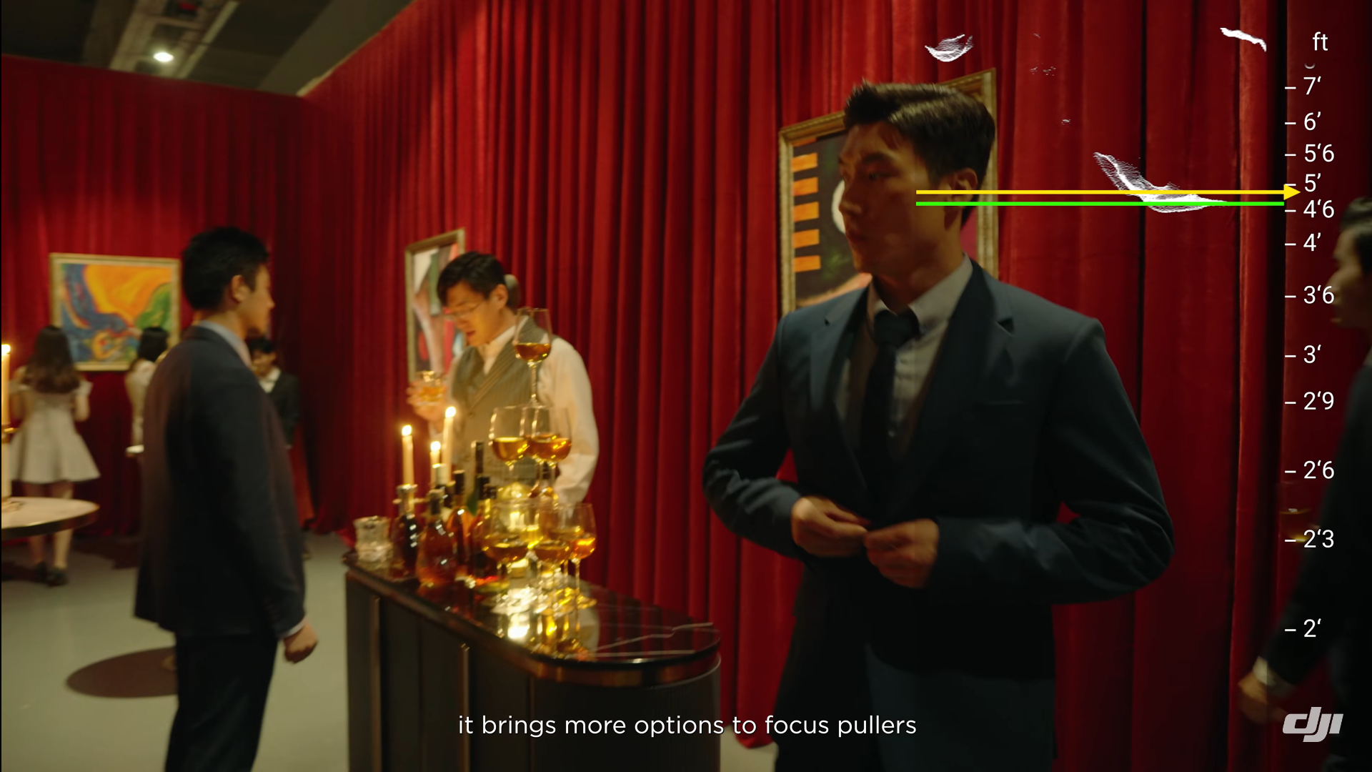

IronFilm Posted October 21, 2021 Share Posted October 21, 2021 https://youtu.be/TiVJnRXUwKw?t=418 These LiDAR waveforms look incredible! Wonder how it is in real life. Is anybody else doing this already? Been chatting a lot today with a high end professional 1st AC I know. Seems that nobody else is doing exactly this. Perhaps the closest to this that exists might be this: But they're using this blocky bar chart method of displaying the info, which is neither as informative or as elegant as showing a focus waveform like DJI is showing off. Link to comment Share on other sites More sharing options...
kye Posted October 21, 2021 Share Posted October 21, 2021 16 minutes ago, IronFilm said: But they're using this blocky bar chart method of displaying the info, which is neither as informative or as elegant as showing a focus waveform like DJI is showing off. I think you nailed it by calling it 'elegant'. So simple, especially colouring the face-detect with green, but very powerful. I can imagine future updates having another colour for the other faces detected in the scene and showing them as well, which would be great for focus pulls during dialogue scenes. What do you think of the ergonomics and image? Do you think that there would be people willing to use this on a set that could afford a cine camera and a gimbal / steadicam? I have no idea how DJI is regarded at the ARRI level of film-making. I'm assuming that if you wanted to fly an Alexa Mini or Komodo you'd be using one of the high-end DJI drones? Link to comment Share on other sites More sharing options...
