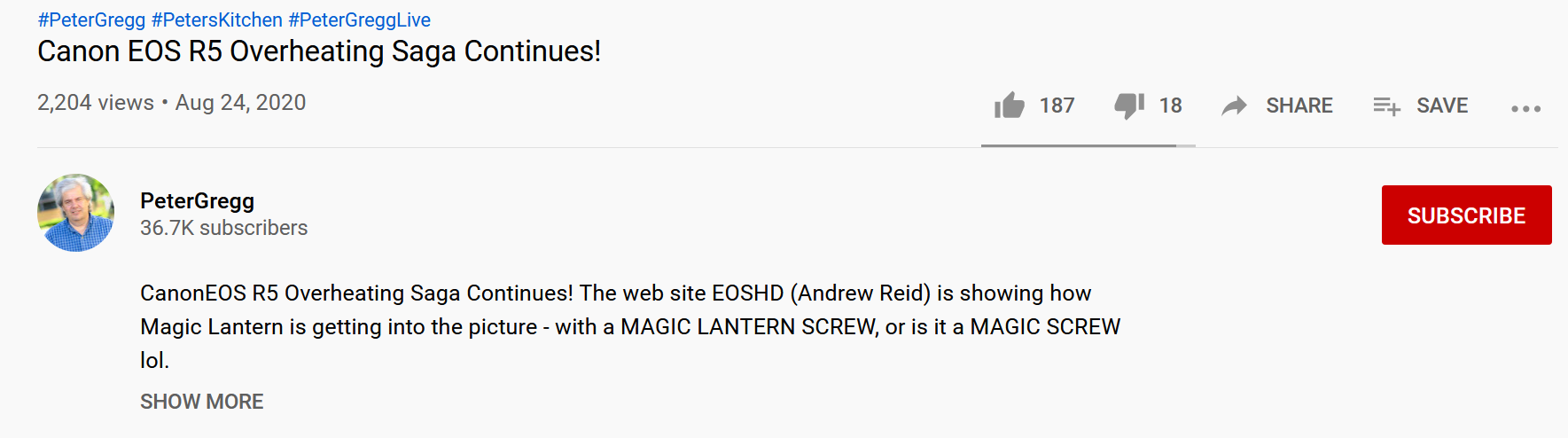

Emanuel Posted August 24, 2020 Share Posted August 24, 2020 You're making history, guys! Don't complain ; ) without Cannot you wouldn't be there... : D (E :- ) Link to comment Share on other sites More sharing options...
Emanuel Posted August 24, 2020 Share Posted August 24, 2020 Link to comment Share on other sites More sharing options...
Administrators Andrew - EOSHD Posted August 24, 2020 Author Administrators Share Posted August 24, 2020 Christmas has come early this year! Ah I remember Peter, nice guy. He did a video on EOSHD C-LOG as well Link to comment Share on other sites More sharing options...

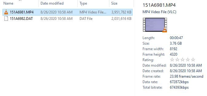

Electroholic Anonymous Posted August 26, 2020 Share Posted August 26, 2020 IT WORKS!!! This is with a Sony 128GB UHS-II card, R5 recording 8K 23.98p IPB in roughly 680Mbps. I will try some other modes next, but I trust this will work in any mode available on SD. Pity that RAW does not work with this neatest of tricks. You guys are geniuses! Link to comment Share on other sites More sharing options...
ajay Posted August 26, 2020 Share Posted August 26, 2020 Congrats! So...This formatting 17 minutes ago, Electroholic Anonymous said: IT WORKS!!! This is with a Sony 128GB UHS-II card, R5 recording 8K 23.98p IPB in roughly 680Mbps. I will try some other modes next, but I trust this will work in any mode available on SD. Pity that RAW does not work with this neatest of tricks. You guys are geniuses! "It" works meaning FAT32 formatting using Linux? Does this only work on SD chips, not CF Express? That's why no 8k raw nor 4k 120p? Please unconfuse me. Link to comment Share on other sites More sharing options...
