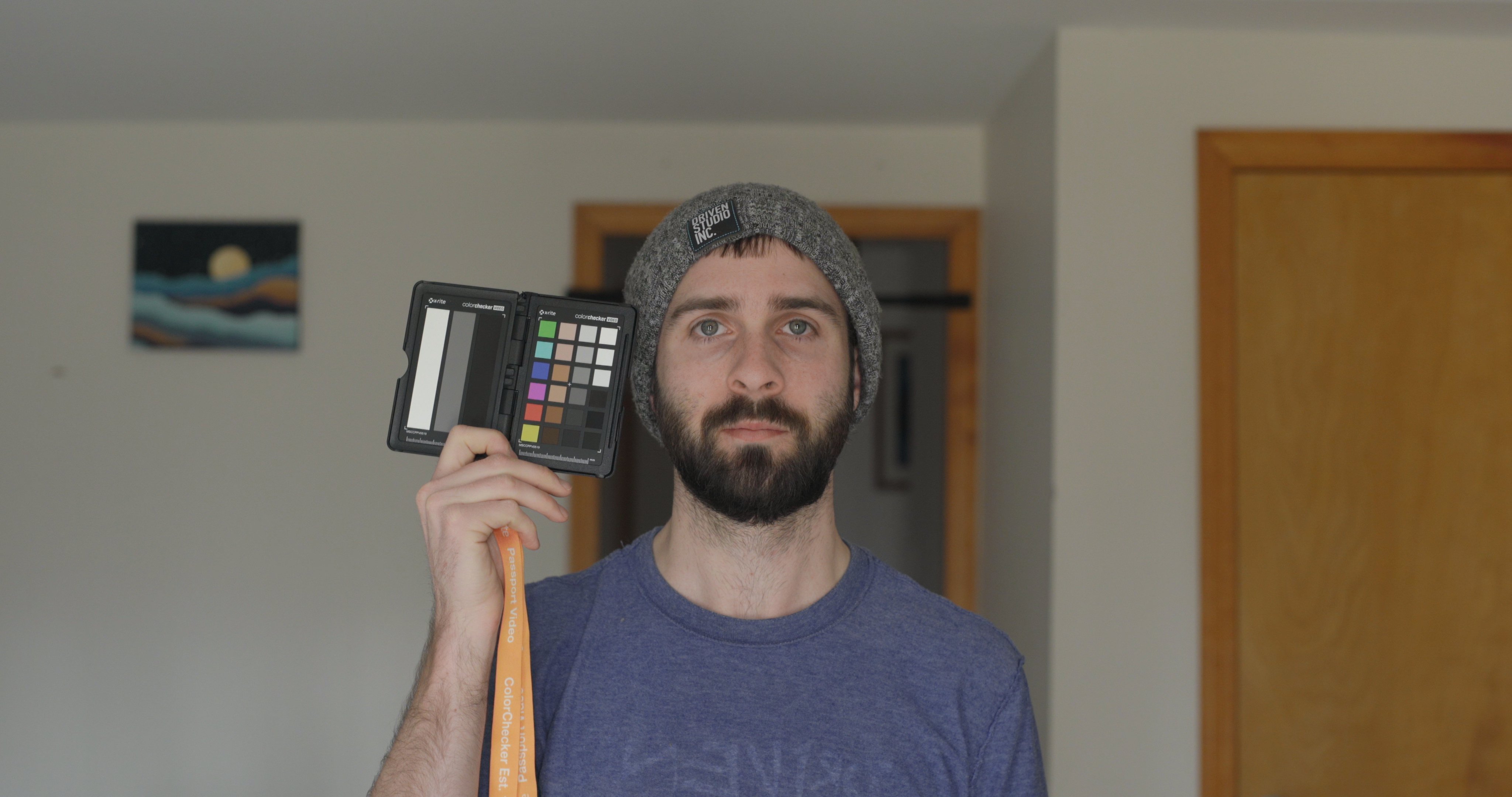

Ki Rin Posted March 21, 2020 Share Posted March 21, 2020 I'm having a bit of trouble color correcting HLG footage from the GH5 in Davinci Resolve. Especially getting skin tones looking natural, and matching other footage. I'm not sure what my project color settings should be... I've tried experimenting by changing input gamma to HLG, which does seem to provide more pleasing color results, but puts the exposure way off. However, changing the input color space isn't really an option for me, since I am also editing footage from the sony a7rii, which does not support HLG. Can anyone give me some advice on how I can get the HLG footage looking more neutral and match it with the sony footage? Link to comment Share on other sites More sharing options...

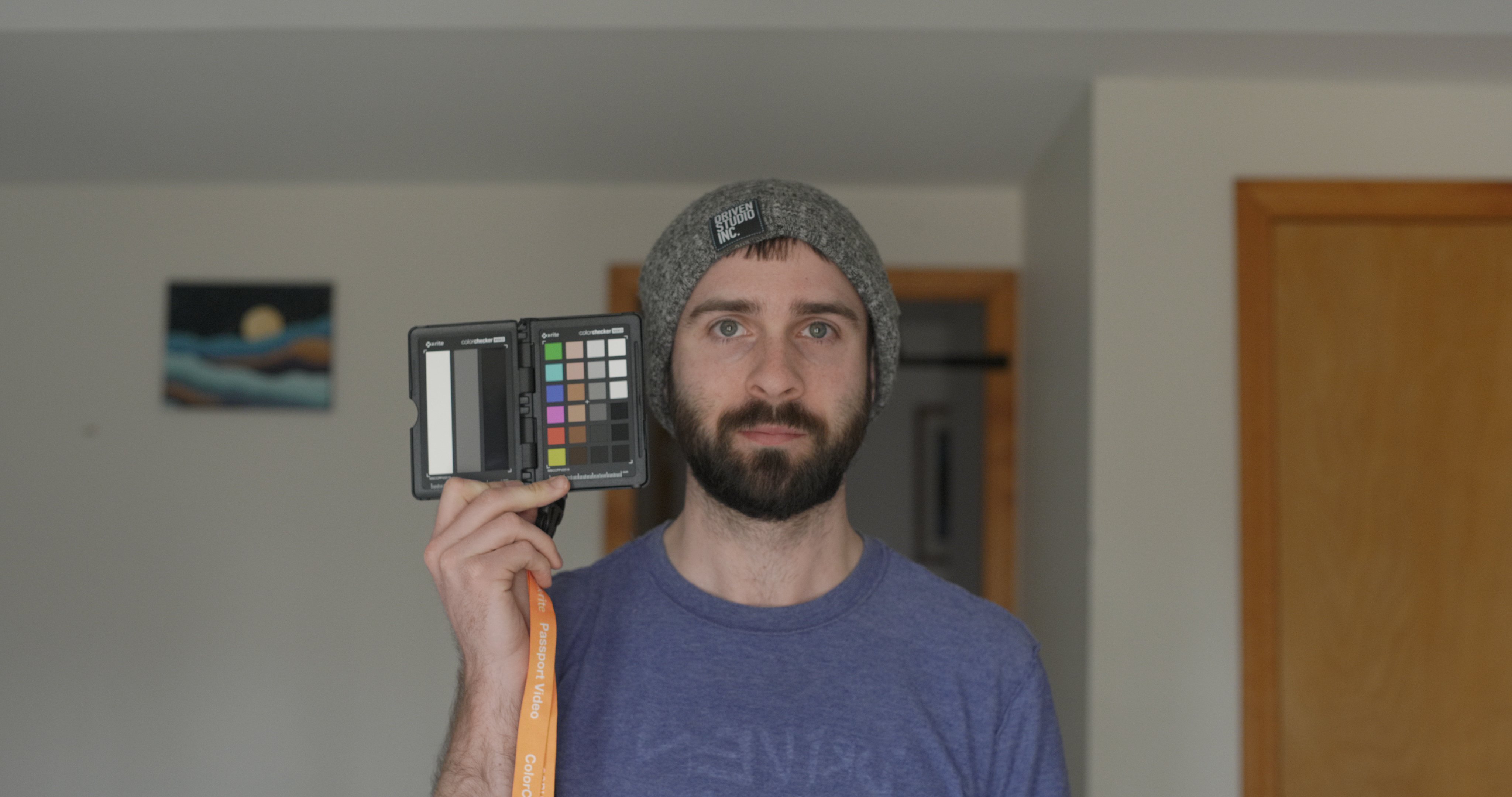

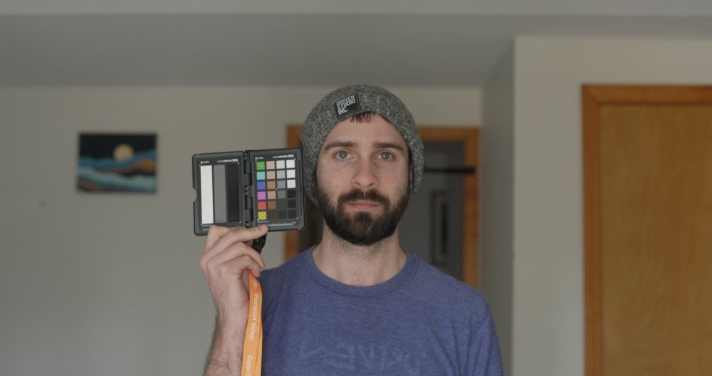

Ki Rin Posted March 22, 2020 Author Share Posted March 22, 2020 On 3/21/2020 at 7:45 PM, Mark Romero 2 said: In the color page of resolve, you can apply a Color Space Transform (commonly called a CST) to a node on a clip-by-clip basis (Instead of to the entire project) So you can apply an HLG to Rec 709 CST to all of the clips you shot on the GH5 in HLG. You can also use an CST to transform any of your Sony clips in to Rec 709. Expand Thank you. That sounds like what I need. I just tried it, but unsure what to choose as the input color space. For the HLG footage I'm guessing rec 2020. I tried it and it does look better for the gh5 footage. For the sony, no idea what I should choose as the input. I'm not shooting s-log, but rather a PP based on cine2 gamma. On 3/21/2020 at 5:45 PM, funkyou86 said: Please upload a framegrab so we try. Expand Thank you, I wll try to up one later On 3/22/2020 at 2:15 AM, buggz said: I am still using the following method, I think I got this information from dvxuser forum: "You can use HLG natively with Resolve for Rec 709 delivery: - In Project Settings, under Color Management, Change to Davinci Color Managed - Under Color Management select: -- Rec 2020 HLG ARIB STD-B67 for Input Color Space -- Rec 2020 HLG ARIB STD-B67 for Timeline Color Space -- Rec 709 HLG ARIB STD-B67 for Output Color Space" Expand Unfortunately, since I am also using a Sony camera and need to match shots, that workflow wont for me. Link to comment Share on other sites More sharing options...
stephen Posted March 22, 2020 Share Posted March 22, 2020 It's a very interesting question. There are 3 methods how to approach the task and those 3 methods are actually different ways to structure your color correcting/grading workflow in Resolve. Color matching two different cameras has 2 steps: 1. Correctly interpret colors in Resolve for each camera. 2. Color match them if there are differences. Hint. If the first step is done correctly you will have very little to no work on the second one. There are plenty of videos on youtube but all they go straight to the second one missing the crucial first step. One or more cameras most people don't know how to do correctly step one. That was my case until recently. Method 1: LUTs and more specifically Leeming LUTs PRO. If you shoot with each camera with the settings given by the author and then apply the corrective LUTs in Resolve for each camera you will get correct colors from both cameras. They should look the same. Panasonic GH5 and Sony A7 series are supported. Tried this on BMPCC 4K and Sony A7 III and it works reasonably well. But not always and setting the cameras each time correctly require some work and attention. https://www.leeminglutpro.com/ Few professional colorists publishing tutorials on youtube advise against LUTs for color correction. Method 2: ACES Used ACES method in the past to work with Sony S-Log 2 video and results were great. Method 3 - Color Space Transform effect in Resolve. This one was game changer for me and the method currently use as a first step for color grading/correction. Including when footage is from different cameras. My productivity in Resolve jumped at least two times and results are great. Wish I new this before ! The best video which explains the method and probably the most important part of color correction in Resolve is unfortunately in Russian. But you still will be able to pick up the principles and settings for both cameras. This guy is a ex professional colorist. Never seen anybody with tutorials on youtube explain the theory and practice so logically and simply. Apart of the color space transform values for input and output color space and gamma, you should also set Tone Mapping to Luminance Mapping. That's very important. Once the color space transform is done on one clip do a stills grab and then apply it on all clips from the camera with few clicks. Same process for the clips of the other camera(s) All 3 methods require to be well aware what picture profile you used during the shoot. For Sony Cameras this colorist advise to use HLG. If you don't have HLG then you should use color profiles or create your own color profiles having Color Mode setting = SGammut. Because it is not clear what color space are Sony PP with Color Mode = Cinema, Pro, Movie. Hope this helps. heart0less, buggz and PannySVHS 3 Link to comment Share on other sites More sharing options...
Ki Rin Posted March 22, 2020 Author Share Posted March 22, 2020 On 3/22/2020 at 9:58 AM, stephen said: It's a very interesting question. There are 3 methods how to approach the task and those 3 methods are actually different ways to structure your color correcting/grading workflow in Resolve. Color matching two different cameras has 2 steps: 1. Correctly interpret colors in Resolve for each camera. 2. Color match them if there are differences. Hint. If the first step is done correctly you will have very little to no work on the second one. There are plenty of videos on youtube but all they go straight to the second one missing the crucial first step. One or more cameras most people don't know how to do correctly step one. That was my case until recently. Method 1: LUTs and more specifically Leeming LUTs PRO. If you shoot with each camera with the settings given by the author and then apply the corrective LUTs in Resolve for each camera you will get correct colors from both cameras. They should look the same. Panasonic GH5 and Sony A7 series are supported. Tried this on BMPCC 4K and Sony A7 III and it works reasonably well. But not always and setting the cameras each time correctly require some work and attention. https://www.leeminglutpro.com/ Few professional colorists publishing tutorials on youtube advise against LUTs for color correction. Method 2: ACES Used ACES method in the past to work with Sony S-Log 2 video and results were great. Method 3 - Color Space Transform effect in Resolve. This one was game changer for me and the method currently use as a first step for color grading/correction. Including when footage is from different cameras. My productivity in Resolve jumped at least two times and results are great. Wish I new this before ! The best video which explains the method and probably the most important part of color correction in Resolve is unfortunately in Russian. But you still will be able to pick up the principles and settings for both cameras. This guy is a ex professional colorist. Never seen anybody with tutorials on youtube explain the theory and practice so logically and simply Apart of the color space transform values for input and output color space and gamma, you should also set Tone Mapping to Luminance Mapping. That's very important. Once the color space transform is done on one clip do a stills grab and then apply it on all clips from the camera with few clicks. Same process for the clips of the other camera(s) All 3 methods require to be well aware what picture profile you used during the shoot. For Sony Cameras this colorist advise to use HLG. If you don't have HLG then you should use color profiles or create your own color profiles having Color Mode setting = SGammut. Because it is not clear what color space are Sony PP with Color Mode = Cinema, Pro, Movie. Hope this helps. Expand Thank you! That was a very informative post! I wish I could watch the video, but I don't understand any russian unfortunately. Method 3 suits me the best, but I'm having trouble finding out what my input should be with my current PP settings on the sony. Its the a7rii so no HLG unfortunately. As you suggest, I should try with the s-gamut setting and see if that gives me a good starting point. I'll try that tomorrow and see how I go. Thanks again. Link to comment Share on other sites More sharing options...
stephen Posted March 22, 2020 Share Posted March 22, 2020 PS. As video shows method 3 is usable only if you shoot with Log profile or RAW. Only is this case Davinci Resolve will know how to interpret correctly the colors. For Panasonic cameras those would be V-Log and HLG and for Sony S-Log2, S-Log3(to avoid) and HLG (best). If your Sony camera doesn't support HLG, then only option would be standard S-Log2/S.Gammut Picture Profile. Or some kind of hybrid profile where Color Mode is S.Gammut and gamma is Cine2 or Cine4. But you'll have to experiment. Have no idea how footage will look and in Resolve there is no value that corresponds to Cine2 or Cine4 gamma. You'll have to try several options for input Gamma. Not sure how this will work. For Panasonic Color Space transform for GH5 with HLG will look like these in Resolve Input Color Space: Rec2020 Input Gamma: Rec.2100 HLG Output Color Space: REC709 Output Gamma: REC709 Tone Mapping : Luminance Mapping For Sony S-Log2 picture profile it would be: Input Color Space: Sony S.Gammut Input Gamma: Sony S-Log2 Output Color Space: REC709 Output Gamma: REC709 Tone Mapping : Luminance Mapping Sometimes I play with output gamma. Can use Gamma 2.2 or Gamma 2.0 instead of REC709. Default for Resolve is Gamma 2.4 If you can use X-Rite Color Chart during the shoots you will be golden. Color matching footage from the 2 cameras will be really easy. buggz 1 Link to comment Share on other sites More sharing options...
Ki Rin Posted March 22, 2020 Author Share Posted March 22, 2020 On 3/22/2020 at 12:25 PM, stephen said: PS. As video shows method 3 is usable only if you shoot with Log profile or RAW. Only is this case Davinci Resolve will know how to interpret correctly the colors. For Panasonic cameras those would be V-Log and HLG and for Sony S-Log2, S-Log3(to avoid) and HLG (best). If your Sony camera doesn't support HLG, then only option would be standard S-Log2/S.Gammut Picture Profile. Or some kind of hybrid profile where Color Mode is S.Gammut and gamma is Cine2 or Cine4. But you'll have to experiment. Have no idea how footage will look and in Resolve there is no value that corresponds to Cine2 or Cine4 gamma. You'll have to try several options for input Gamma. Not sure how this will work. For Panasonic Color Space transform for GH5 with HLG will look like these in Resolve Input Color Space: Rec2020 Input Gamma: Rec.2100 HLG Output Color Space: REC709 Output Gamma: REC709 Tone Mapping : Luminance Mapping For Sony S-Log2 picture profile it would be: Input Color Space: Sony S.Gammut Input Gamma: Sony S-Log2 Output Color Space: REC709 Output Gamma: REC709 Tone Mapping : Luminance Mapping Sometimes I play with output gamma. Can use Gamma 2.2 or Gamma 2.0 instead of REC709. Default for Resolve is Gamma 2.4 If you can use X-Rite Color Chart during the shoots you will be golden. Color matching footage from the 2 cameras will be really easy. Expand Yes, I've been debating the color chart, but it seems very expensive for what it is. Anyway, I will try your suggestions first and see how it goes. Link to comment Share on other sites More sharing options...
