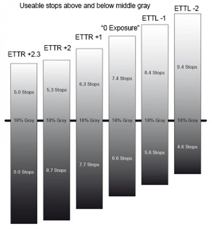

EthanAlexander Posted October 7, 2019 Share Posted October 7, 2019 There seems to be some confusion about what's happening with ETTR so hopefully this clears it up. 2 things that will never change no matter how you're exposing V Log are the "shape" of the curve and the dynamic range (For this post we will assume 14 stops). V Log will always be V Log will always be V Log. So, technically, the highlight rolloff will always be the same. @Jonathan Bergqvist and @Mmmbeats are right in this regard. BUT - the useable part of the dynamic range (of the scene) is definitely shifting and it is definitely destructive, as @helium is pointing out. Once you lose something to overexposure, you'll never get it back. If a scene only has, for instance, 7 stops of dynamic range, then you could easily argue that ETTR will offer a better image because of the high SNR which will lead to low noise and a cleaner image. We're fitting 7 stops into.a 14 stop container so it's easy to make sure everything is captured. You could probably argue that when shooting raw or super low compression, anything less than the full dynamic range should be ETTR by the amount of stops in the scene fewer than the maximum allowed by the log curve. The complication comes in when dealing with scenes with high dynamic range. This is when you have to decide what to put into the 14 stop "container." When using ETTR, you're making a compromise - higher SNR for less useable dynamic range in the highlights. This is definitely a "destructive" choice in the sense that this can't be undone in post. You'll never get back those stops in the highlights that you chose to sacrifice. For many people and scenes, this is an acceptable tradeoff. You're also getting more stops dedicated to your shadows, which can be useful. If your scene has a lot of stops above middle grey, then ETTR will definitely limit the amount of useable recorded dynamic range, and exposing according to "manufacturer guidelines" (or even lower) will indeed give you the better result if you're trying not to lose anything to overexposure. This image shows how the captured range of 14 stops never changes but the amount of stops above and below middle grey definitely do change. I think it is for the Alexa but the concept applies to literally any curve, so just ignore the exact numbers of stops above and below 18% and look at how it always adds up to 14. These changes are 100% baked in no matter how you record (raw or highly compressed). There can be color shifts as well, but that's a totally different topic to dive into... Link to comment Share on other sites More sharing options...
Otago Posted October 7, 2019 Share Posted October 7, 2019 7 minutes ago, EthanAlexander said: If a scene only has, for instance, 7 stops of dynamic range, then you could easily argue that ETTR will offer a better image because of the high SNR which will lead to low noise and a cleaner image. We're fitting 7 stops into.a 14 stop container so it's easy to make sure everything is captured. You could probably argue that when shooting raw or super low compression, anything less than the full dynamic range should be ETTR by the amount of stops in the scene fewer than the maximum allowed by the log curve. I think this is true if it is a linear 14 bit file but not if it is log 10 bit ( assuming each bit corresponds to an extra stop of dynamic range ) If you ETTR and put lots of information in the curve of the log then in the brightest values they will be sharing bits. Depending on what curve your camera uses you could end up with, say, your 2 brightest stops being compressed into one bit in the codec and so only have 512 values representing each stop rather than 1024 - whether that is noticeable is another question! If you exposure "correctly" then most of the values will fall in the linear part of the log curve and you'll get all 1024 values for each stop. I think log curves are used because it is assumed that the very brightest and darkest information will be lower in information and importance, and work similarly to film so it was easier to switch over. Link to comment Share on other sites More sharing options...
Otago Posted October 7, 2019 Share Posted October 7, 2019 1 hour ago, Otago said: I think this is true if it is a linear 14 bit file but not if it is log 10 bit ( assuming each bit corresponds to an extra stop of dynamic range ) If you ETTR and put lots of information in the curve of the log then in the brightest values they will be sharing bits. Depending on what curve your camera uses you could end up with, say, your 2 brightest stops being compressed into one bit in the codec and so only have 512 values representing each stop rather than 1024 - whether that is noticeable is another question! If you exposure "correctly" then most of the values will fall in the linear part of the log curve and you'll get all 1024 values for each stop. I think log curves are used because it is assumed that the very brightest and darkest information will be lower in information and importance, and work similarly to film so it was easier to switch over. Just realised some of this is incorrect. There are only 1024 values for the whole dynamic range, rather than each stop so the numbers about should be 50 values representing each stop rather than 100 - the concept is the same but the values are / were wrong. Link to comment Share on other sites More sharing options...
EthanAlexander Posted October 7, 2019 Share Posted October 7, 2019 1 hour ago, Otago said: I think this is true if it is a linear 14 bit file but not if it is log 10 bit ( assuming each bit corresponds to an extra stop of dynamic range ) There are only 1024 values for the whole dynamic range, rather than each stop so the numbers about should be 50 values representing each stop rather than 100 - the concept is the same but the values are / were wrong. I appreciate your desire to dig into this further. In any linear recording, each stop brighter is actually getting twice as many bit values as the previous darker stop, starting with 1 for the darkest and 512 for the brightest in 10 bit. That means the brightest stop is actually the "top half" of all the bit values (so in 10 bit 513-1024 would actually be reserved for just one stop of light.) If you want each stop of light to be represented by an equal amount of values (for instance, ~100 as you are suggesting) It requires a log curve to map the input values to that. (How many and which values get used for the different stops is what makes the differences between different log curves like SLog2 and 3, V Log, N Log, etc.) 2 hours ago, Otago said: If you ETTR and put lots of information in the curve of the log then in the brightest values they will be sharing bits. Depending on what curve your camera uses you could end up with, say, your 2 brightest stops being compressed into one bit in the codec and so only have 512 values representing each stop rather than 1024 - whether that is noticeable is another question! They won't be sharing bits before compression whether it's linear or log, but to your point, you're right and this is a big reason why shooting log on a high compression camera is troublesome - the codec has to throw away information and that means that values that are close together will likely be compressed into one. This is why I said several times that highly compressed vs raw recording is a big factor. But if we're talking raw recording with lossless or no compression, or even ProRes HQ frankly, then a 10 or 12 bit file mapped with a log curve will look practically the same as a linear 14 bit recording. Either way you still have to decide where you want middle grey to land, which means you're deciding how many stops above and below you're going to get. Link to comment Share on other sites More sharing options...
Otago Posted October 7, 2019 Share Posted October 7, 2019 52 minutes ago, EthanAlexander said: I appreciate your desire to dig into this further. In any linear recording, each stop brighter is actually getting twice as many bit values as the previous darker stop, starting with 1 for the darkest and 512 for the brightest in 10 bit. That means the brightest stop is actually the "top half" of all the bit values (so in 10 bit 513-1024 would actually be reserved for just one stop of light.) If you want each stop of light to be represented by an equal amount of values (for instance, ~100 as you are suggesting) It requires a log curve to map the input values to that. (How many and which values get used for the different stops is what makes the differences between different log curves like SLog2 and 3, V Log, N Log, etc.) They won't be sharing bits before compression whether it's linear or log, but to your point, you're right and this is a big reason why shooting log on a high compression camera is troublesome - the codec has to throw away information and that means that values that are close together will likely be compressed into one. This is why I said several times that highly compressed vs raw recording is a big factor. But if we're talking raw recording with lossless or no compression, or even ProRes HQ frankly, then a 10 or 12 bit file mapped with a log curve will look practically the same as a linear 14 bit recording. Either way you still have to decide where you want middle grey to land, which means you're deciding how many stops above and below you're going to get. Ah, I have misunderstood the terms then! I assumed by linear it was meant that the total values had been remapped to make better use of the graduations rather than the absolute light levels - but that is what log is - I assumed that this was done on all sensor ADC's as a matter of course ( the data coming off was log) and then a further log conversion was done to fit that in a 10-bit container while prioritising mid tones but I suppose it's not necessary if the sensor bit depth is close to the final bit depth, I forgot this wasn't a 24 bit instrumentation ADC where you have loads of data to throw away. Thanks! Link to comment Share on other sites More sharing options...
